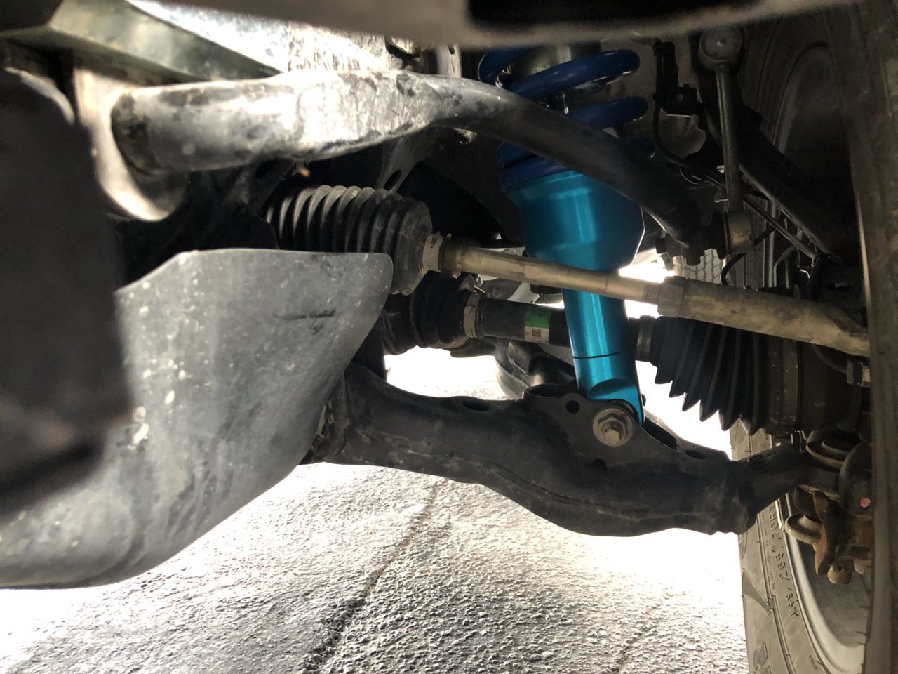

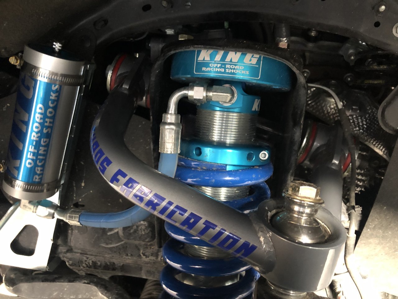

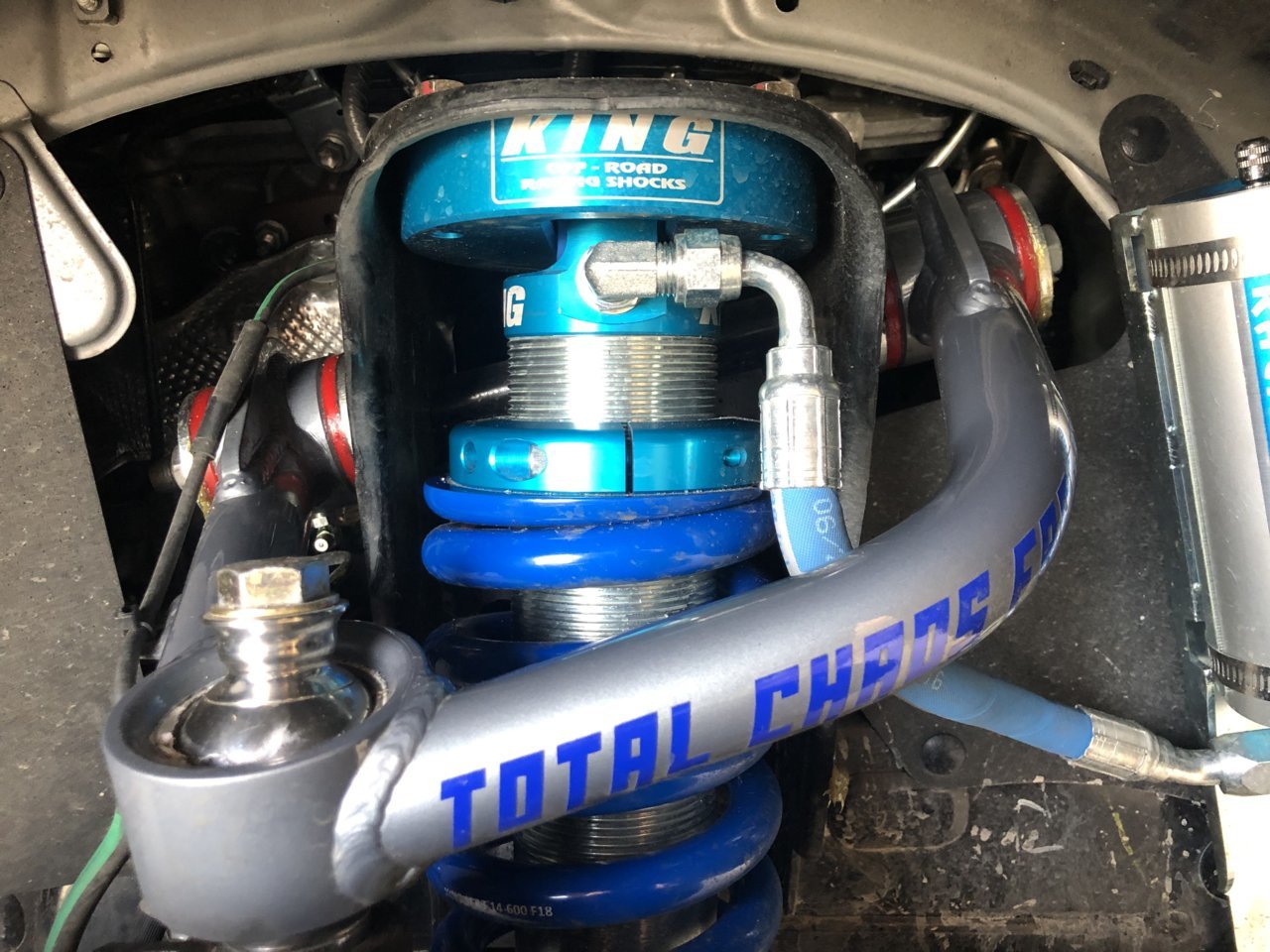

    Here is a pic of my setup. Does this look like too much preload? Angles look good? It drives perfect. Only small vibration from 20-25mph and it does not go away on 4x4 but it doesn’t bother me much. I do have a carrier bearing spacer thing installed. Might take it off see if it helps but I doubt it since it’s vibrating up front if that makes a difference. I’m doing this on mobile. Hope it uploaded okay. 1st pic is driver side, 2nd is passenger and 3rd is driver side angles.

    Looks good to me.

    Looks just like mine. Angles. And mine too has a vibration around that speed, not sure on 4WD, as I haven’t activated it on pavement
