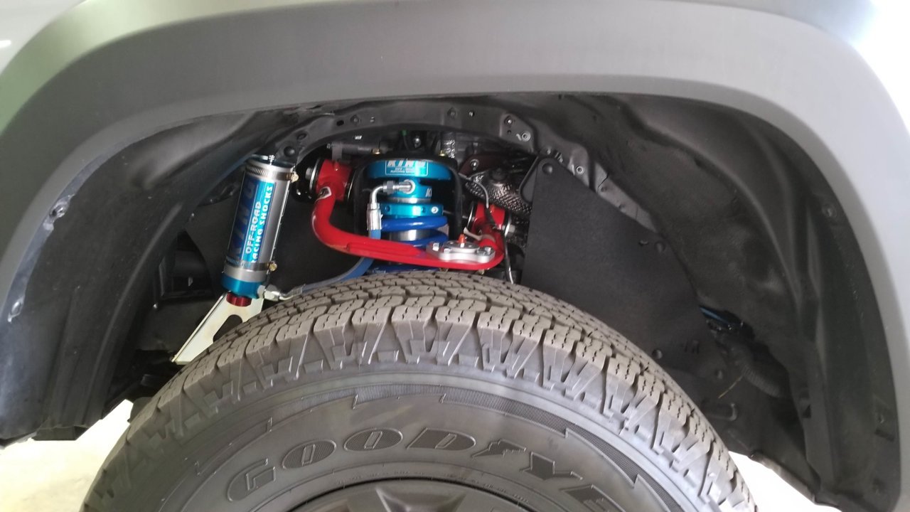

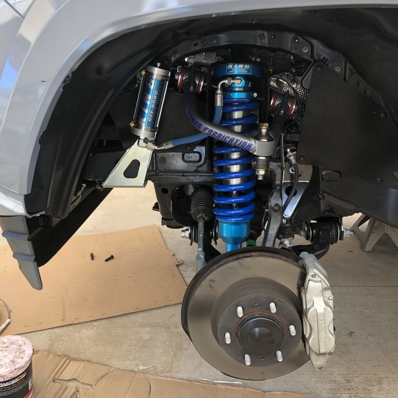

    Got my fronts installed today #650 springs with Total Chaos UCA's and ECGS bushing. Thanks to Micah @Downsouth Motorsports for the parts and Jason @Speed Freek for the labor. If anyone is considering having a lift installed by someone extremely knowledgeable and doesn't mind driving to Vista, CA Jason is the man to see.4F3C4EED-7246-432E-A132-D9F75D8A88D3.jpg82514703-AF98-4AB5-8565-80C8E76290D0.jpg

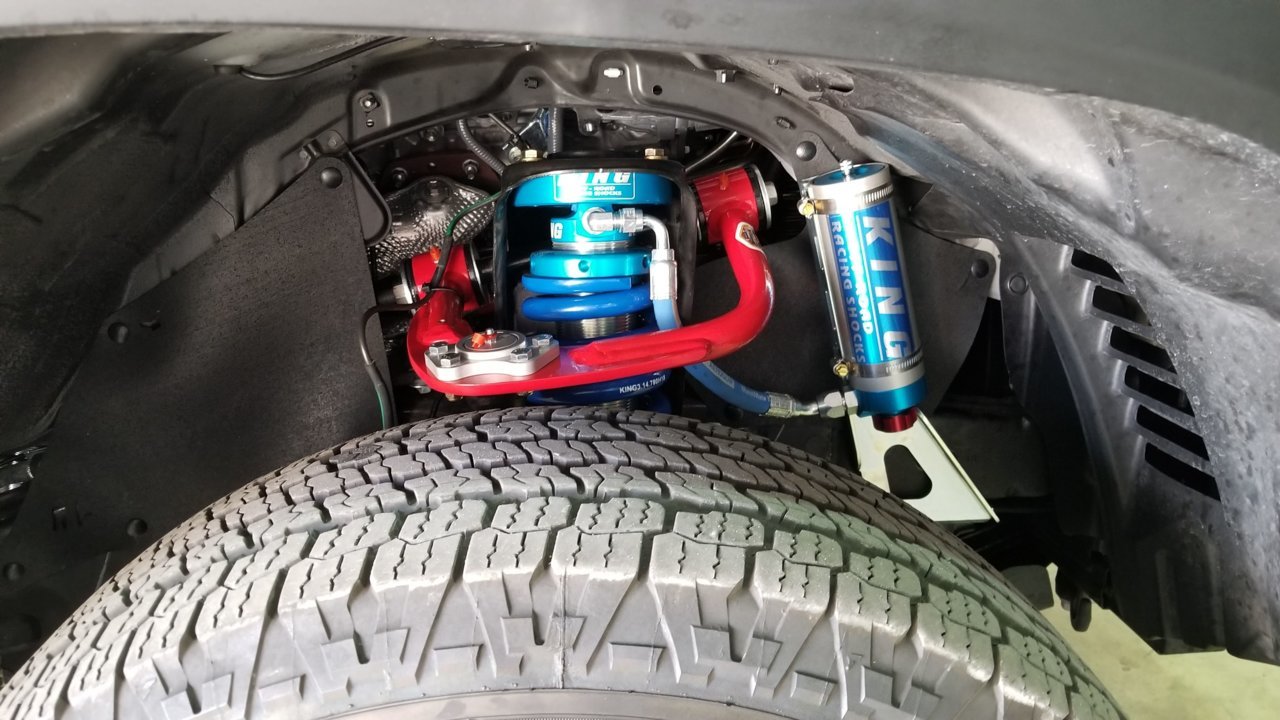

    So I installed fronts with 2-3 threads (from King) and gained 3" lift with the 700# springs. Is this normal? Running full skids and sliders. Still need to install rears and get aligned. The UCAs are a pain to remove and install.IMG_20190125_151137.jpg
    Anyone also have the resivoir hose touching UCA on passenger side on droop?

    Chad

    Damn. I tried turning the resivoir so it doesn't which worked on the driver side but not on the passenger side. I wanna loosen an reposition that top fitting but I don't know if it'll release fluid or air. I'll probably just leave it alone for now.

    It’s a common thing for it to rub on boxed UCAs. Some brands just doesn’t clear enough. Some people reinforce the hose with additional tape to reduce wear. Luckily I dodged that with the Icons
