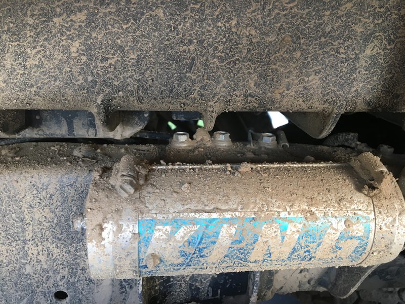

    Is the rear resi bracket bolt-on or do you need to drill holes in the frame? I know ICON requires you to drill a hole in the frame to bolt the resi bracket.

    It fits in to the brake line area. No drilling required. I'll try and snap you a pic soon, but everything is covered in mud at the moment so idk how helpful it'll be

    Sorry forgot to take a pic yesterday. Here you go
    This is the drivers side bracket. You take the bolts out where the brake lines are in, lift up and put this in. Same for the passenger side minus the brake lines. Easy stuff.
