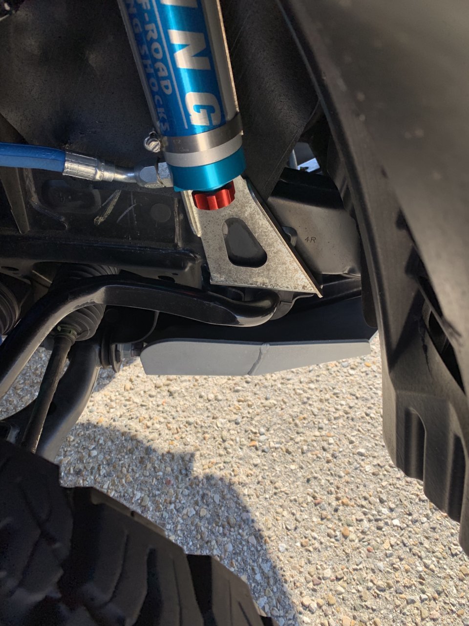

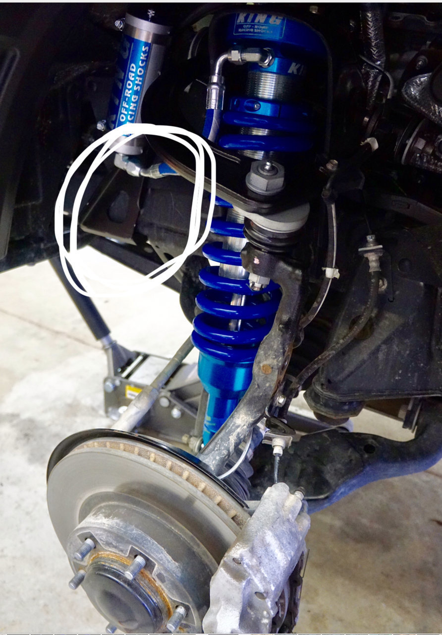

    Any idea on how to clean the bracket? Thinking about powder coating these black or purchasing a new set.

    I would powder coat

    Sand them, wipe them down, spray etching primer then powder coat.

    I just sanded them down good, and hit em with rattle can self etching primer, then whatever Black was in the shop. But if you got powder coating cash, go for it!E173E4B8-D9CE-4A67-A1D8-D3A0EAF080A9.jpg

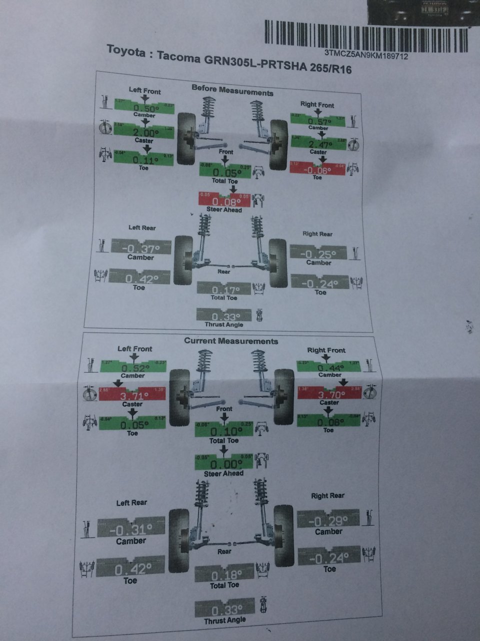

    Yep that's a great alignment. Damn near perfect.

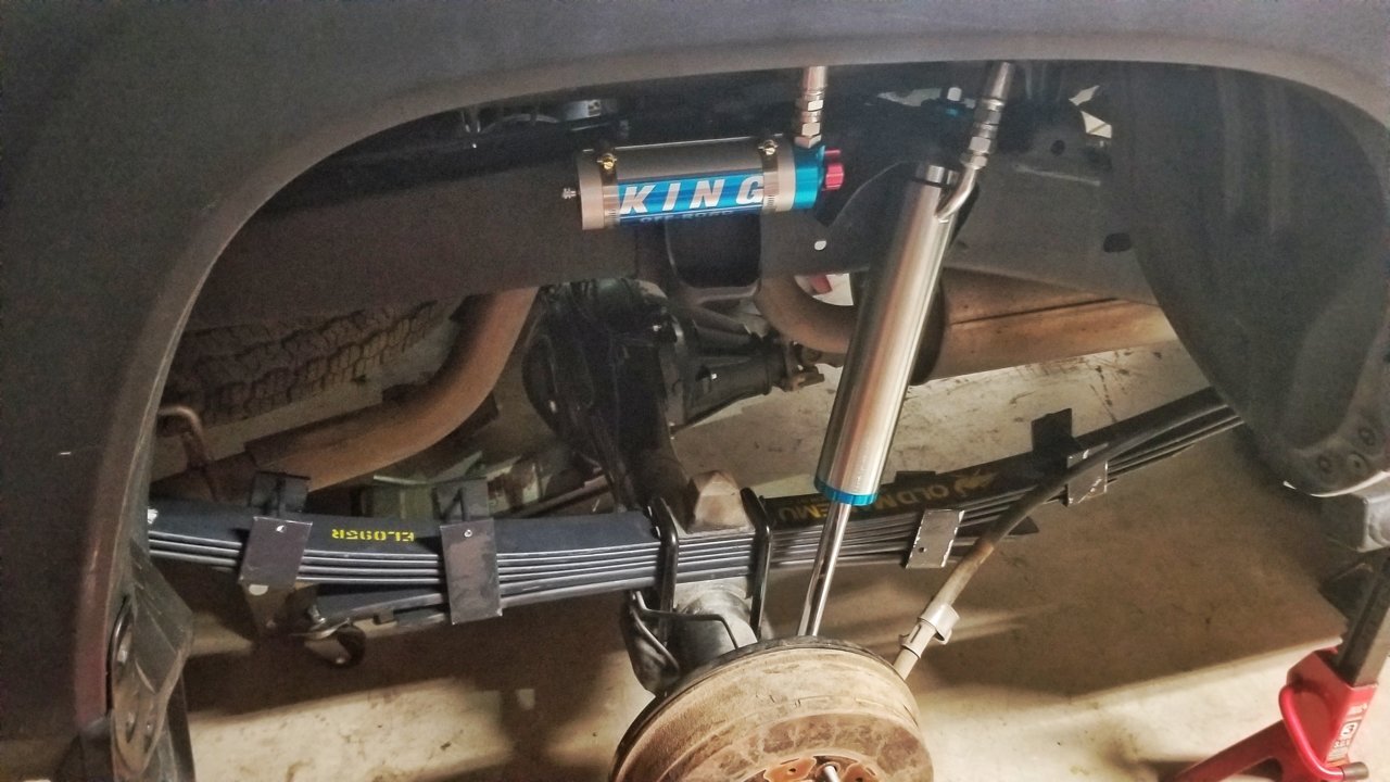

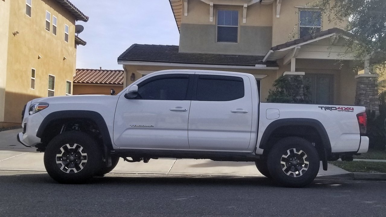

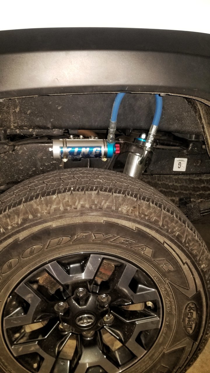

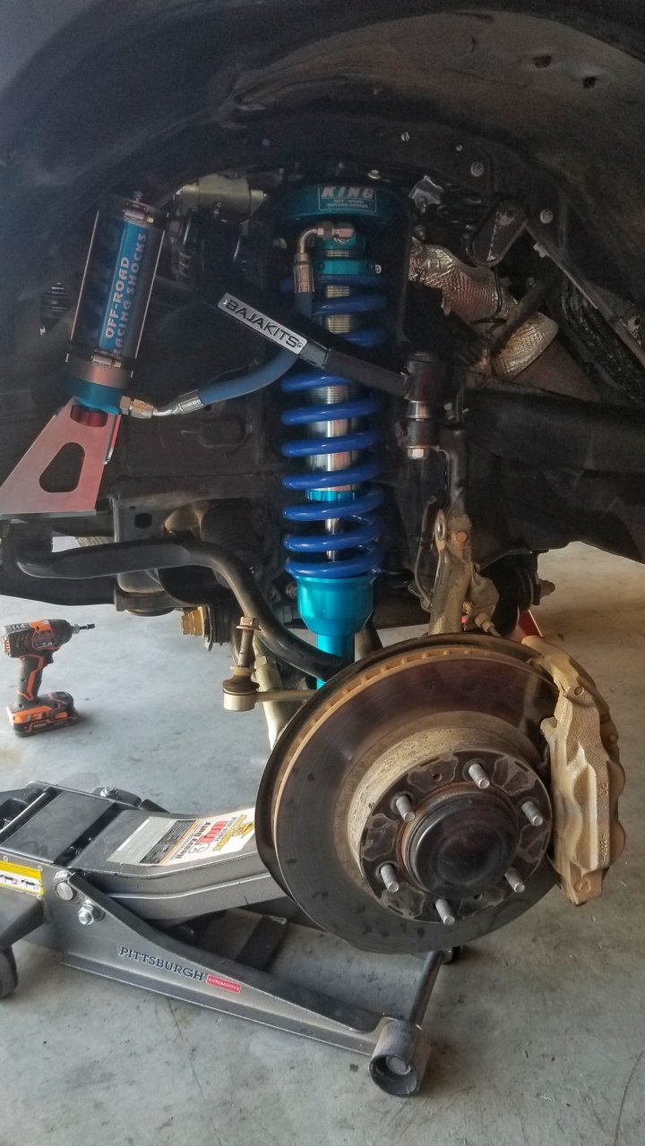

    Finally installed everything yesterday.
    FRONT: King 2.5 EXT RR w/adj (650 coils)+ Baja Kits UCA
    REAR: King 2.5 RR w/adj (Dakar) + OME Medium Duty
    Truck: 2018 DCSB 4x4. Stock wheels and tires (265/70 R16). No significant weight added, except for the sliders.
    Installation was pretty straight forward after reading all of your tips, watching a couple videos, and my buddy having the same setup on a 2nd gen.
    After doing my calculations I ended up with 2.17" of lift in the front and 2.36" in the rear (Measuring from the wheel hub to the bottom of the fender).
    First pic is with the front lift only. Second pic is full lift.
    Thanks guys.
