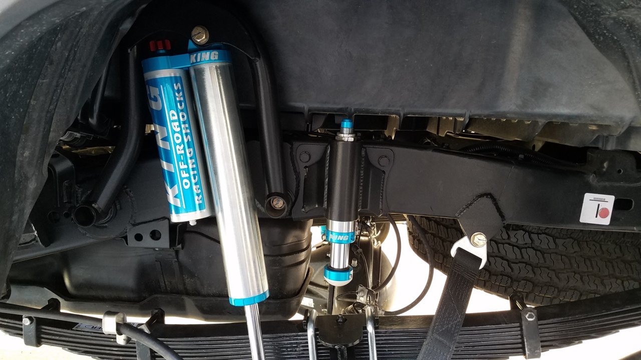

    I have a full King setup in the rear, Total Chaos shock relocation brackets, custom Deaver springs and King Bump stops.

    I have the King piggyback’s. Don’t recall the exact part number. They use the Total Chaos Shock relocates.
    I have an RTT, full skids, sliders and stell plated bumpers, spare tire and two 5 gallon gas cans. When I’m loaded, the back squats a bit. I’m probably going to upgrade to the III’s.

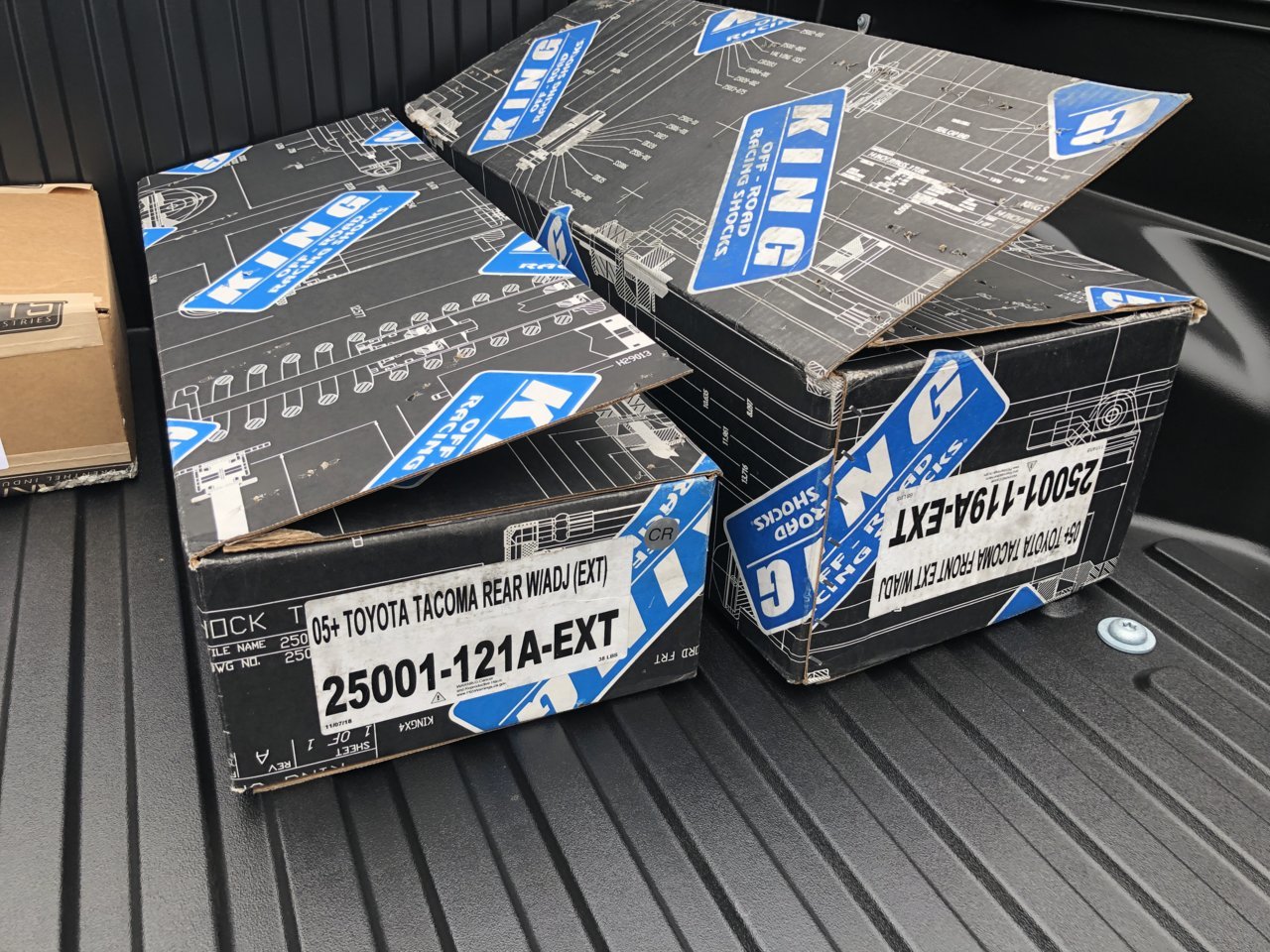

    Ok, so I have a question. I have read this whole thread and thought I had my answer, but then kept reading and then realized that I dont have my answer because someone had a different answer a few posts later. So here is my question:
    I have a 2016 Tacoma with Dakar EL096R leaf packs and the EL46XL AAL in the rear paired with Bilstein 5100 extended shocks. This is my daily driver so most of the time I have no load, but when I go camping, I have a RTT and load the bed up. I have recently acquired a brand new set of King OEM Performance Series Rear Shocks #25001-121. Will these work? There is some confusion for me as I cant clearly tell if the extended version of these shocks only have a longer rod end or if the shaft is actually longer also. Will I need to get bump stops? Do I need to find a wall to bang my head against? I am actually surprised that I haven't found anyone with this exact set up on their truck for me to ask questions to. This is a great thread with lots of great information, I have learned a lot over the past couple of days as I have been reading it. Any help would be much appreciated.

    @xxmagpulxx I went with Extended rear set, initially when I made my order it was for the standard set, however when I called Downsouth Motorsports to confirm my order, they asked about my rear lift, when I told them Inwas going with the EL096R, they told me what I wanted to get was the Extended King Rear Set. Can’t remember the details on it, but you can give them a call, pretty sure they can help you out.

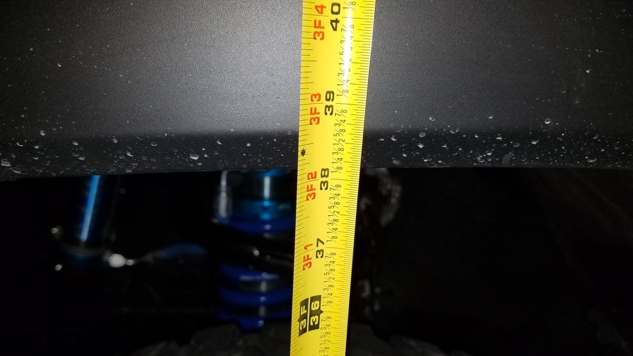

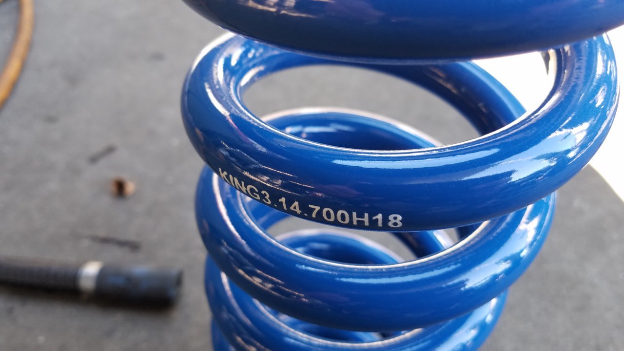

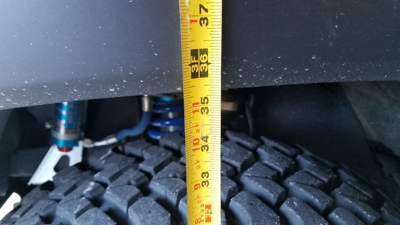

    You gained around 3” from swapping 600-700 king coils?

    The first set I threw on right out of the box and never adjusted the height at all........
