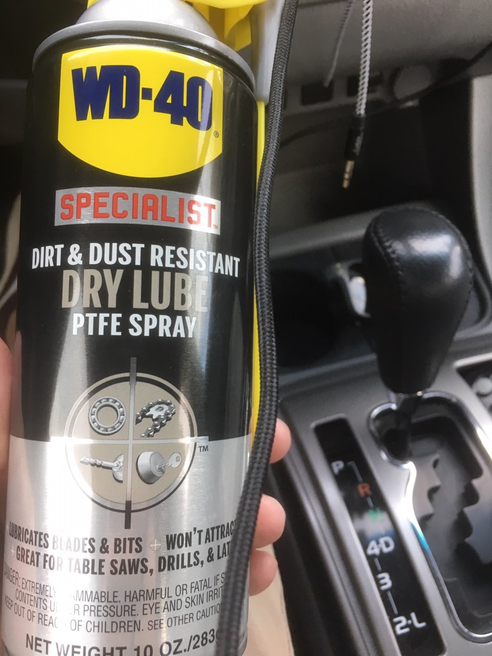

    What kind of grease should we use?
    What kind of grease gun is recommended?

    Funny you should ask-just sent this pic to some friends. Never realized WD-40 made this. 2 cans for $10 at AutoZone last week. Going to give this a try for the uniballs and heims. I use Superlube for the polys on the LCA (I have a +2 LT set up) using a trigger style grease gun

    Thanks for the info and the picture.

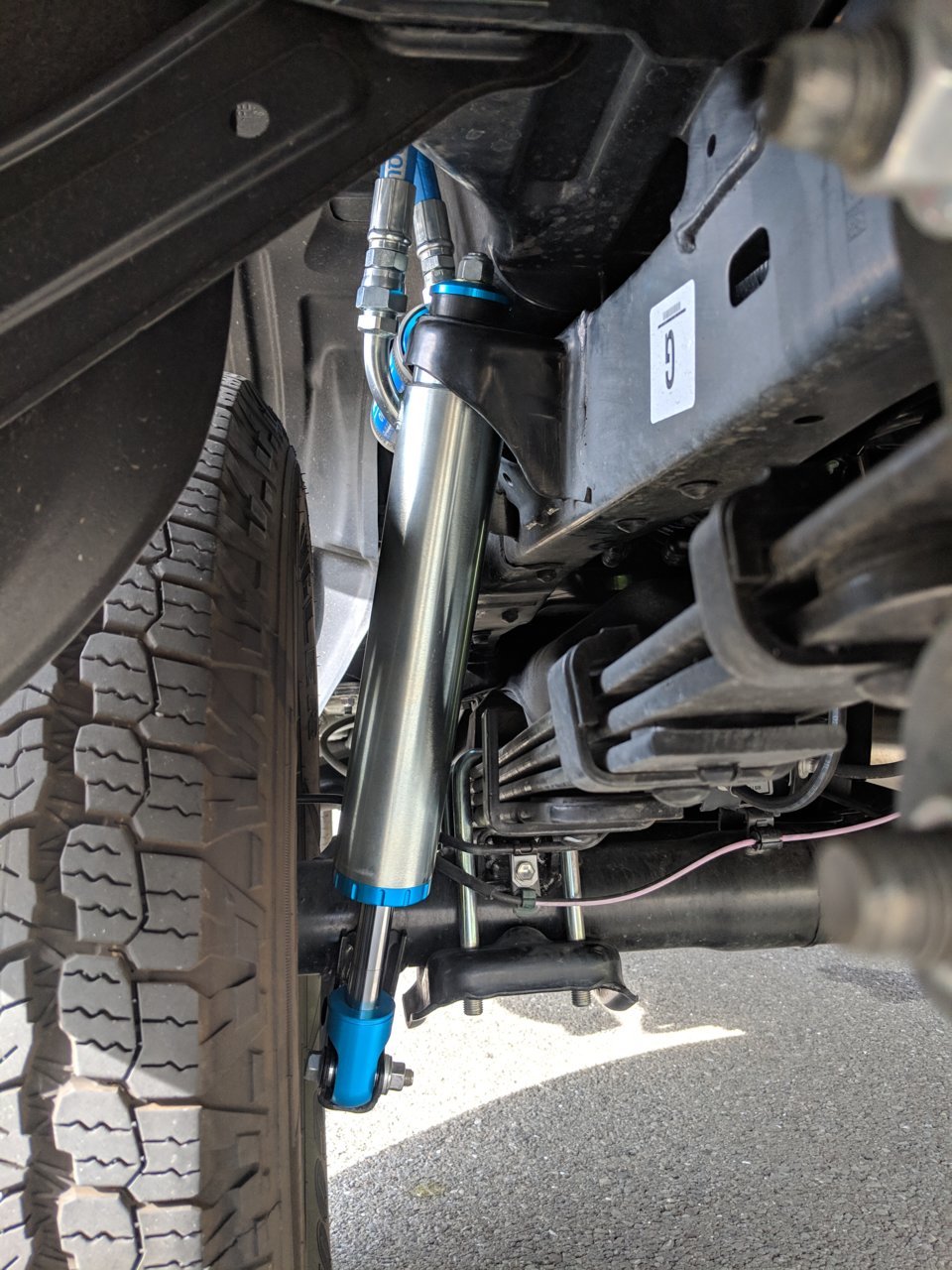

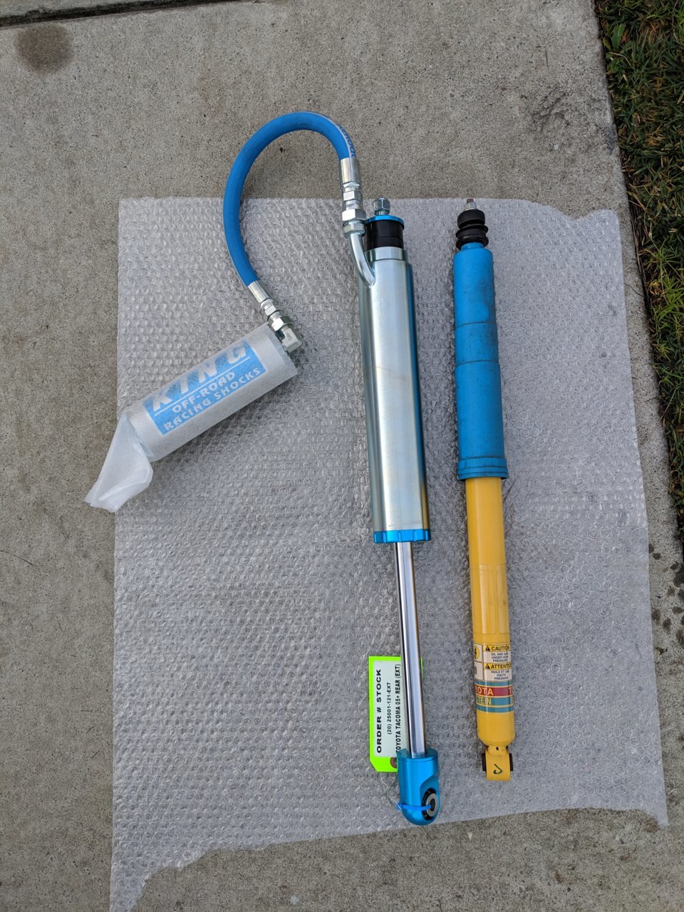

    Does anyone else's rear shocks look this long?
    I'm currently on stock leafs and wondering if it's normal for this little chrome showing.

    Just make sure your rear bumps can accommodate the ( Ext ) longer shock from bottoming out with stock leaf set up

    Is anything needed on the rear if I want to run the ext with my stock rear leafs? Would I receive any lift just from the ext rear shock?

    That’s where mine were too and I had extended on stock leafs. You can see the line of dirt on the shaft after time and see where it is at during full compression and it was way too close for my comfort especially running stock bumps. So that’s why I decided to lift the rear a little and it’s all good now.

    No shocks won’t lift your truck. You technically don’t need anything else but like the statement above ^, it was a little too close for me so I decided to lift it.

    I figured. Thought I'd ask as there's no way the stock bumps would stop from bottoming out. I'm gonna throw on a mini pack this weekend (1.5" lift). Should be enough?

    Just depends. Test them. Either watch the dust line on them or put a zip tie on the shaft. Watch where the zip tie stays after compression to determine how much longer your bumps need to be.
