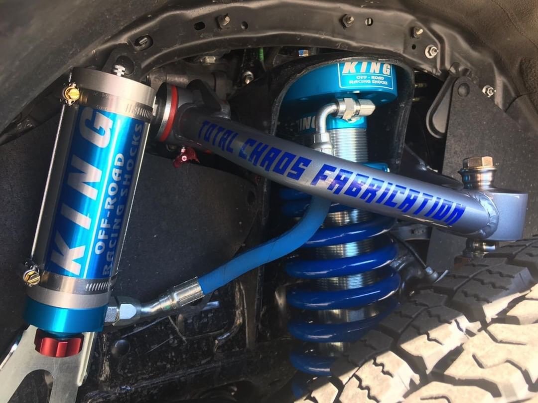

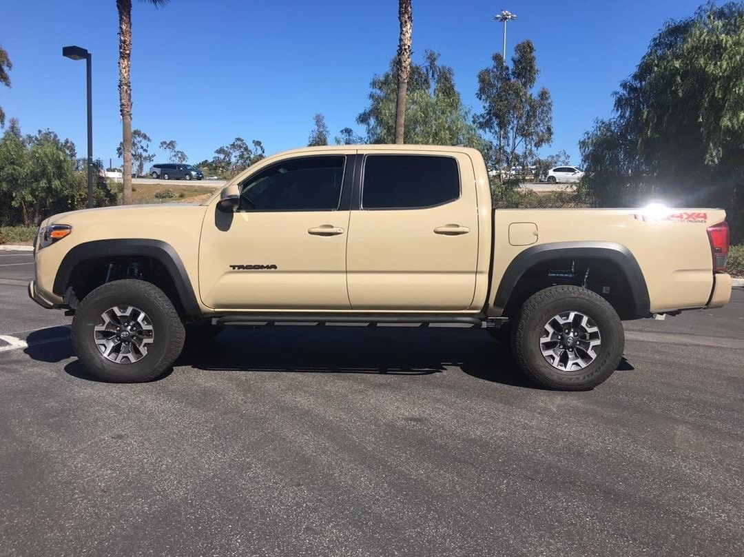

    Ray10's and tires going on tomorrow

    Are you doing stock travel Kings?
