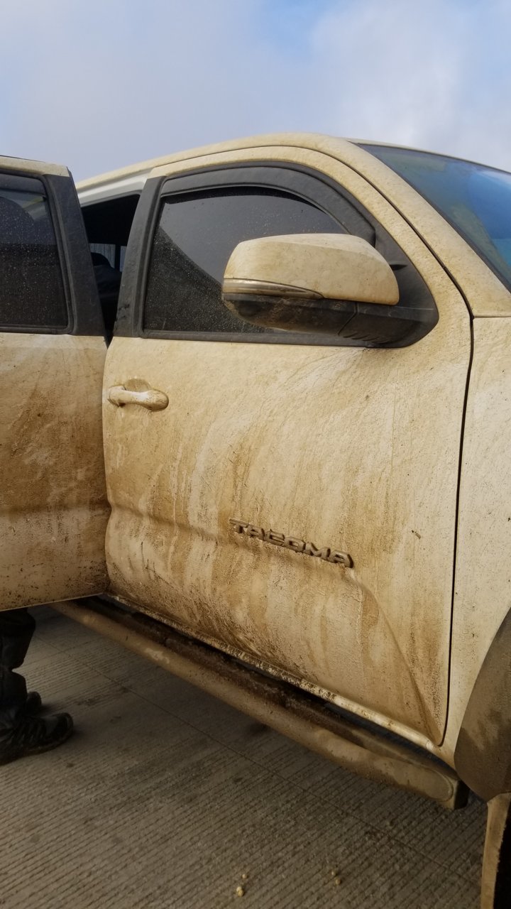

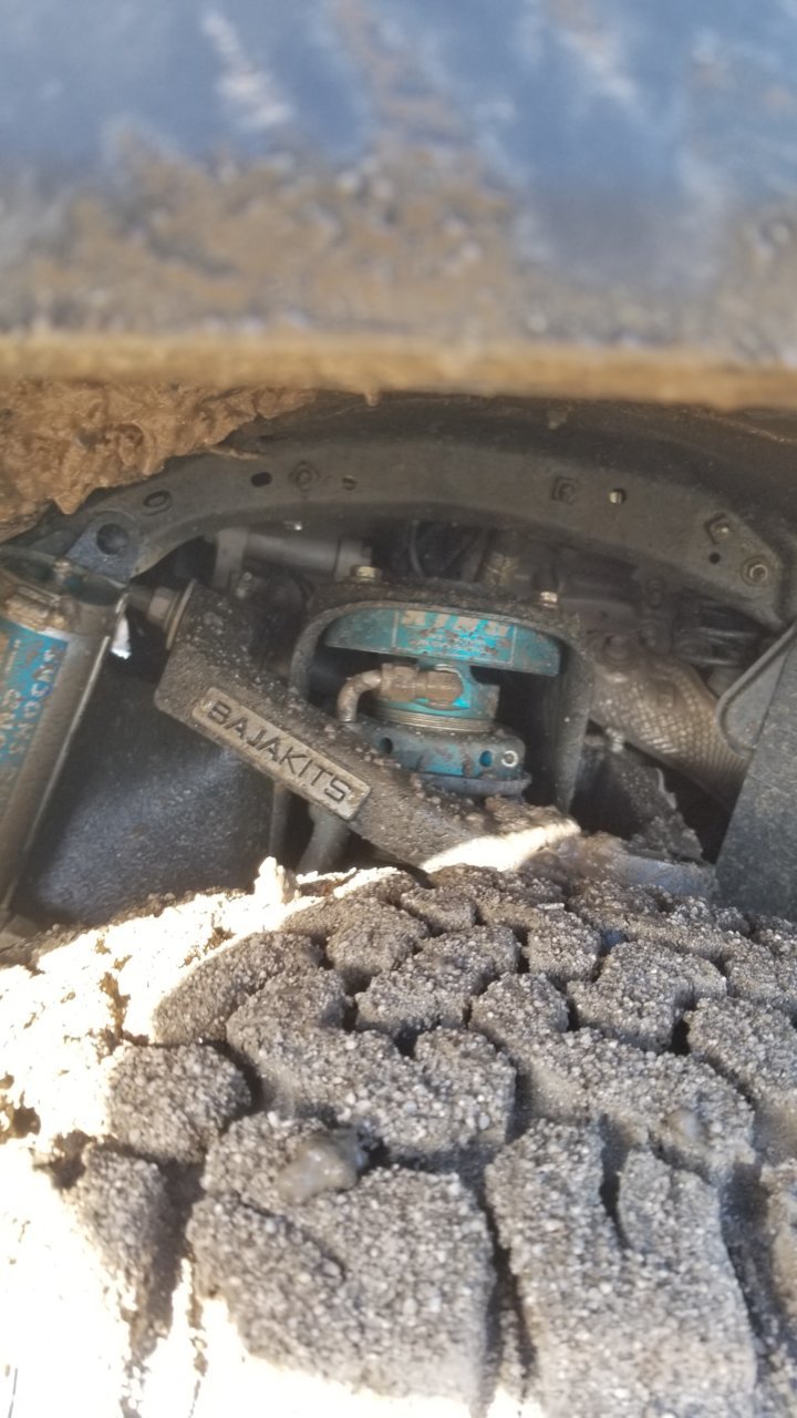

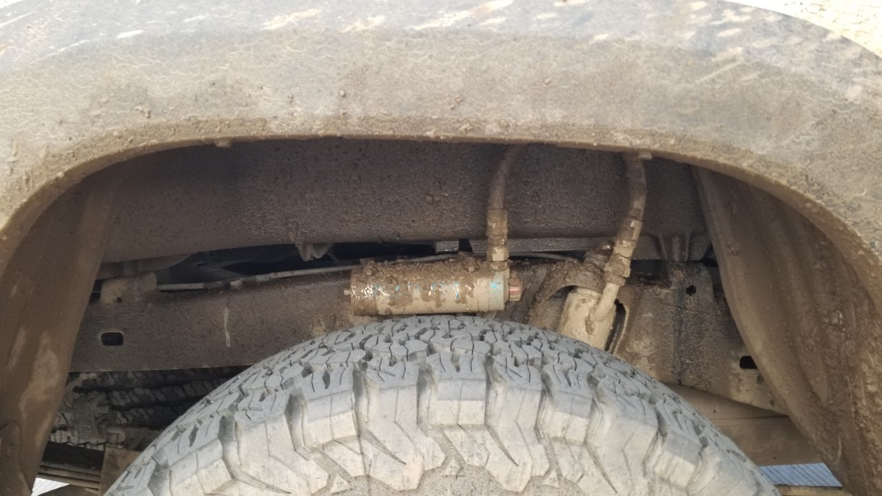

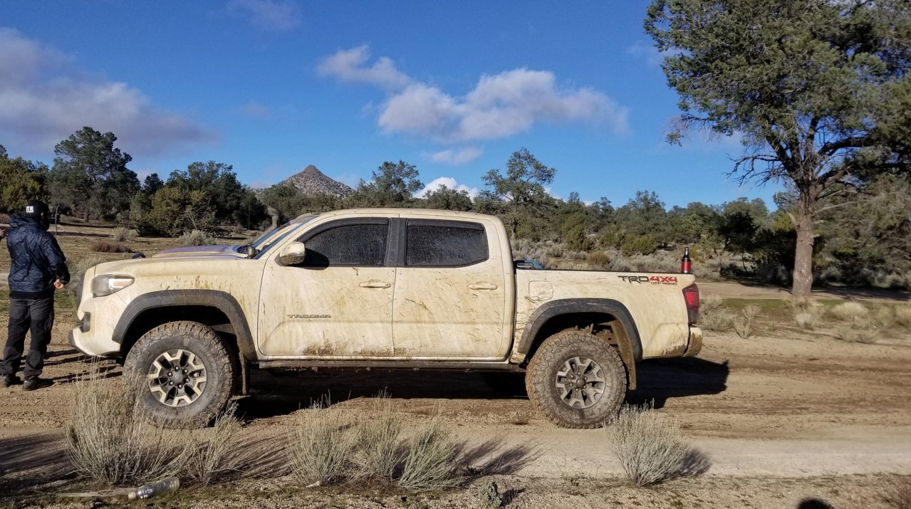

    jcmotr
    jcmotr Well-Known Member
    Dec 20, 2017
    #239018
    118
    Here's mine with fresh 285/75 R16 KO2s. I installed them last friday, a bit over a month after my King setup. I love it.
    Coilovers are set at the initial height, I haven't adjusted them. OME MD in the rear.
    Stock wheels, no spacers, no trimming, no CMC. Honestly... no major rubbing while driving "normally". I will eventually do all that stuff, but I really wanted to go off roading this weekend... trial by fire.
    It does rub in full lock and hitting a hard bump, but otherwise I was completely fine in this trip.20190302_161722.jpg 20190302_163658.jpg 20190302_163705.jpg 20190302_150546.jpg 20190302_150546.jpg

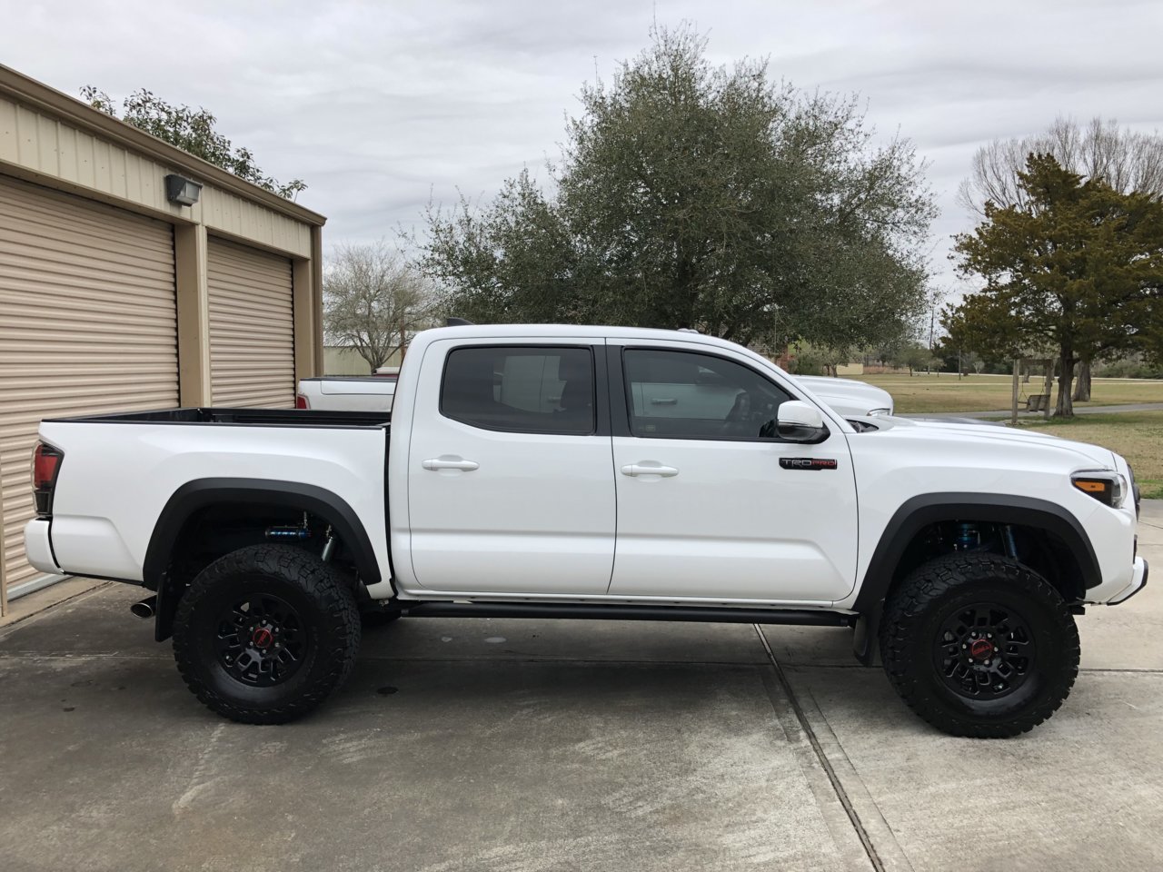

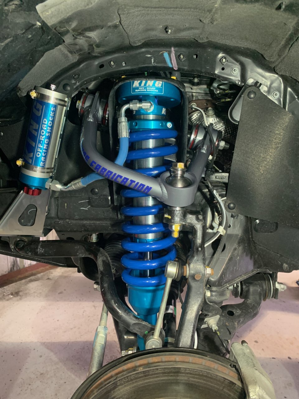

    Blucuss
    Blucuss Well-Known Member
    Oct 4, 2014
    #139637
    173
    Texas
    2018 Super White Tacoma TRD OR
    • RAVELCO ANTI THEFT DEVICE with Three Plugs • 285/75/16 BFG KO2s on Stock TRD PRO Wheels • King Front Coilovers, 700lb Front Springs, Extended Travel, Remote Res with Comp Adjusters • King Rear Shocks with Remote Res and Comp Adjusters plus DOBINSONS TACOMA HEAVY DUTY LEAF SPRINGS • Total Chaos UCAs & LCAs • 5.29’s & ARB Air Locker • ARB Twin Air Compressor on SLEE Mount • Switch Pro 9100 • North Star NSB-AMG27F Battery • OGE Machined Aluminum Battery Tiedown • Upgrade Sound System - KENWOOD DMX706S / XR9015 KENWOOD Reference Fit 5 Channel Power Amplifier/ Custom Box 10" Single Sub Ported / KFCXW1000F KENWOOD 10" Shallow Subwoofer, 1000W Max / RSE165 FOCAL 6.5” 2-Way Component Kit Door Speakers • Custom Front & Rear Viewing Cameras • Sound Dampening Mat 4 Doors, Floor, and Rear • Redline Toyota Tacoma Hood QuickLIFT ELITE - Carbon Fiber • LRA 34 Gal Fuel Tank • BAMF High Clearance Rear Bumper with Rub Rails & Dual Swing out with Tire Carrier plus dual Squadron Pro S1 Baja Designs lights • C4 Fabrication Overland Series Front Bumper with Full Center & Headlight Hoops plus Front Bumper Frame Supports / Squadron Pro, Pair, LED Driving/Combo Cubes (Amber) Fog Lights / Center LED Bar Baja Designs - S8, 30" Driving/Combo Amber,LED Light Bar • CASCADIA 4X4 FLIPSTER V3 WINCH LICENSE PLATE MOUNTING SYSTEM • WARN® ZEON 10-S Platinum Winch • GOAT - CUSTOM Go Off-road Armor Tech • Ditch Lights - Squadron Pro LED Driving/Combo Cubes • Cali Raised 25 Degree Rock Sliders • Cali Raised Bed Channel Supports • ShrockWorks High Clearance Full Belly Skid Plates All Steel Construction • High Clearance TRD Exhaust Modification • Custom Horn from American Auto Horns • upTOP Alpha XL Roof Rack with Baja Deigns 30" S8 & Squadron Pro, Pair, LED Driving/Combo Cubes Facing the Rear • Weathertech Front & Rear Floormats • G-Tec Fab Door Sill Protectors • TRD Pro Front and Rear Leather Seats • MOLLE Panel, Double Cab Subwoofer w/power window • TheTacoGarage Dashtop Multi-Mount • MESO Gas Hole • MESO Custom Fuse Cover • MESO Coin Holder • SDHQ Built Billet ABS Guards • Multimount Panel - Seat Jacker Mount • MAXTRAX MKII FJ Red Traction Boards
    Kings on all four corners with 700 lbs coils. Truthfully, no rubbing with 285/75/16 KO2s on stock TRD PRO wheels after alignment. No cutting or trimming necessary.

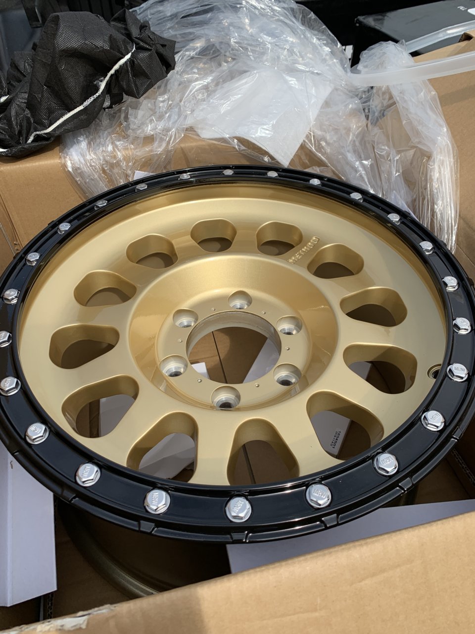

    fake4x4
    fake4x4 Well-Known Member
    Jun 20, 2015
    #157787
    911
    Los Angeles, California
    3rd Gen Tacoma TRD Off-Road DCSB
    Cool stuff
    FE967A68-63F6-46D9-A3E9-A33B11A690FF.jpg CEEE2891-7A84-410E-8C25-99A807194161.jpg I’ll be showing a new setup shortly

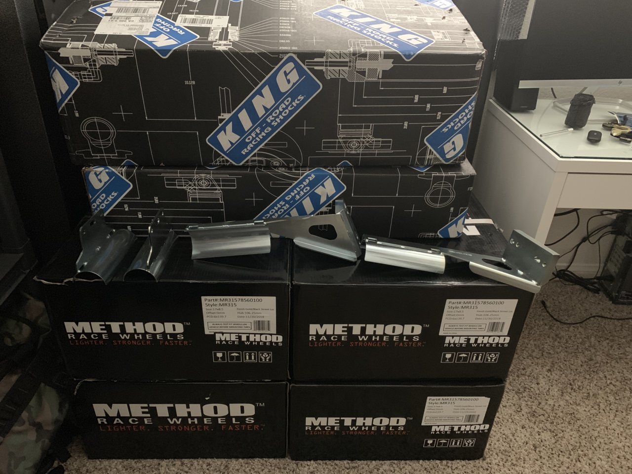

    Ok, last minute sanity check. I have the following parts arriving at my house this week to install on my 2019 DCLB TRD OR.
    Am I missing any critical parts for the install? Beyond that, is there anything else that may not be critical, but would still dramatically improve the setup right from the start?
    • (1) KING 25001-119A-EXT Tacoma 05+ 2.5" Remote Reservoir Front Shock Pair, w/Adjuster
    • (1) KING 25001-121A-EXT Tacoma 05+ 2.5"Remote Reservoir Rear Shock Pair, w/Adjuster
    • (1) IVD 51101 05+ Tacoma Icon RXT Leaf Spring Kit w/ u-bolts
    • (1) OME FK29 Driveline Carrier Bearing Drop Kit
    • (1) Total Chaos TCS 96504 UCA Set
    • (1) Rubicon Express RE1464 2.5 degree shim kit (pair)
    Note: After the install, I'm taking the truck directly to ECGS to have the replacement bushing for the needle bearing installed -- "just in case."
