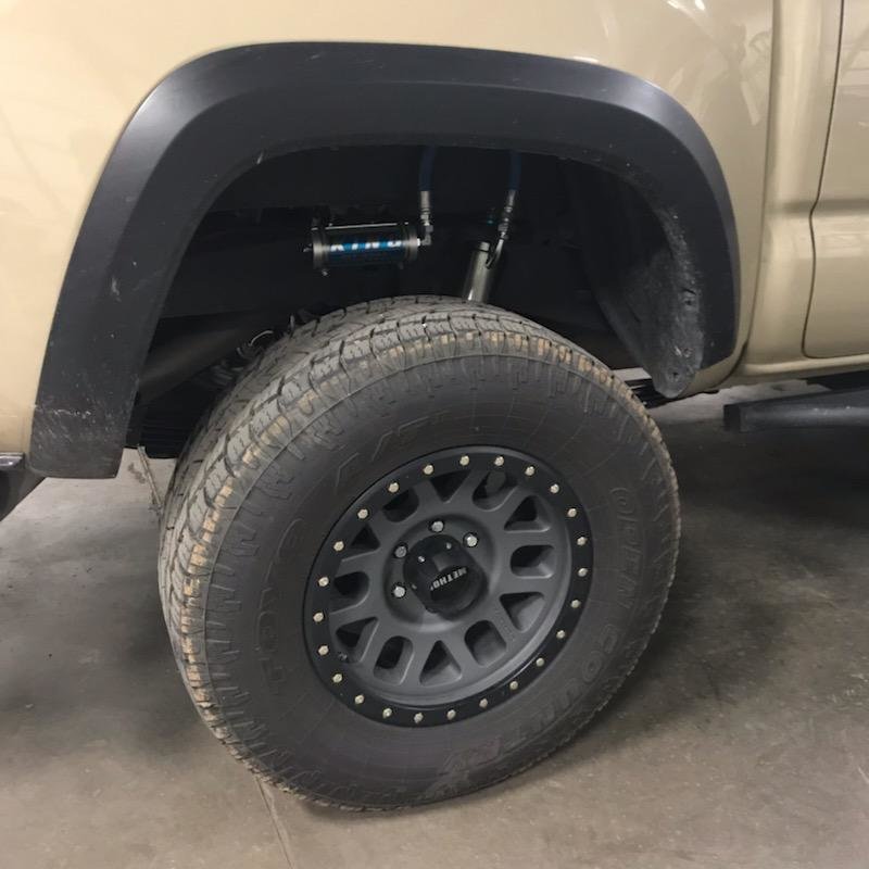

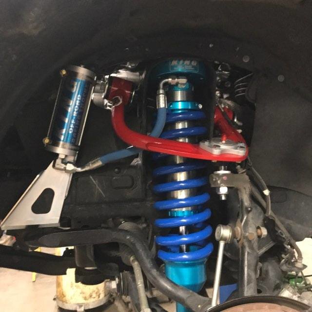

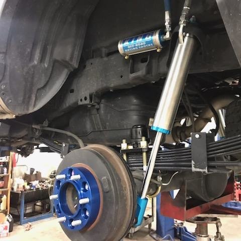

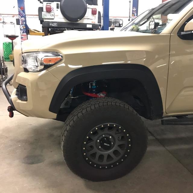

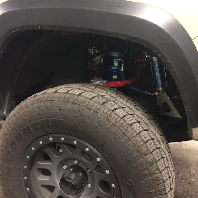

    Ok guys, now is the time to get some help bc install is pretty straightforward. Everything is on and it's back on the road,however the are some things I did not expect that I think are just adjustable and fixable things. I hope so at least, any feedback is greatly appreciated.I did use the 6 and 9 threads showing that a helping member said he used, i'm not sure this is where mine will stay or even needs to be but it doesn't seem to be causing any major problems or angles but again I'm here because I feel it should be a smoother ride and maybe that's not the setting I need to be at When I received them they were present and showing maybe 2-3 threads out of the box. This setting has put my truck at almost level if not actually level,and keep in mind I have ome hd full leaf pack and king 2.5 ext with 1 Inch longer rod end on rear.So here's what I'm dealing with.Overall it does seem like these things are insanely smooth,I test drove it down a damn rough road and o couldn't have asked for better comfort there. Problems are.....
    First of all I am obviously terribly out of alignment, I gave a pretty hard pull to the driver side, my mechanic says its nothing more than alignment and that will be fixed 100%.He said that on his drive pre install to get a feel for comparison after that he could tell it was never aligned correct and had a pull to the left already just not near as bad.I never really put thought into it but now unseen that being out of alignment can surely affect ride quality and I'm hoping things smooth out once straight.
    Secondly,I am having some serious rubbing right at the inner fender corner and on the cab mount corner, its obvious I'll have to get a Cmc sooner than later, however my mechanic actually said that because of where the uca sets further back after install that alignment will move it back forward and the major rubbing into the frame corner should go away even before the Cmc.
    Last but not least for sure this morning I noticed a slight vibration/shaking in the front end when breaking from a higher speed, i'm talking from like 40-45 and breaking enough to slow down and make a turn onto another road.Is there an issue to be causing this?Is this also something that alignment can affect?Like I said I'm just trying to get some advice so I dont waste time and money I dont have at this point.
    Third and the unknown for me,I've got some noises happening. It doesn't sound like anything major or like a mechanical malfunction or problem but they weren't there before or at least nit as noticeable. When driving at almost all times there is almost a light rumble happening, it actually has a similarity to what a chunky off road tire would sound/feel like,I think it gets better at higher speeds but I haven't really pushed the needle yet as I want everything perfect and aligned before I really stomp the skinny. When I slow down there does seem to be an area of a different sound happening, I believe its about 20-35ish but i honestly haven't drive but maybe 20 miles total since install.
    Again, overall I think we are close to where we need to be but its not perfect and at the cost I've paid I want perfect or as close as we can get, but I definitely don't want new issues.I plan to have the Ecgs bushing put in later this month when they have the truck and I already have the ome fk29 carrier bearing drop kit on the truck. Did you guys have any settling with the truck front and at what point did it seem to happen?Did anything change or get better/worse after more miles?I am set to get alignment Saturday but I also don't want to get it set up if things will have to be changed, I really don't want to get multiple alignments and pay each time. Any suggestions or advice greatly appreciated. I'm not quite sure how much lift I achieved honestly, and the inside bottom of my front tires are kicked in.

    A lot of your new found noises and some rubbing (those are 32" tires, right?) will go away with an alignment .
    If there will be something left over, deal with it after the alignment. One thing at the time:thumbsup:
    After that , if there is some vibration present in 2wd but gone in 4wd, ECGS bushing will fix that
