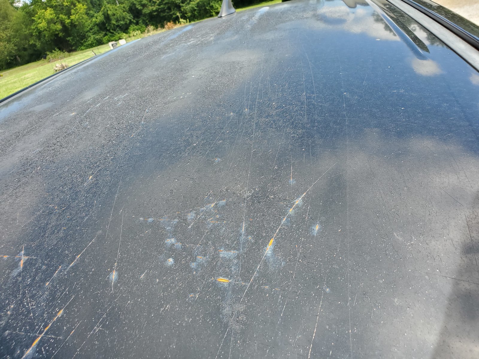

    Howdy y'all.
    Im having an issue with my 2018 Tacoma. The paint on the roof and hood is blistering and peeling. Toyota is refusing to remedy the issue since it's out of warranty.
    Has anyone else experienced this? Any tips?

    Sand entire roof, prime, apply vinyl or paint.
    Paint fails, only way to fix is to repaint

    What's with the scratches?

    Those are some deep scratches what does the rest of the truck look like?

    Rest of the truck is perfectly fine. Roof and hood have extreme UV damage.

    Those are some deep scratches into the metal, which introduced moisture under the paint. That'll be their out on a warranty claim. Fwiw, Toyota's are known for shit paint. Just ask the guys with white ones...

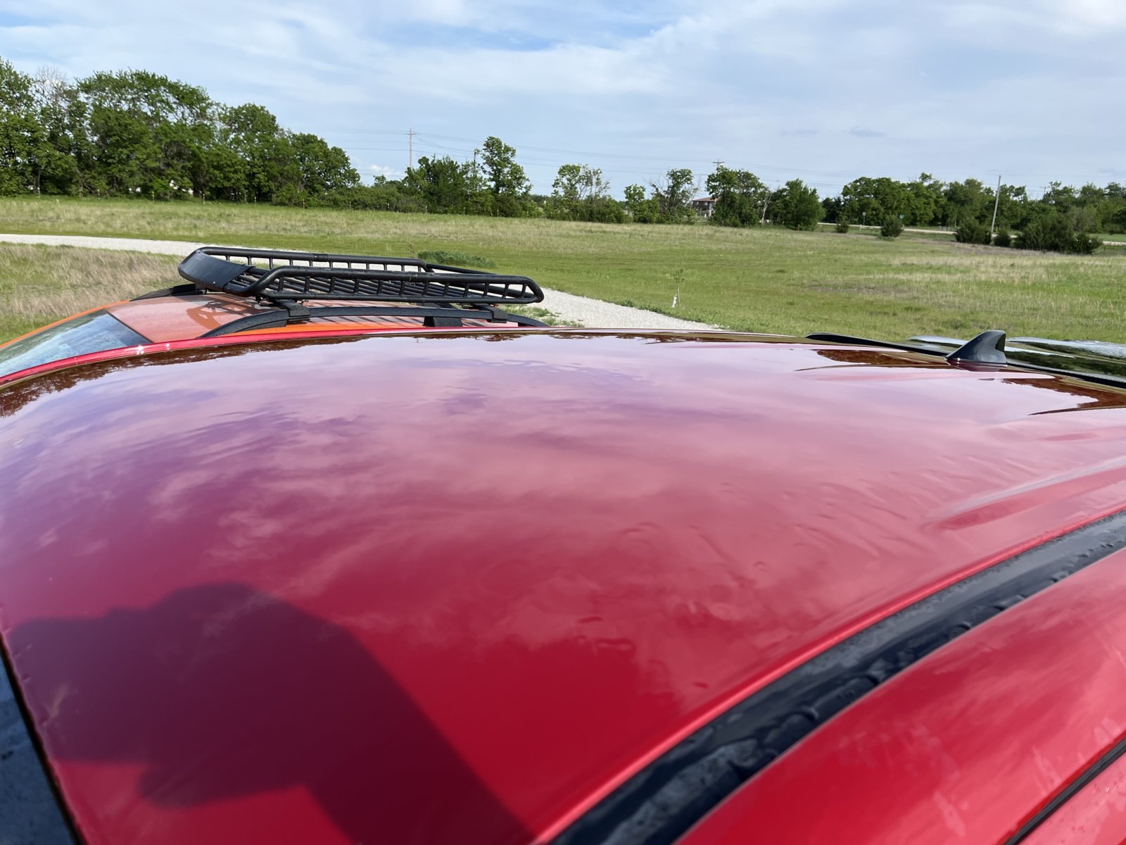

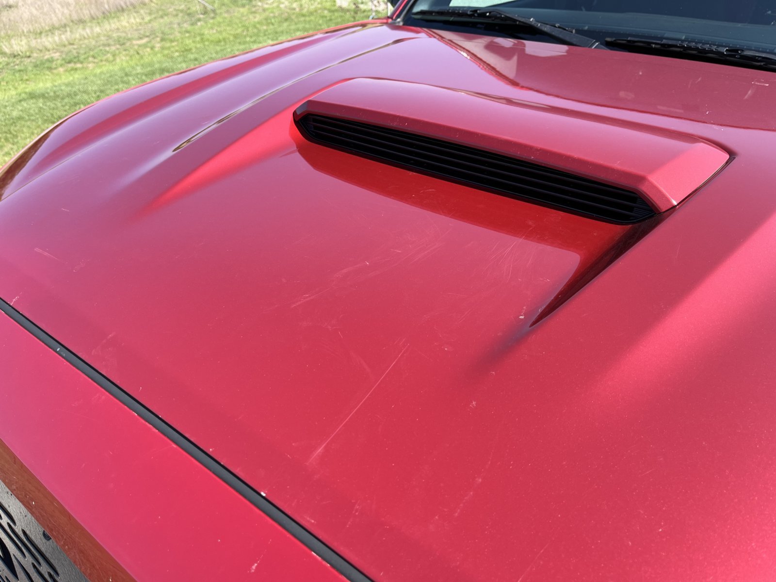

    Haven’t posted in over a year, but saw this and had to say woah!
    My 2016 is outside 90% of the time for the last 9 years (Oct 2015 build) in direct UV/Sun exposure. That includes Kansas weather, occasional small hail (I do put it inside of a barn if I know ahead of time it’s going to be really bad), snow, and everything else.
    And it looks like this…
    I do wash it usually once a month or so. I don’t use any kind of coating, ceramic, wax, etc. Just plain old jug of car wash soap or the automated wash in town. It’s had a roof bag up there a time or two. Been under some low hanging small branches on trails or overgrown pathways. And still looks just fine.
    Seems like OP has had something directly scratch into the paint at some point in the past? I’ve got scratches all over the hood from the kids or others sitting things on the hood and letting them scoot around :( But they are still not that deep…
    Rock chips are more of a problem for me.

    My guy those are deep scratches past the primer that are rusting and have compromised the clear.
    I don't doubt that the paint was failing, but there's far more than that going on here.
    Are you hauling trash on your roof or what? This looks like a metal truck bed.
