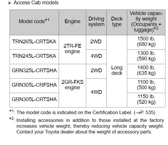

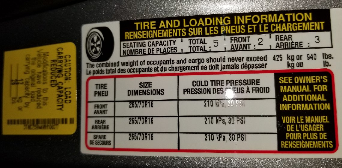

    The yellow sticker is due to having the port added "predator tubes". Those will come off, but 140 pounds of Caliraised Rock Sliders are going on. Toss on aluminum skid plate (68 pounds),
    RSI Smart Cap (240?) and I'm down to 540 pounds for people and cargo.
    The four Cylinder AC 2WD is 1500 pounds load capacity.

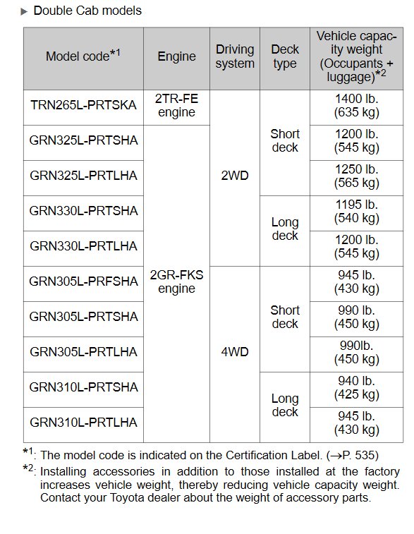

    One small but very important point.
    Any modifications or add-ons will increase the weight of the "empty" truck, thereby reducing the Cargo capacity. The GVWR doesn't change.
    To be sure. Take your truck to a CAT scale with you and a full fuel tank. Weigh it and you. Subtract this from the GVWR to find your cargo load capacity.
    Some manufacturers publish the cargo load capacity with a 150 lb driver and full fuel tank subtracted from the GVWR.
