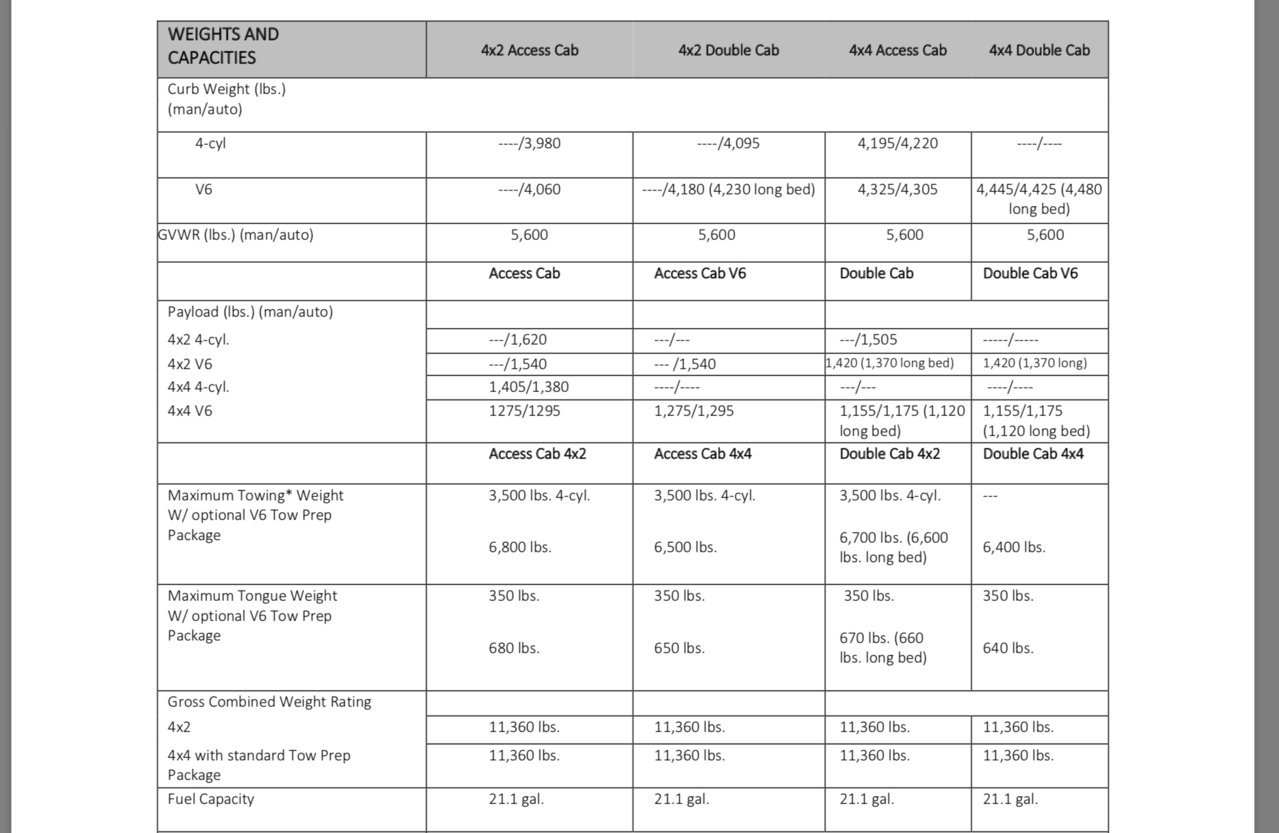

    Just for comparison:
    F150 is 1326lb in a configuration like our doublecab.

    This chart seems more reasonable...I'm curious why my door sticker says 950lbs but the chart 4x4 DCLB is 1120
    tacocart762 likes this.

    You got tube steps? Bed mat? Tow package? Tonnueau cover? Any and all accessories add weight and reduce payload
    tonered likes this.

    I’m guessing some combination of factory and port added components. The PDF for my truck shows a payload of 1295lbs but my door sticker says 1200lbs.
    inwood customs likes this.

    no thats the strange thing, it only came with mud flaps and floor mats haha nothing extra to add weight...but ill believe the 1120...stupid ratings are usually very conservative anyway.
