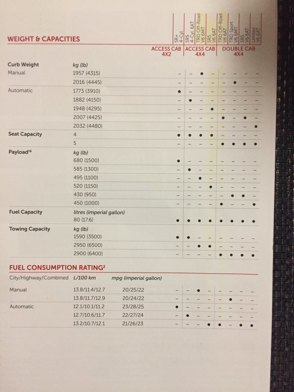

    The sticker on my door reads 1000 lbs max payload. It appears that there are 175 lbs in extra weight added at the dealer. I never would have thought that running boards, mud flaps and a soft tonneau cover would account for that much weight but I don’t know of any other extras unless the trailer hitch is also considered extra.

    The brochure for the 2018s is showing 950 lbs payload for TRD Sport manual and SR5 automatic. I was a bit surprised too when I read that the payload on my Off Road is 1000 lbs. That’s what the door sticker says as well. For some reason I thought it should be 1175 lbs.

    I mean if all the trucks have a GVWR of 5600lbs then you should just be able to weigh your truck and then subtract that from 5600lbs and get your payload. My truck doesnt weigh 4650lbs empty so idk where they got 950lbs from lol

    well i havent weighed my actual truck but the toyota website says my model and options weighs 4480lbs which should leave 1120lbs of payload. im not sure if the 4480lbs is assuming an empty or full tank of gas?

    A full tank of fuel is not included of published GVW. It's "nominal" or normal fuel load which could mean a quarter tank
    My truck has a curb weight of 4480 lbs, so add 120 lbs and there you go, 4600 lbs.
