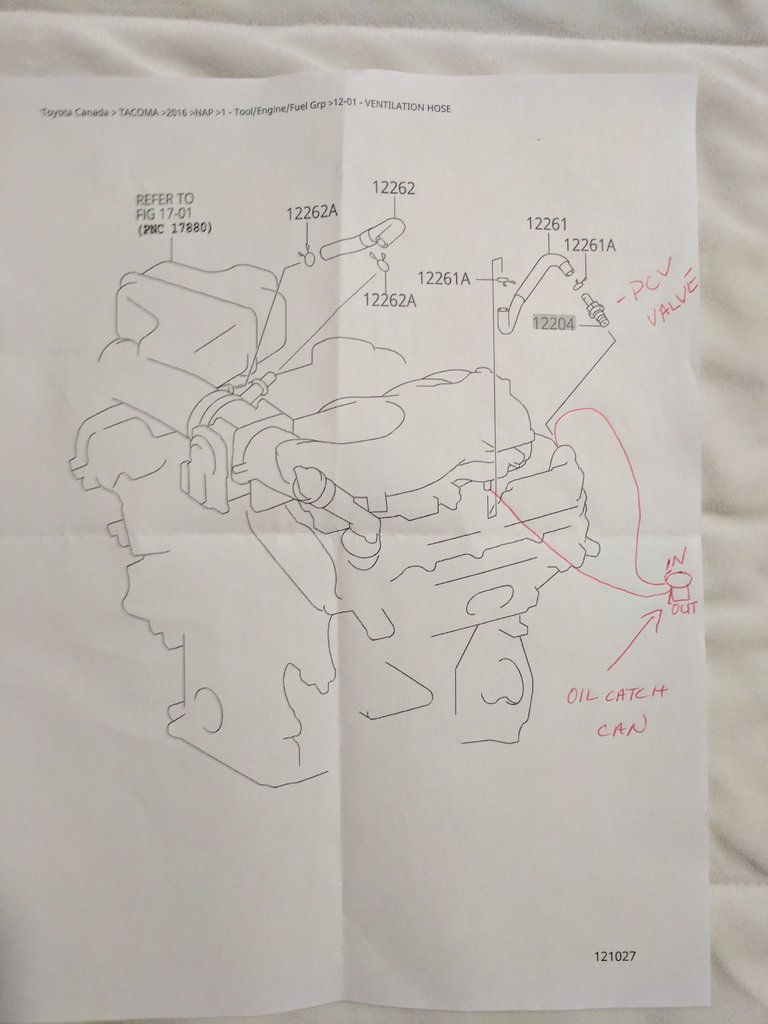

    Here is a diagram for all those asking where the pcv valve is on their 3rd gen tacoma for oil catch can install.

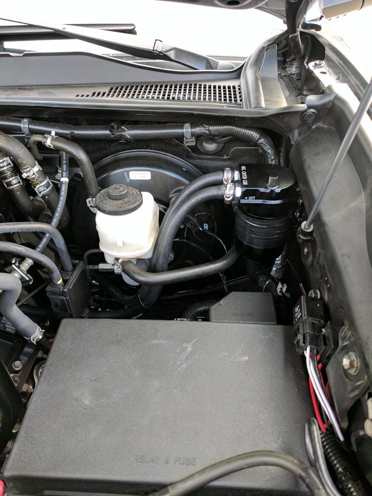

    Are there any others that have put a catch can on their 3rd gen?

    Looks like an ADD W1 catch can. I bought my red one from New Egg ( not usually known for auto parts). I have a manual transmission, so mine is installed on the other side due to the clutch resivoir.

    What size fuel lines did you use off the catch can ?

    I actually used nylon lines. I found a tool online to make connections just like factory. The lines are 8mmID

    I did shoot a video of it, I'm currently editing the video

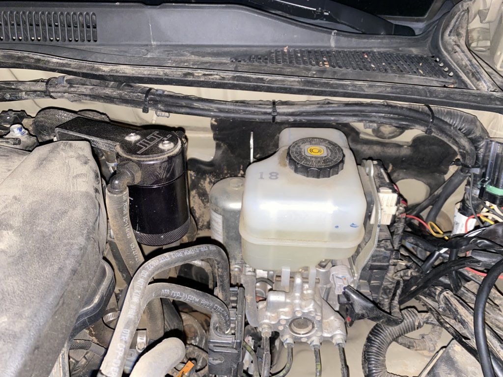

    I run one on mine. I empty it out every oil change and it’s got maybe a quarter inch of gasoline smelling muck each time.

    I run the JLT one on my Tacoma and had one on my 08 Mustang GT. JLT makes the best kit!

    That is the one I have, works fine. Someone reported once it makes their engine sound (even more) rattlely/knocky. I have not verified this, but my engine was never that quiet at idle.
