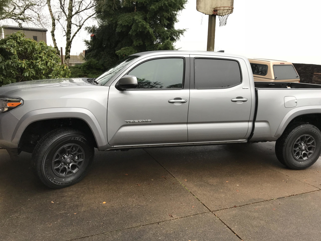

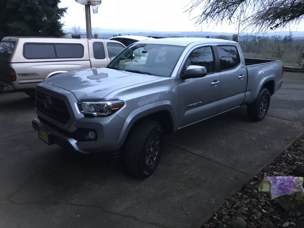

    Hey guys/gals, I finally pulled the trigger on a 2018 DCLB SR5 Tacoma last week! one.jpg two.jpg
    I am coming from a lifted 1st gen and I am really liking the 20+ years of upgrades (gold one in the pic is my dad's TRD limited).
