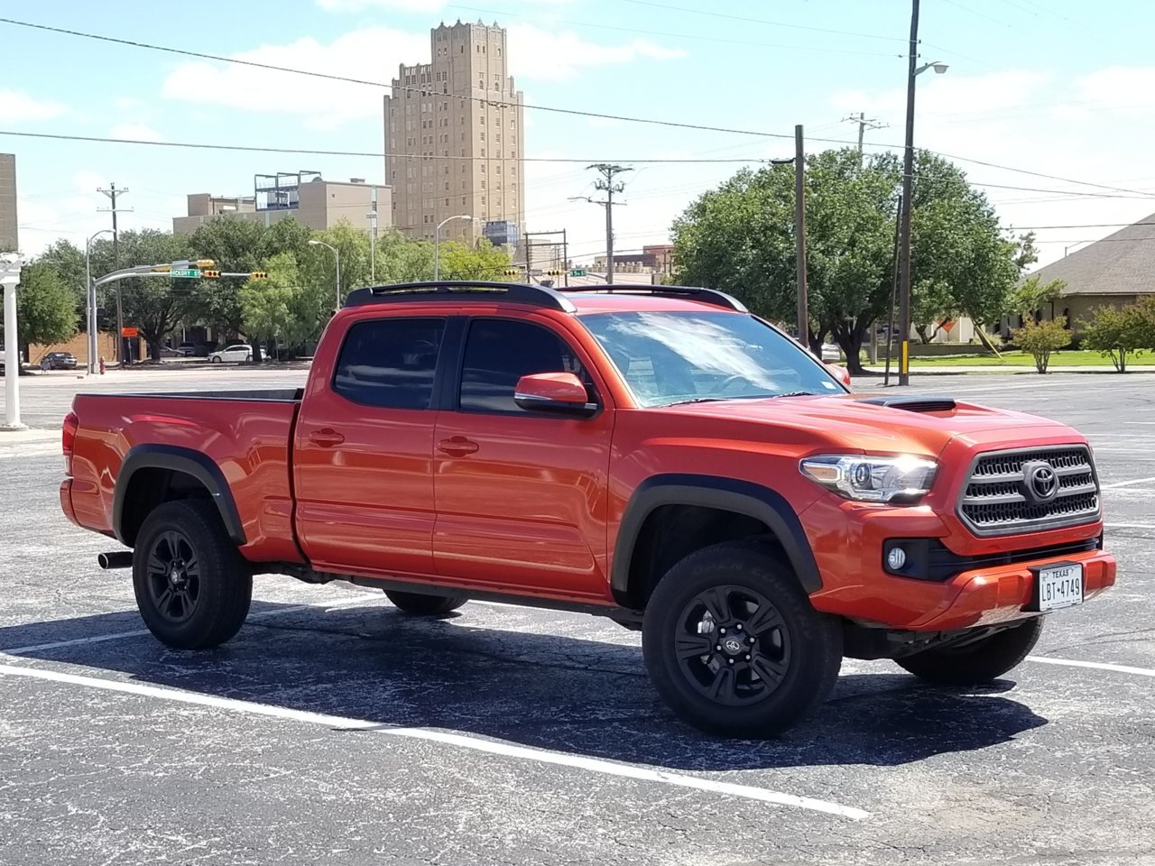

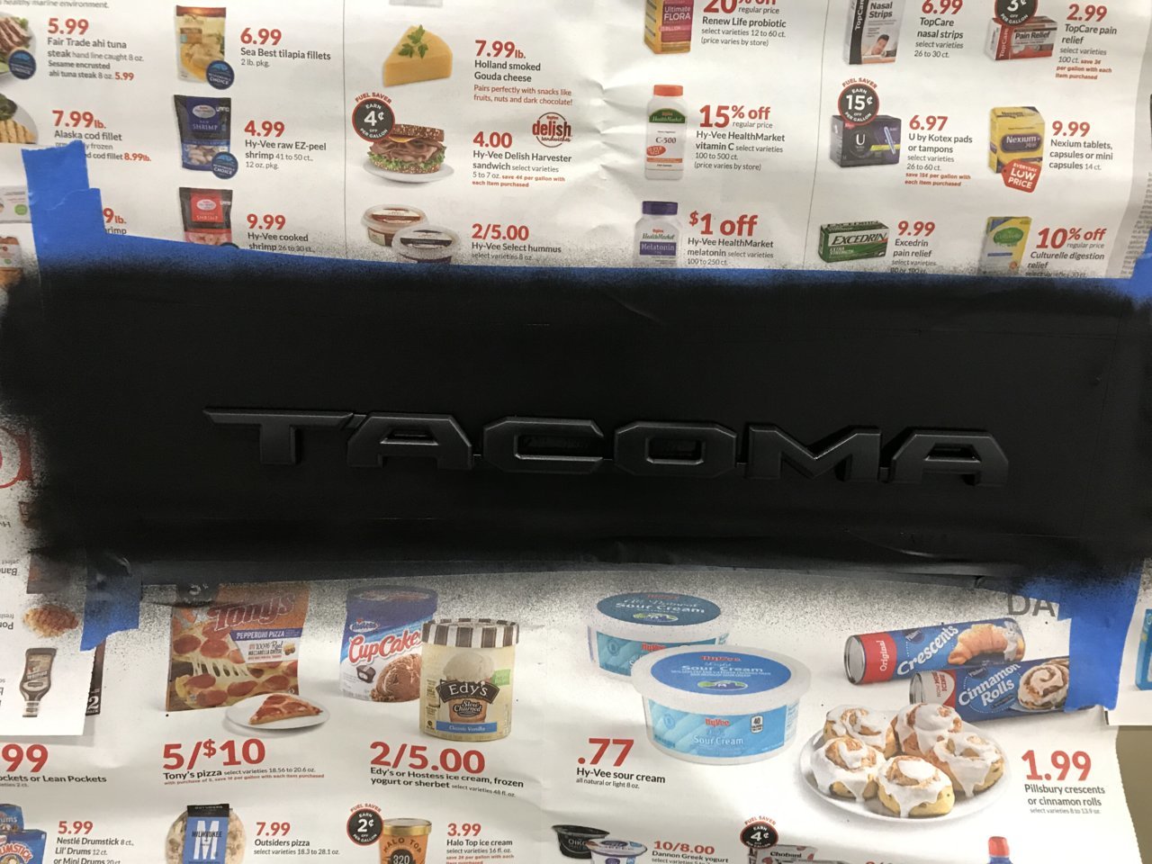

    Derp'd the chrome Tacoma and V6 badges over the weekend. Taped off and applied about 10 coats while washing the wife's Tahoe. Waited about 10 minutes between coats and removed the excess after 30 minutes of final dry time. Outside it was in the low 80's with low humidity.

    Easy, wasnt it. Mines been on about 2 1/2 years now. NO FAIL at all.

    Very easy, just leave enough paint exposed and spray multiple coats. Peels off like magic and stays on the chrome.
