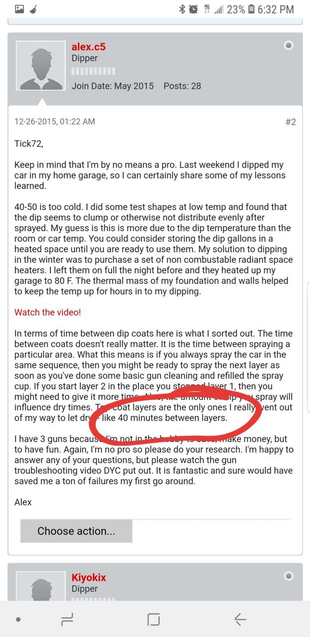

    yeah... seattle…. about 45 degrees out right now. I get the warming the can... but surprised about time between coats.

    Yeah, that's the shitty part cause usually 4 or 5 coats is needed. If your working in a garage and can have a heater going and the garage door cracked open enough for good ventilation then you can probably get away with 30minutes between coats.

    Definitely do not need to wait that long between coats. 5 mins is plenty. Especially if it’s colder out that stuff will stiffen quick.

    I’ve never waited that long between coats on anything I’ve dipped. Wheels, emblems, my kids bike. And I’ve had perfect results.

    I've also never had to wait that long between coats, I've also never dipped in weather colder than 65 degrees F. I've heard and read in a couple of different forums and it's even somewhere dipyourcar.com
    Here is 1 fourm I found quick when I just searched.
    http://www.dipyourcarforums.com/for...0525-temperature-and-what-to-do-between-coats
    I'd rather the guy play it safe then have a huge mess and a shitty job when done.

    It will stick, but again the cold weather will play a huge part in the process. Try and be in an enclosed area that you can raise the temperature, but still have it well ventilated since spraying PlastiDip.
    Clean your surface thoroughly with some rubbing alcohol and also heat the cans by setting them in warm water between coats.
