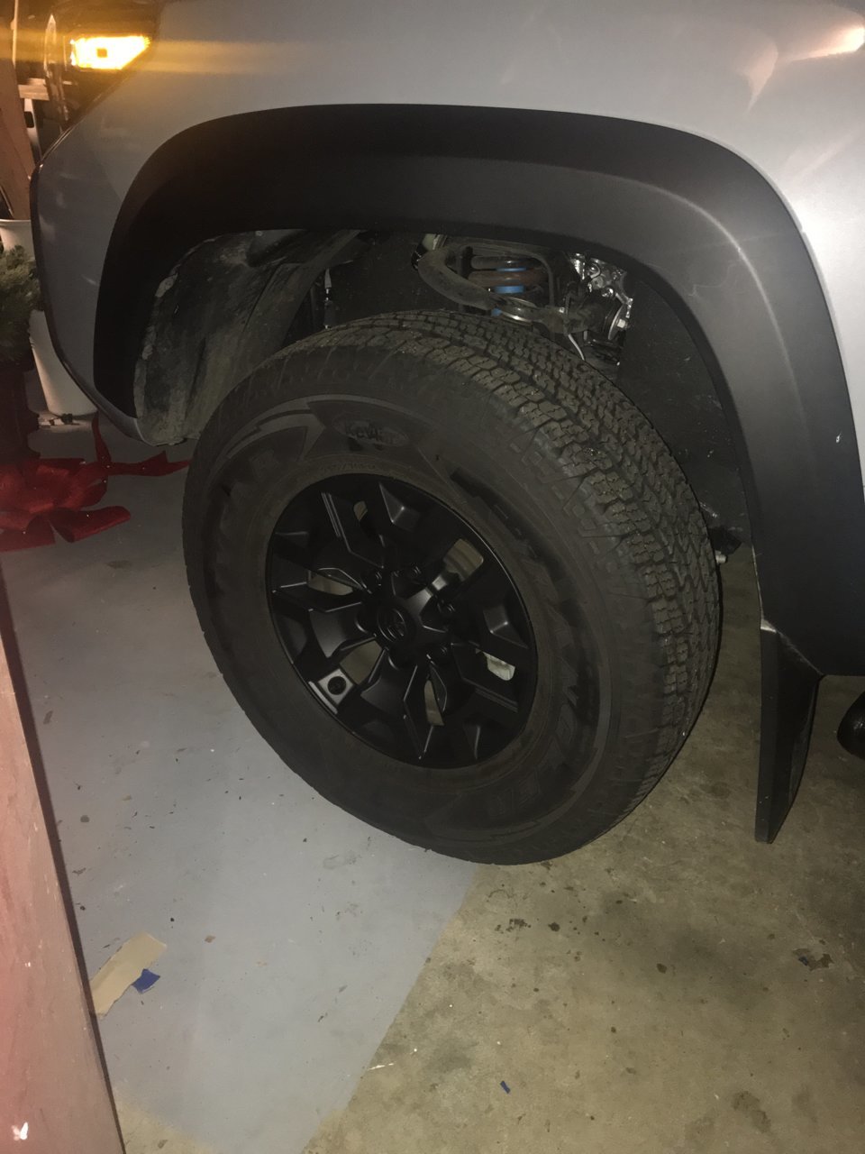

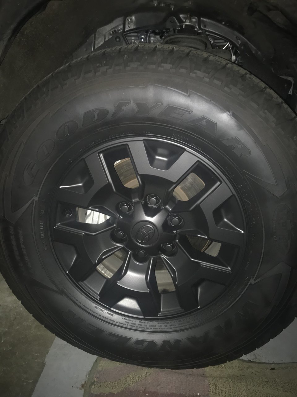

    This is under a daylight paint inspection light. So as highlighting of imperfection as you can get without actual sunlight. 20190109_201822.jpg
    4 coats of black. 2 coats of metalizer. not perfect but i am happy with it. you have to approach the truck and inspect to see difference.

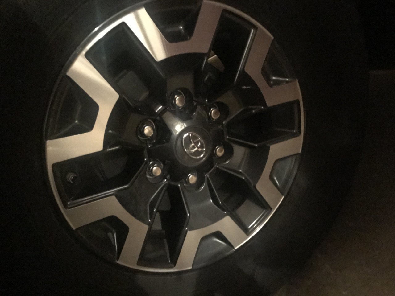

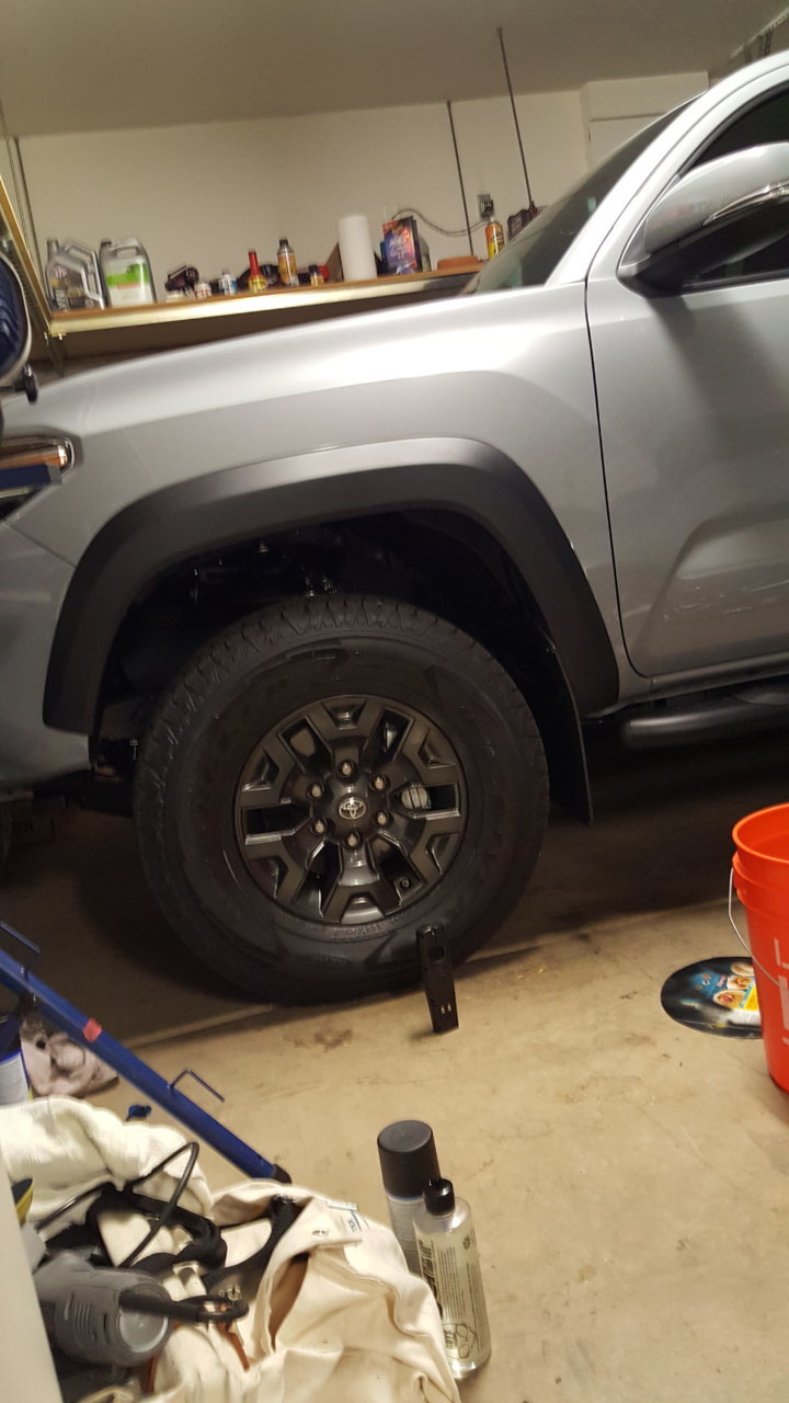

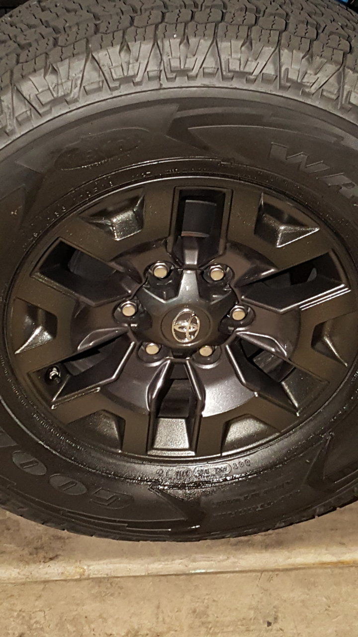

    I also only did the out most part of the wheel. Ghetto done and i am happy with its results. You can see my ego box on the floor... i taped that to the center cap to reduce over spray to the center of the wheel. lol

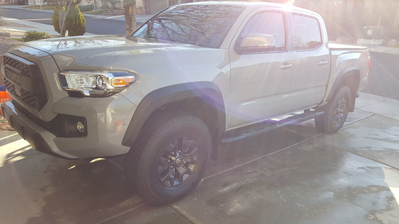

    Here’s my 2018 Tacoma trd off road wheels platidipped I did the tacky layer and 4 building layers in gloss black then finished the last 2 layers of matte black. And they are holding up awesome!
    The gloss black is stickier so I feel like it helps bond it better for heavy duty stuff.

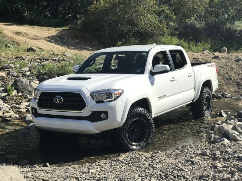

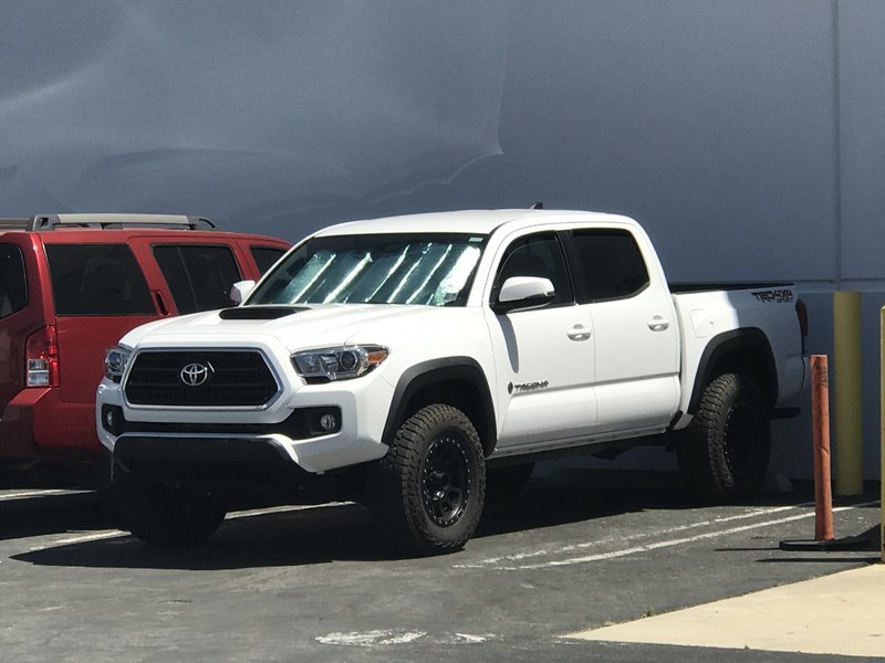

    Nope ! Replaced it with SSO Slimeline. But Yes it was perfect when i took it off. On for a good year and a half if not longer .Holds up really well just put on lots of coats and that also helps in removal if you want to take it off!
