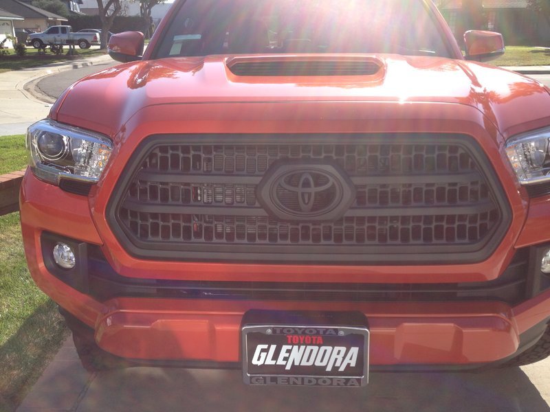

    I left the chrome attached to the colored surround took it off the truck and just taped about 1/2 inch between chrome and colored piece, 5 coats peeled off tape came out really nice!!IMG_0794.jpg

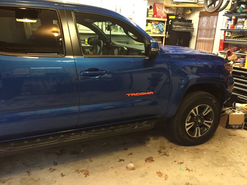

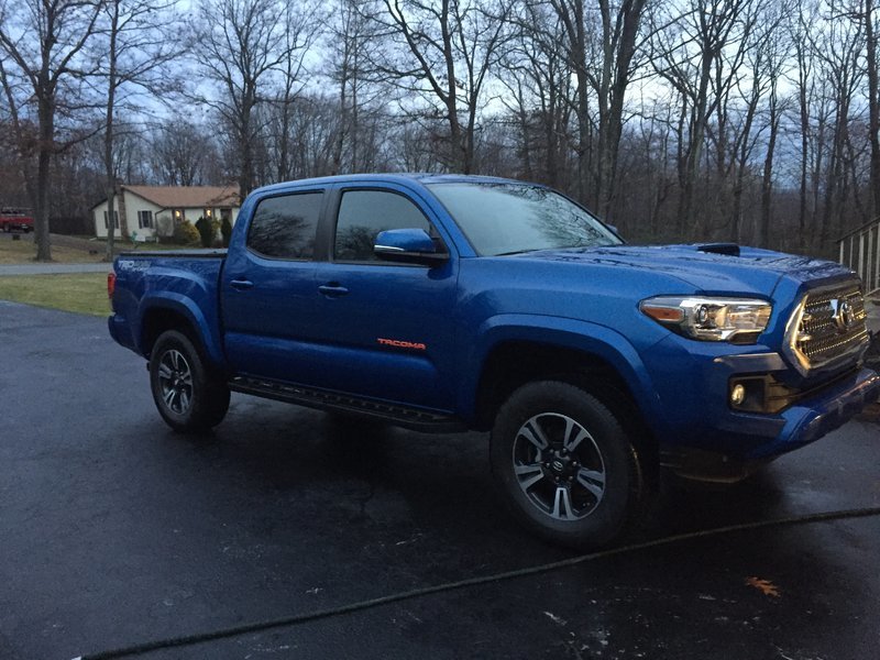

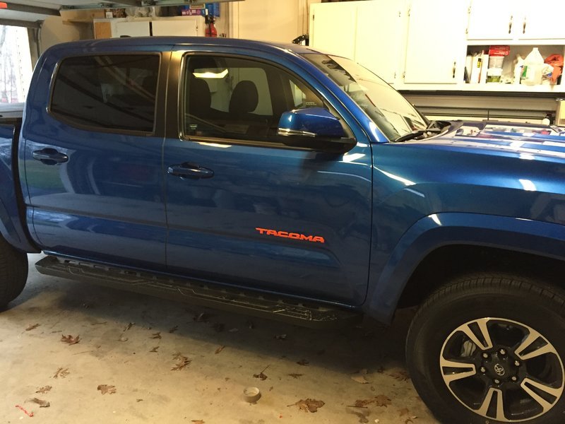

    went orange with the blue NY METS colors or McGrath or DungeyIMG_2394.jpg IMG_2395.jpg IMG_2452.jpg mc.jpg dungy.jpg

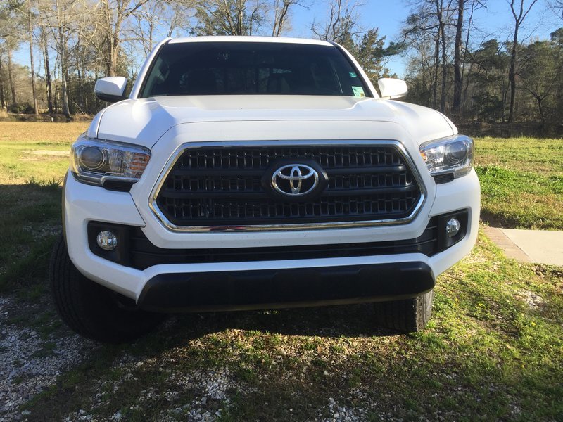

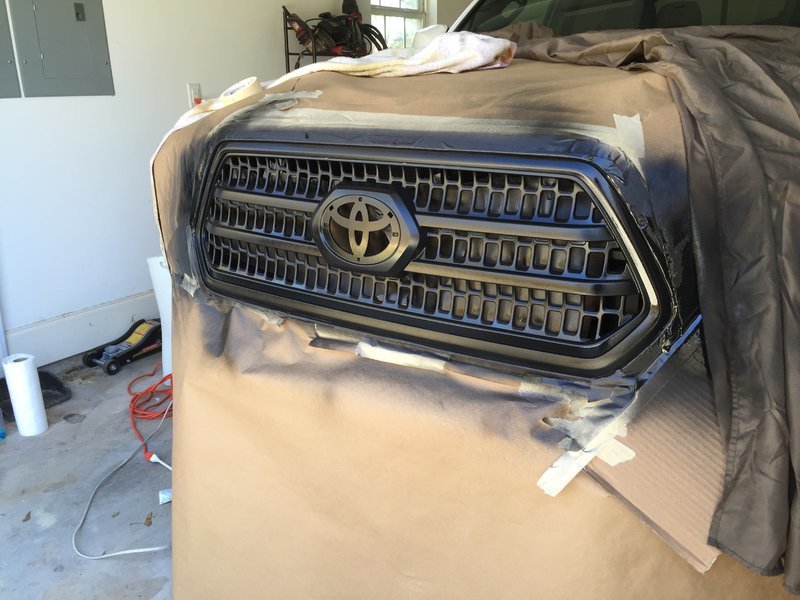

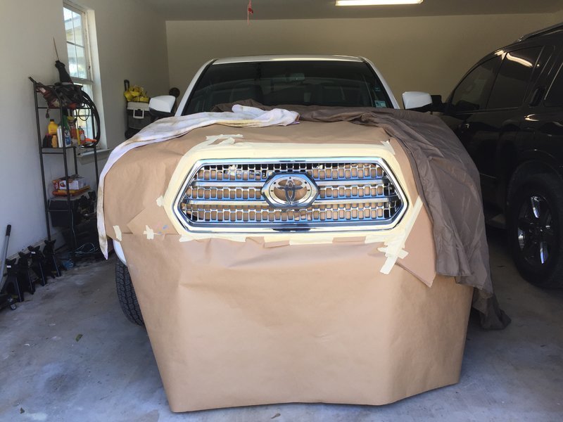

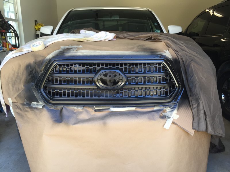

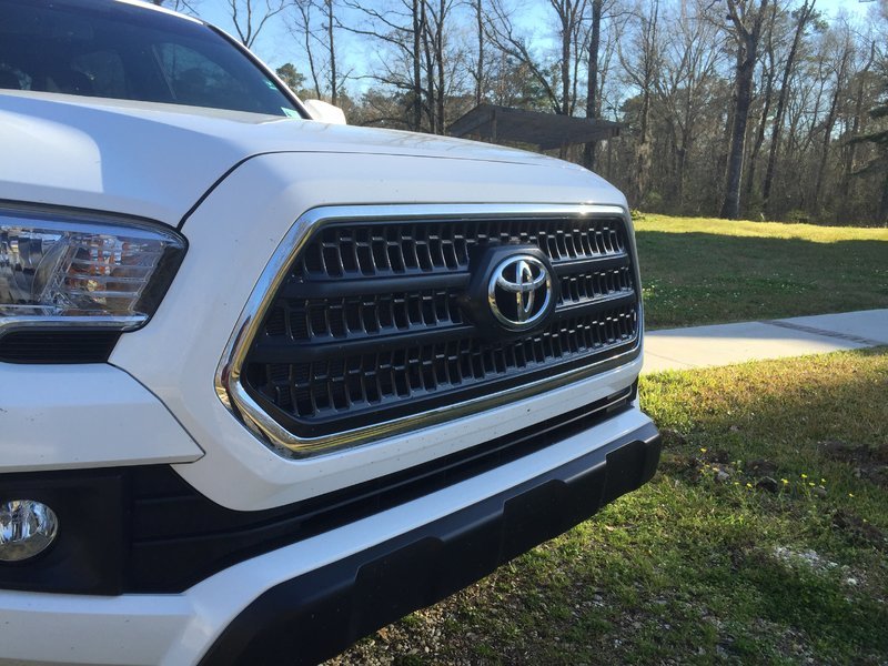

    Taped off around grill and added left over Christmas wrapping paper to cover larger areas and behind grill. Toyota emblem pops out with ease. Plastidipped grill with 4 coats of black and 2 coats of clearorizer(made by plastidip). After a few days passed, the outer chrome ring started to bubble up and it bothered me so I began to peel it off. Luckily, the outer ring peeled off separate from the rest of the grill and looks 100% better and almost factory! I'll keep it like this until an aftermarket grill comes out worth buying.

    Looks awesome! Mine is the same but on on a black truck. I live in Prairieville, La. Went to school in Hammond at Southeastern. Good luck with the mods on your new truck! I'm close if you ever need help. Welcome!

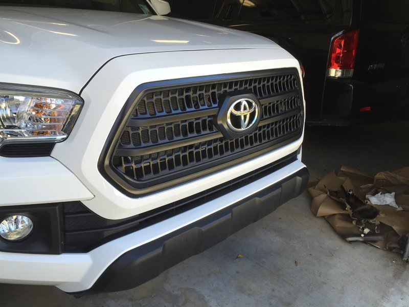

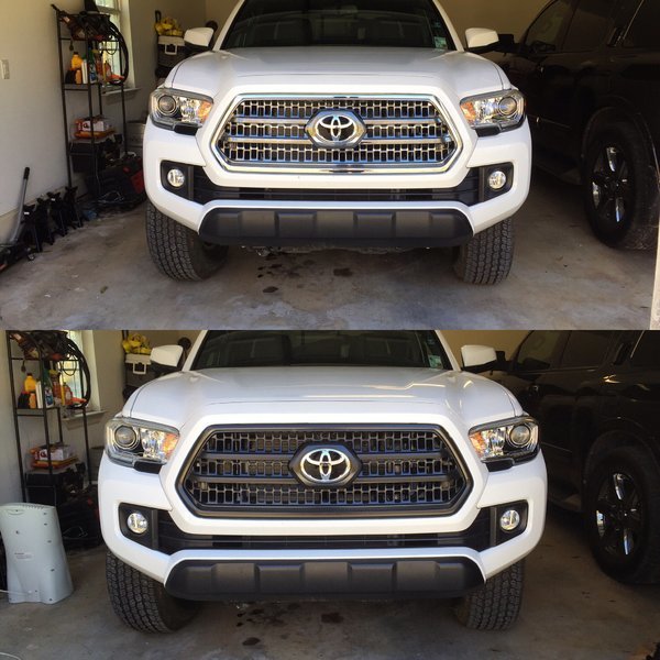

    Finished mine up this morning. 4 coats black obviously and went with 2 coats of the glossifier. Glossifier made it look more of a "factory" look to me. Matches the other black plastic on front pretty good.
