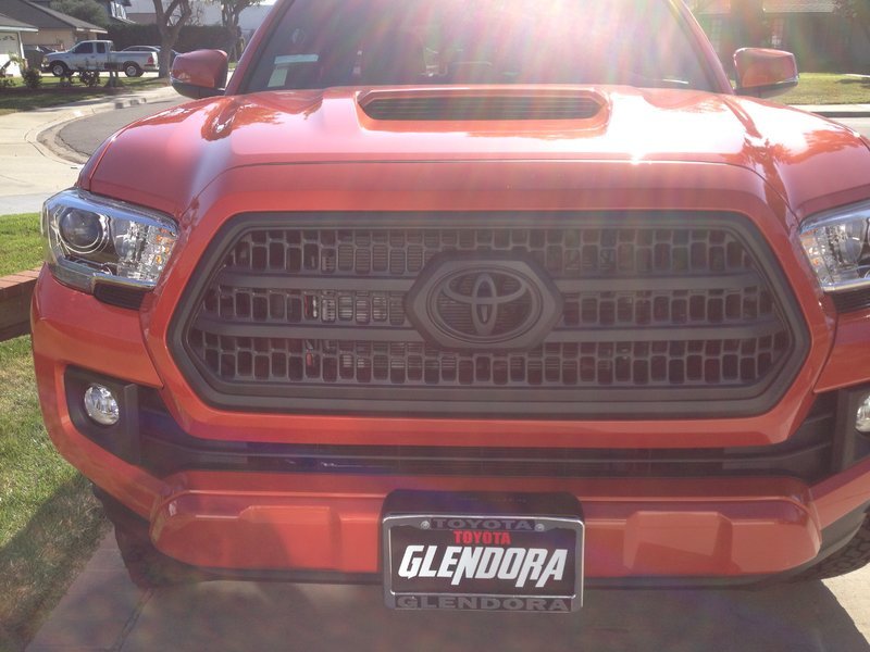

    I didn't separate my grill just took it off the truck and plasti dipped it black 5 coats came out really nice just clean with soap and water make sure it is completely dry 4-5 coats 20-25 minutes between coats done good luckIMG_0794.jpg

    Looks good.

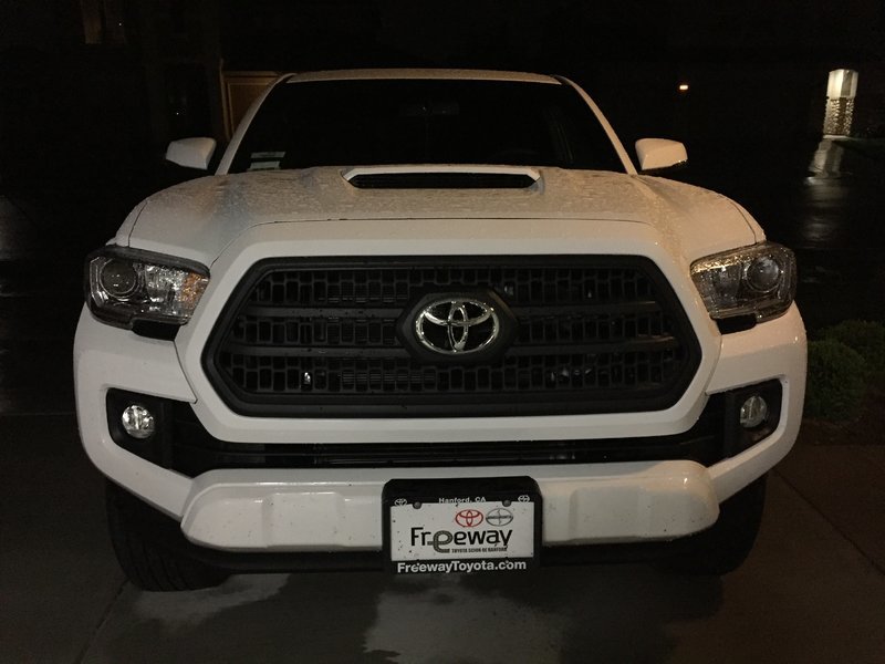

    How did you remove the emblem or dip it a different color?

    the emblem pops right off

    I did my emblems yesterday came out awesome , i was thinking about having the grill painted black ,how hard was the grill to dip?

    It's not that hard I took the grill off the truck and just taped and masked off between the chrome and colored piece gave it 5 coats about 20 minutes between each the last coat waited about 5 minutes and peeled everything off came out great!!

    Dammit. Just saw how good this looks. Now I gotta go read all 12 pages...
    (I'm guessing this is a lot cheaper than a new black grill?)

    That's what I needed to see! I got Inferno OR 4x4, SB
