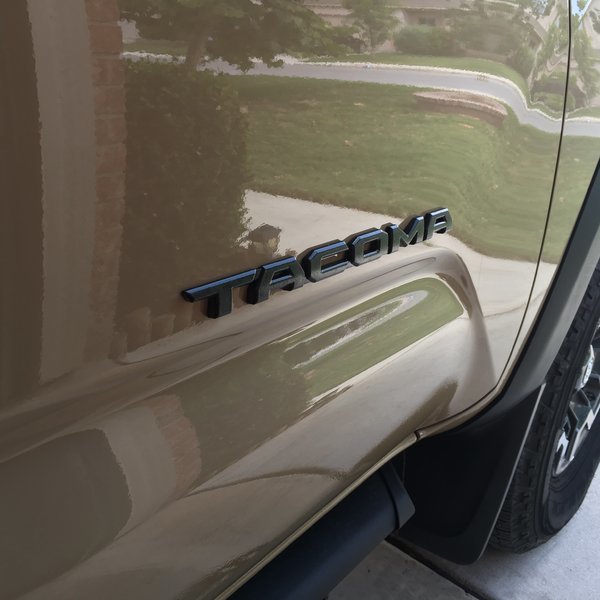

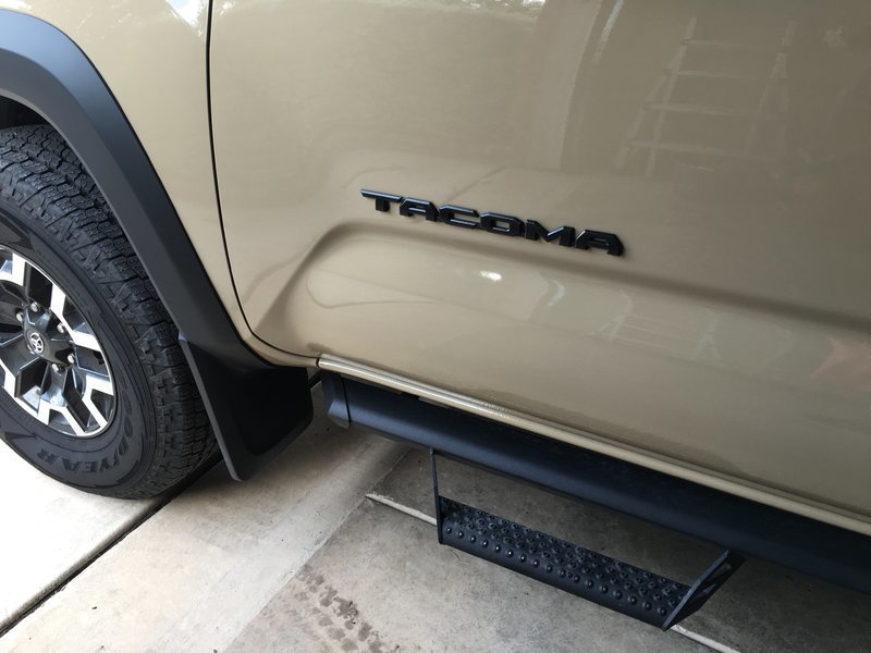

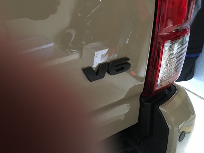

    Dipped the grill and emblems today. When I left the emblems on the truck and just made to take my time when removing the masking.
    I did 5 coats of dip and 2 coats of glossifier.
    Removing the grill was very east. As mentioned, it's just 2 bolts and 2 pins then pull it right off. Putting it back on was a little trickier as it was being stubborn lining back up. I used a toothpick to remove the dip from inside the letters.

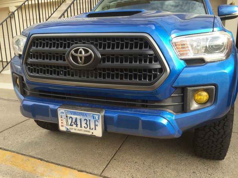

    Finally got around to doing the grill and badges. Didn't want all black, needed some contrast.

    Did you do two coats of the glossifier with the emblems on the vehicle? Did you mask inside the lettering so it doesn't get on the vehicle?
  10. Jun 14, 2016 at 5:45 AM
    #630
    sabercoug
    sabercoug Well-Known Member
    Mar 7, 2016
    #180545
    90
    Jason
    San Antonio, Texas
    2016 Tacoma TRD OR DBSB 4x4 tech pack w/jbl Quicksand
    I did 5 coats of dip on everything and 2 coats of glossifier on everything. I did leave the emblems on the vehicle. I did not mask inside the lettering. You just use a toothpick or similar to remove the dip from inside. It's actually pretty easy to do and it just comes right out. I was surprised at how it just peels away and stays on the lettering.

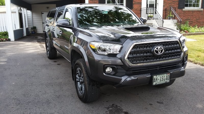

    2016 Grey Tacoma sport dc long bed
