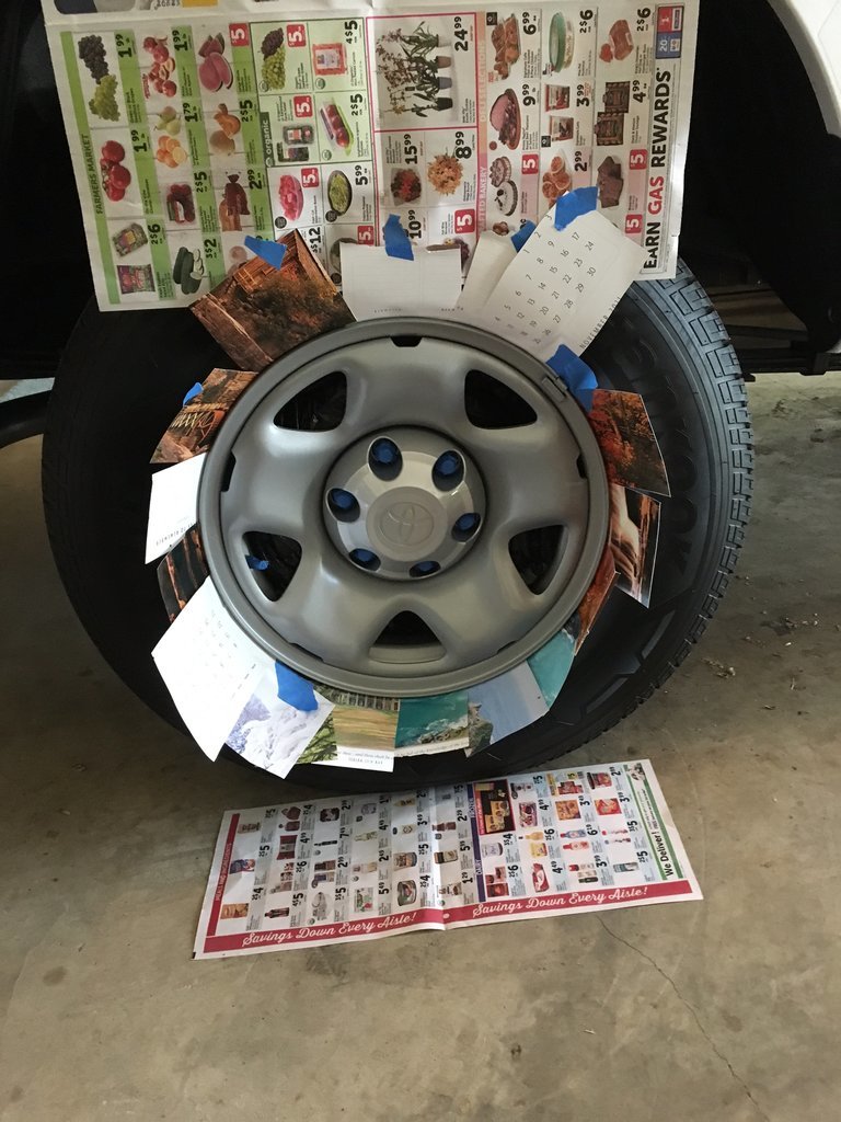

    how did you protect the rotors and brakes?

    Not to make you feel like you wasted too much time, but more for those in the future, you don’t need to do this to the wheels (all the cards between rim and tire). All you do is bag the brakes and then spray. All the over spray peels right off the tire. Super easy to dip wheels.

    hang on... bag the brakes? wtf does that mean?

    https://www.youtube.com/watch?v=ek1mRhEIbHA
    would be pretty hard on that taco maybe. but i've done it with small holes in rims. just have to be a bit more patient.
    Also on the end of the vid he shows why you don't need to use all those cards on the rim. you just peel off the excess easily.
    the vid is from the original guys who plastidipped EVERYTHING. they put the product in paint guns and dip whole lamborghinis and stuff. spend an hour or 10 watching some of their videos. good stuff.
    i've dipped wheels for a good 5-6 years now. always looks great! need to find time to do my truck.

    I used a trash bag. Just pulled it between spokes and tucked it around the rotor.
    greg8765[QUOTED] likes this.

    Thanks. I read different opinions here so I tried to take the safe route. The prep work took 80% of the time. Next time I'll try without.

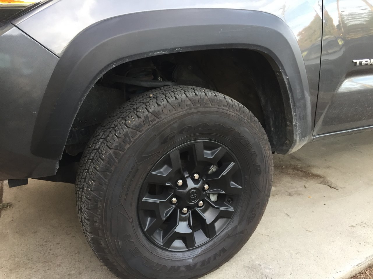

    In case you were wondering how TRD offroad stock wheels look like plasti dipped 6coats, 2 coats gloss

    That looks awesome! How many cans of black PlastiDip did it take, and also, did you use the PlastiDip Primer?
    I've been kicking around doing the same thing.
    Joelvarine likes this.
  14. Nov 9, 2017 at 7:25 AM
    #1474
    northstream
    northstream Well-Known Member
    Sep 9, 2016
    #196846
    286
    Ben
    Ashburn, VA
    2017 TRD OR DCSB MT
  15. Nov 9, 2017 at 10:11 PM
    #1475
    Joelvarine
    Joelvarine Active Member
    Feb 26, 2017
    #211767
    35
    Central CALI
    Hey Caliente used 2.5 cans, cost was around $20 bucks total. I did not prime, i cleaned wheels and then used windex with a car rag. I spayed with about 10 mins in between. if you have time i would suggest 20 mins. I took the wheels off no other way in my opinion, doing it on wheels allows for drip and is sloppy. I used rustoleum gloss protective enamel. take your time in this phase to achieve desired gloss... more gloss the darker and looks more professional. I hate the look of peeling plastic dip. I used painters tape around the wheels, don't have to be meticulous, leave overspray layers so you can peel it off. Hope yours come out totally worth it. $20 instead of a G or more on wheels.
