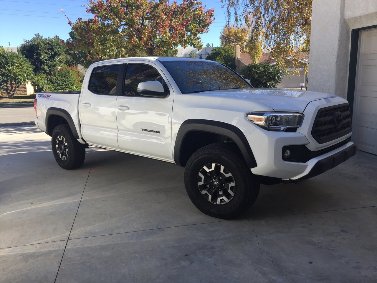

    I did mine 1.5 years ago and still holding just fine. Looks the same as day 1.

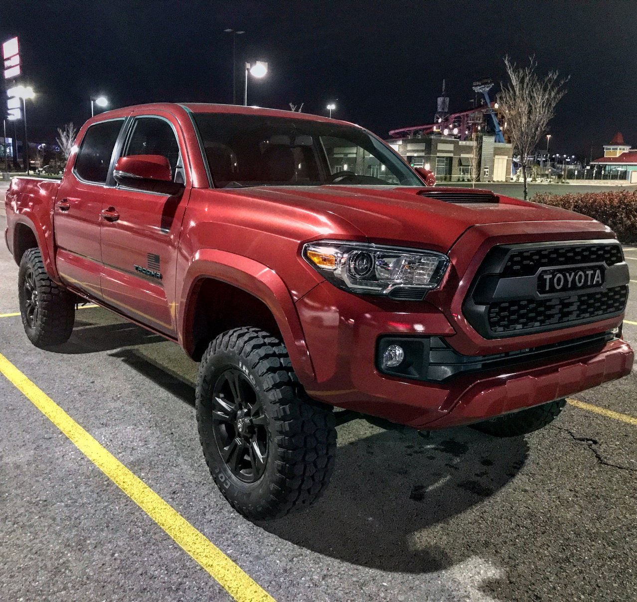

    Dipped mine last week, I took mine off the truck and removed the center caps. 5 coats of plasti, and one coat of Rustolium clear coat.

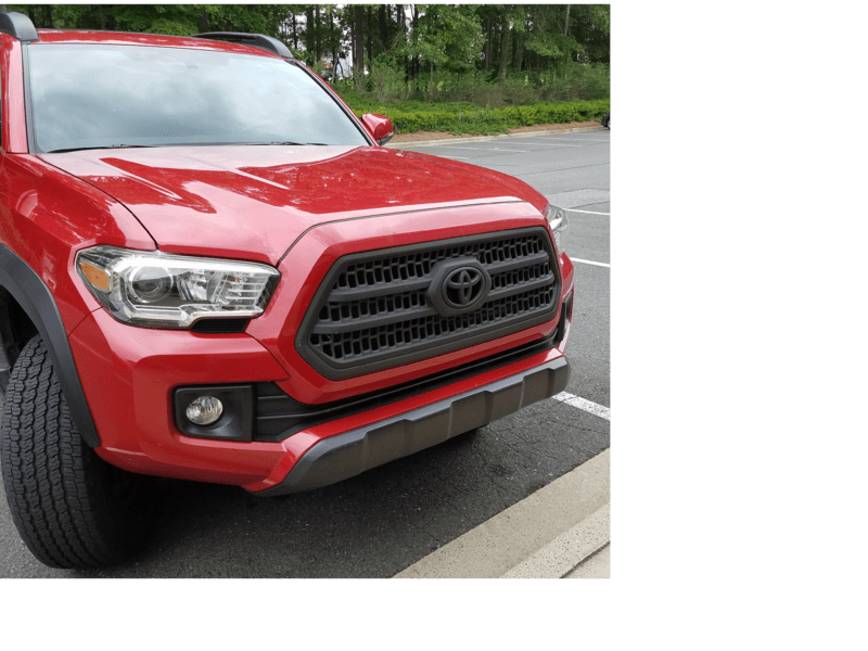

    For anyone that wants to black out their grille and knows they are never wanting going back to chrome, the duplicolor bed liner stuff works great and adds neat texture. That's what I did for a while beforw I bought a faux pro grille.

    This is what I'm planning on doing to mine. Any tips? What did you do for prep, just clean and scuff it up?

    Can't believe how cool those sport wheels looks dipped. Didn't recognize them at first.

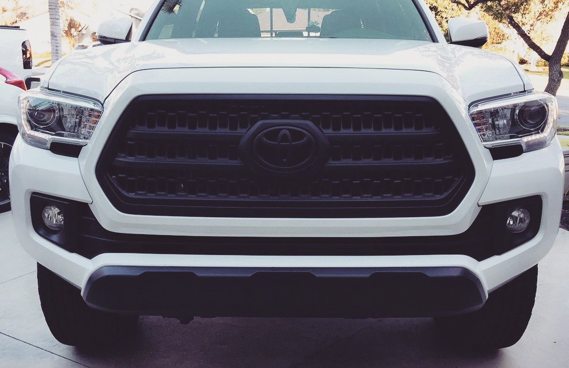

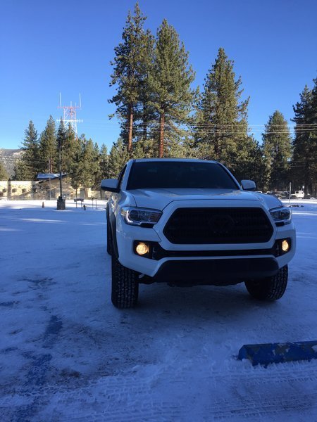

    Threw this on last year and its lasted 26000mi still looking great!

    I cleaned and sanded it, then cleaned it again. The grille is a pain to sand due to all the curves but just get in there with sandpaper wrapped around your finger. I also used my crappy black & decker sander for the straight/flat portions. Check out my post below. Also be aware that this bedliner stuff was semi-soft even a few days after, but once it cured it became hard as a rock.
    https://www.tacomaworld.com/threads...-3rd-gen-today.399305/page-1772#post-13565861
    I eventually bought a faux pro grill from ebay but not due to the bedliner, just wanted a different look. I am keeping the grille just in case the faux one does not hold up.

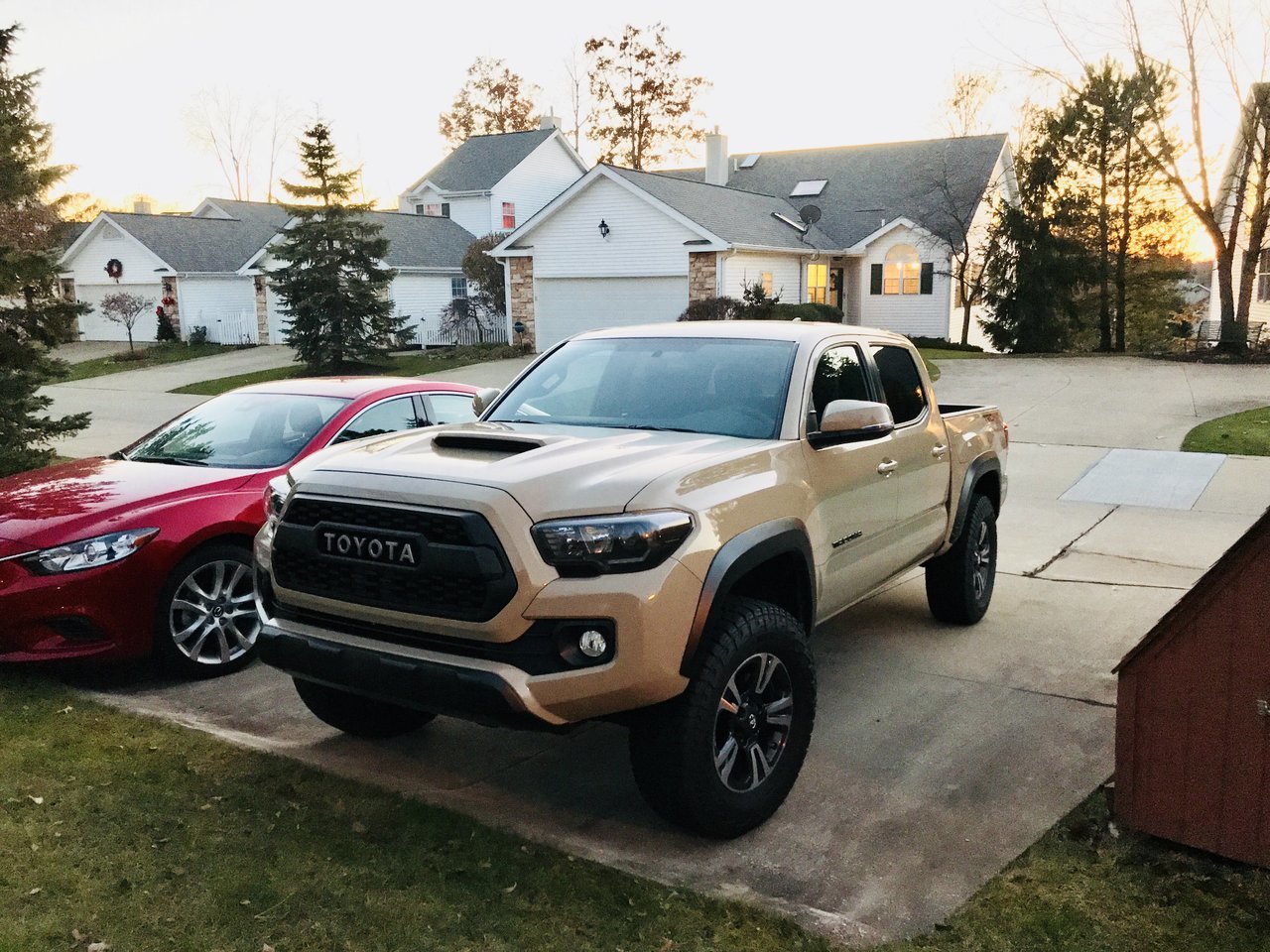

    Mine have been dipped along with the front valence for about 5 months and I Run it through the car wash at my work frequently. It’s held up great and I just wipe it down with turtle wax ice once and a while to make it look like new. I think I did 4-5 coats or something.

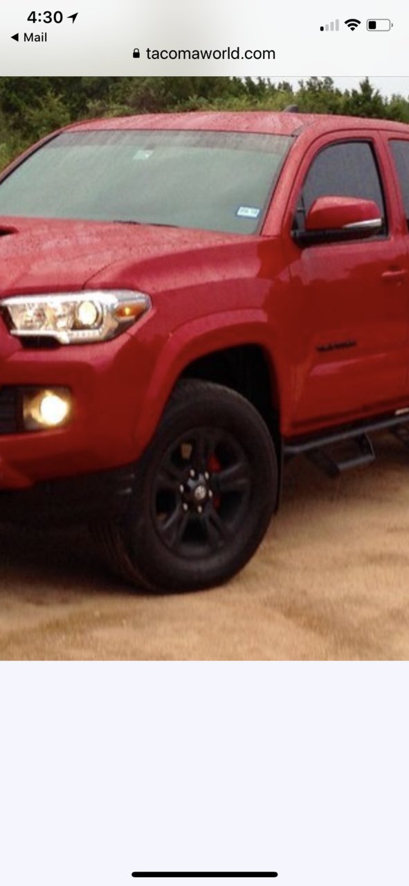

    i like your setup and want to do the same. What brand plasti-dip and glossifier did you use?
