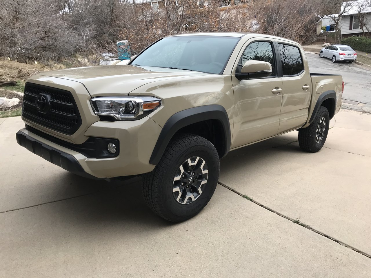

  2. Mar 14, 2018 at 4:28 AM
    #1642
    Kirbstomp1287
    Kirbstomp1287 @MilSpecTaco
    Jan 23, 2018
    #242213
    278
    17’ Inferno SR5 V6 DCSB XP
    That looks sweet! Is it easy to take the mirror covers off??

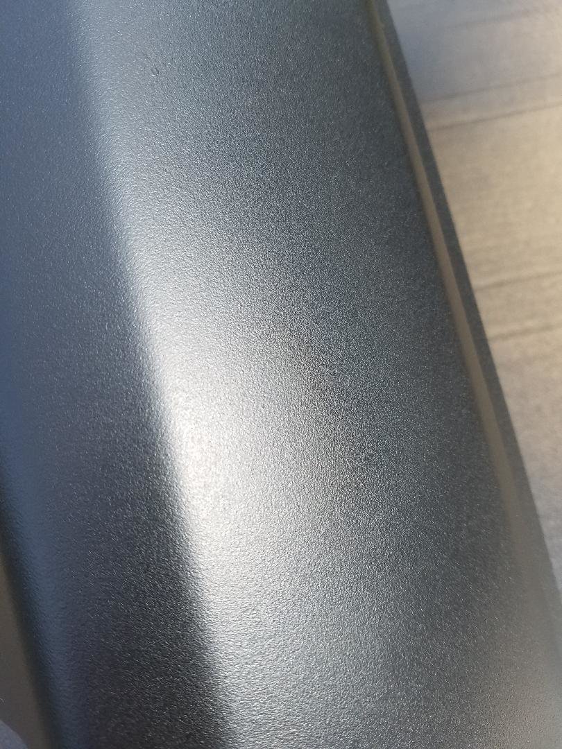

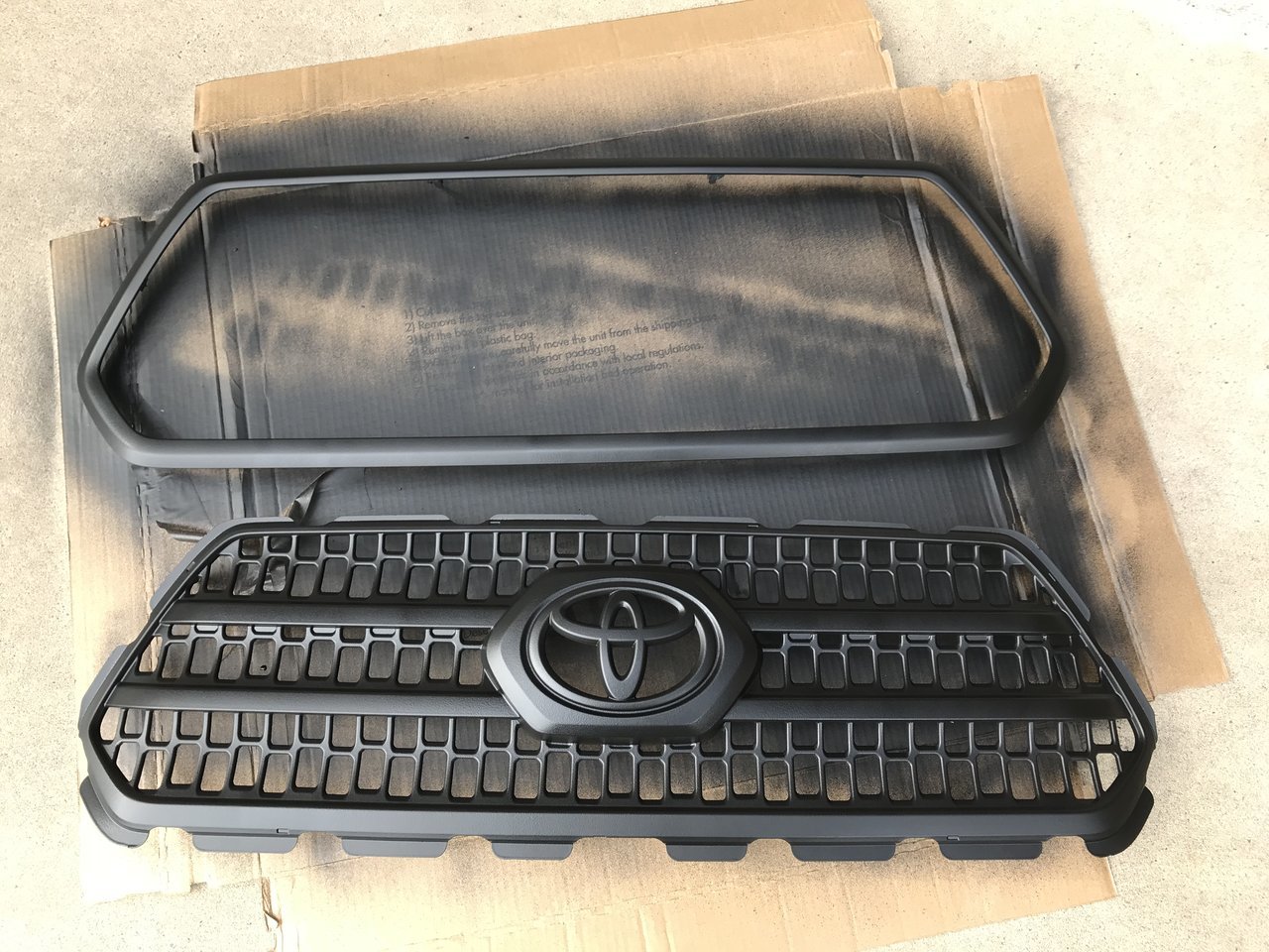

    OK, so I went all out to try and get the smoothest finish. I set up a paint booth in my small heated shop. I warmed the cans, shook well before each coat and kept them warm between coats. I sprayed each coat at about 5-8 minutes. 8 coats then two coats of glossifier.
    This is the finish before the 2 coats of glossifier:
    Final product:
    I've got to think that this is as smooth as it gets. The texture looks rougher in the close-ups than it really is. It's actually pretty darn smooth. This looks great. But no way can you get it as smooth as conventional paint.
    I'm going to utilize this method from now on with anything that I can remove easily from the truck. ie. turn signal covers!
    I need to wait a few days for things to warm up around here so I can do the badges.
    Kirk Out
