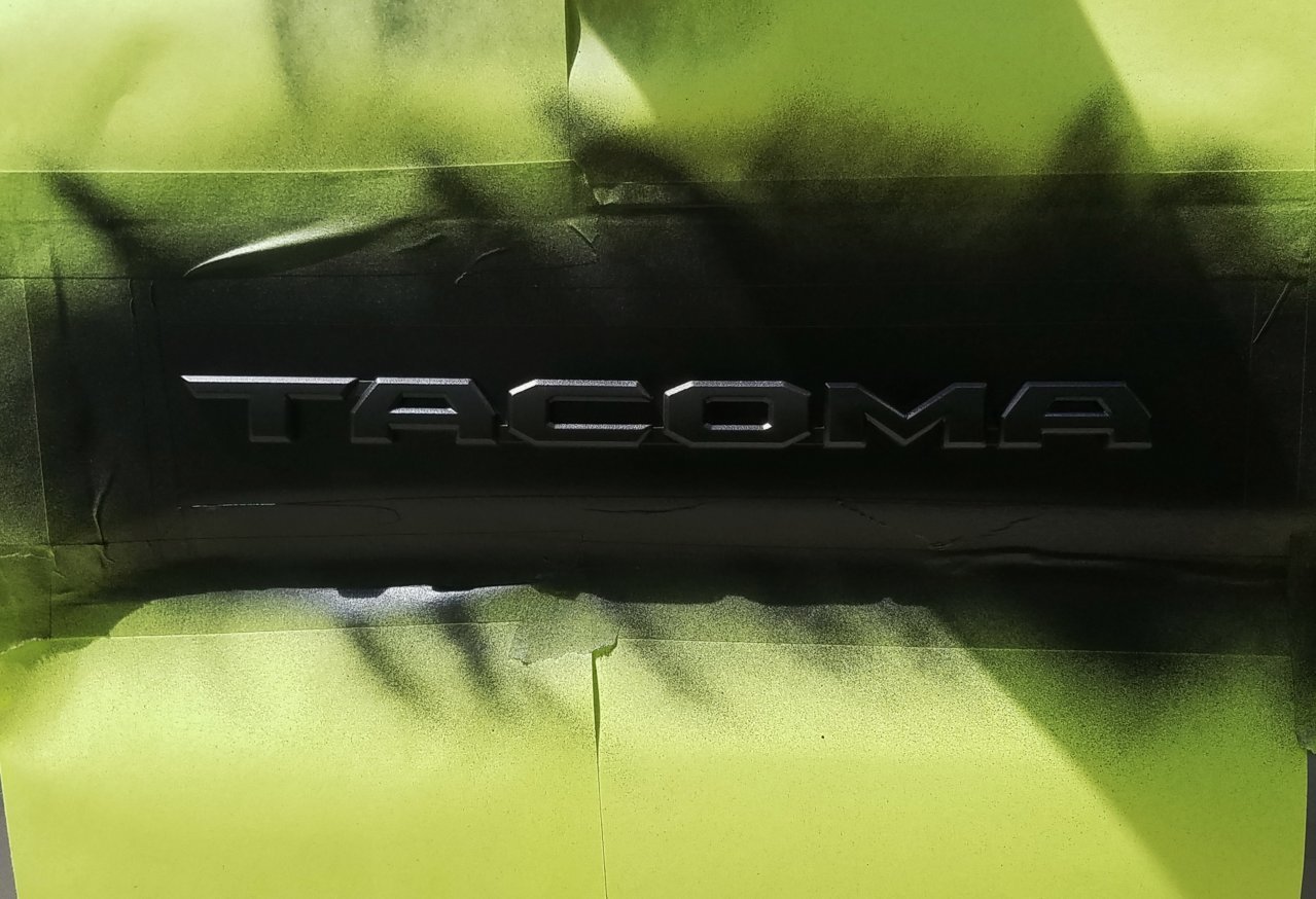

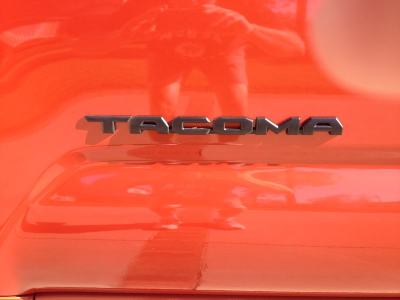

  3. Aug 2, 2018 at 6:07 PM
    #1963
    Batman85
    Batman85 Well-Known Member
    Jun 11, 2018
    #256093
    136
    2016 quicksand tacoma
    I plastidipped both. Emblems are easiest thing on truck to do. Leave a few inches around the emblem before taping and spray 4/5 coats letting dry 15 min between. After last coat let it dry then just get a corner and start peeling. The emblems sit off the truck enough that it just peels off around them. I have a video of me doing it but it won’t upload here I’ll try to put it on YouTube and tag it here.

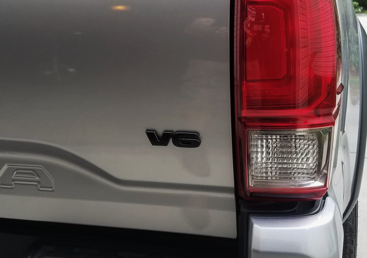

    i went a different route than most. i used (cant remember the color name) the gray metalizer dip on the emblems. i wanted to try to match the toyota emblem on the grill. its a pretty decent match. not exact but close enough.
    the door emblem looks a little darker than the grill emblem because of the light source.

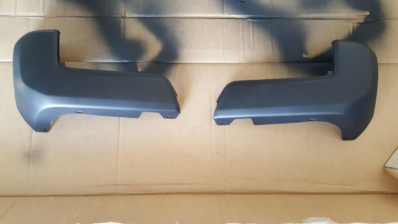

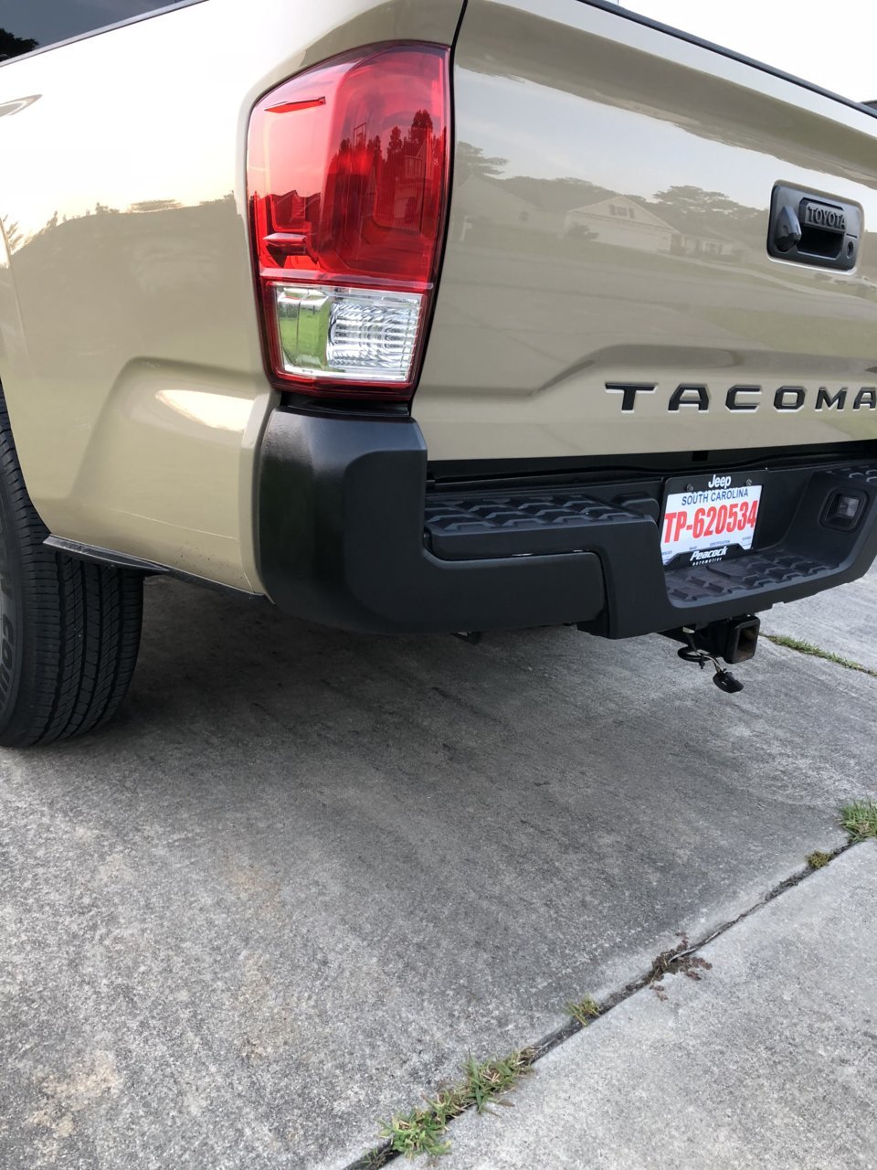

    Did the bumper caps today. I like it.D48DEA8D-95A0-4D12-B8FD-E6D5E2520F81.jpg E4B52246-6FDE-424B-BCF7-71395B8AF9C7.jpg

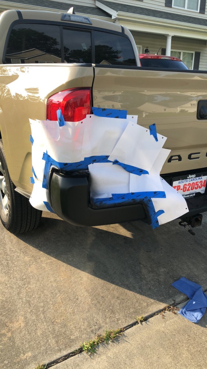

    20180818_145100-01.jpg 20180818_150531-01.jpg 20180818_161529-01.jpg 20180818_161542-01.jpg 20180818_163052(0)-01.jpg
