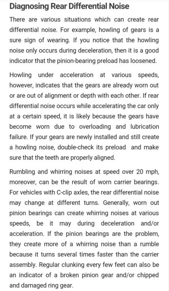

    Great video--he concludes that if the set-up is incorrect it will make noises. Very complicated process and could be easy to make a mistake either at the factory or replacement.
