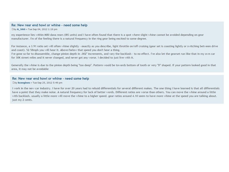

    Had some free time at work. I did random searches about diff whine to get other perspectives.
    Yes, this is a different car, 350z but the responses are pretty helpful. I thought the 5th post and the 2nd to the last post on page 2were pretty insightful.
    https://speedtalk.com/forum/viewtopic.php?f=19&t=32445
    If i remember correctly, OR (8.75") with Auto have 3.9 rear diff ratios. I see a lot of complaints about 3.91 rear ratios whining under light throttle (feathering) in different vehicles. Have to take into consideration that all these other vehicles don't run the same size tires so the speed (MPH) range that the whine occurs are different.

    Interesting thoughts, makes you wonder if all diffs make noise to some extent. Like I've said before, Im ok with the noise if it's just that. But a good majority of us are worried about this thing grenading on us down the line, esp out of warranty.
