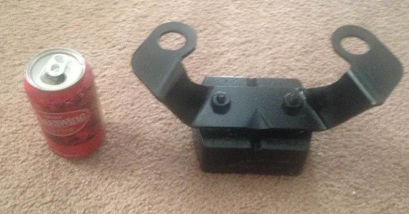

    Doing some searching online on "Diff Whine 55 MPH" and ran across a Subaru forum noting rear end whine around 55-60 mph. From their thread it seemed that Subaru's fix was a dynamic damper added to the rear diff. Basically rubber weights bolted onto the differential to reduce (the whine.
    Did a quick search and stumbled across a Ford Diff Damper.
    Then I also found another variant for a mustang: http://www.speedconcepts.net/product_info.php?products_id=1143
    So I wonder if this could be a viable solution?
  9. Jun 28, 2017 at 6:35 AM
    #2389
    fdbyrne
    fdbyrne Well-Known Member
    May 4, 2014
    #129114
    713
    Missouri
    2016 Tacoma TRD Off Road (Manual), 2004 4RUNNER V6 4x4
    That's an interesting idea but my gut feeling is that it wouldn't work for our situation.
    That solution would be great if the issue was only a natural harmonic resonance but I don't think it is in our case. If it was purely resonance then the sound wouldn't ever change. Mine didn't howl at all in the beginning, started after 500 miles, has gotten much louder, and now happens between 50 and 75 mph.
    For the sound to change like that, I believe that something is deteriorating inside the 3rd member. I'm not an expert but I suspect that the pinion bearing is wearing prematurely.

    how would rubber weights reduce a whine?

    2017 DCLB TRD OR
    Sound is caused by objects vibrating. You can add mass to reduce the amplitude so the sound is not as loud. Also since these are dynamic dampers, they themselves can vibrate at a different rate to essentially cancel out the sound.
    The little dust shield plate for the rear locker, that thin plate rings if you tap it. I initially thought that could be resonating and causing some noise. I smeared black silicone sealer to the back of the plate and now it doesn't ring when tapped. Same principle. That didn't fix the diff noise thou.

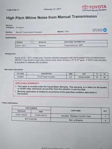

  18. Jun 29, 2017 at 9:47 PM
    #2398
