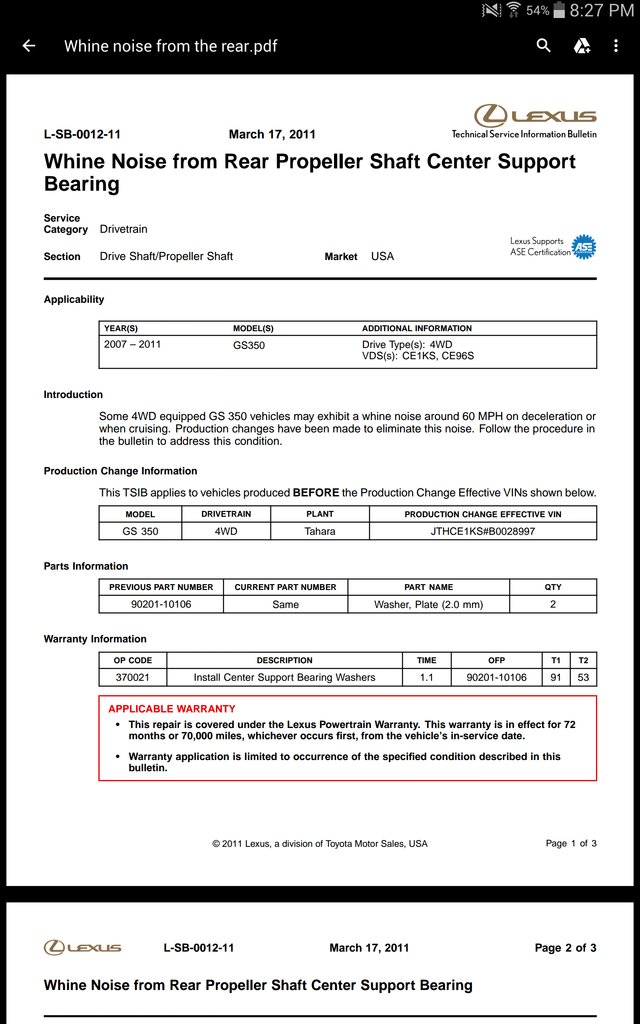

    Interesting. Was it a 400hz -450hz sounding howl? https://youtu.be/rXu61z8yiMc My guess is the angle is affecting the pinion bearing because several folks have had it isolated, on a lift, with a stethoscope to the diff.
    This jives with Smitty reporting a reduction in noise after his lift.

    The Lexus tsb added spacers which dropped the diff down to change the angle. They probably need to do that here. It might screw with their ground clearance numbers though.

    Do you have a link to the TSB? Pics? Is this easily done?
    If the spacers were not that expensive, I would be tempted to install them myself.

    Thought it was the carrier bearing

    Thats what I was thinking of. I guess it's not for the diff, so I'm not sure it's relevant. Our noise is clearly the differential.

    Those spacers are about a $1 each. Could be an easy test. Thing is though, would that 2mm be enough to correct the angle if that is what the issue isn't?

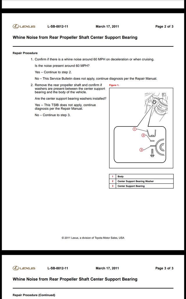

    Can someone post a parts diagram to confirm that our trucks are supposed to have those washers? Then we could check to see if the are actually there or not. I would check my truck but I don't know what's supposed to be there.

    I'be checked my truck and there are no spacers or washers.
    I looked a while back for parts diagrams and the only washers are on the head of the bolts.
