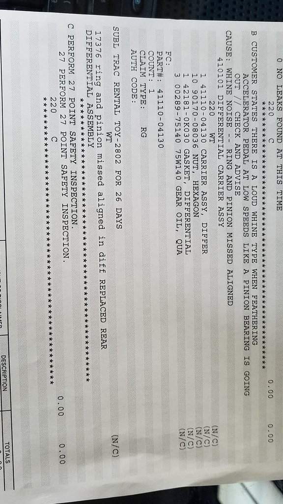

    My 2016 Tacoma SR5 purchased in April of 2016 experienced the same whine. I can not remember when I first began to notice it, but it became progressively worse as time went on. I also had the seepage. I first took the truck in for the recall in May of 2017 and they performed a torque of the nuts and sent me on my way. Late June I checked the differential again and noticed seepage. I took the Tacoma in again but to a different dealer. I showed the service mgr. the photos of the seepage and decided also to address the whine. Explaining to him that the whine was consistent with a problem with the ring and pinion. I asked to meet with the Master Tech and suggested that they put the Tacoma on a lift and listen for the whine. The tech did so and diagnosed the problem as the ring and pinion miss aligned in the rear differential assembly. They proceeded to order the rear differential assembly. They held the Tacoma until late July at which time they replaced the rear differential assembly. I am now 1400 miles into the new assembly and have no whine to report or seepage. I will continue to check and listen for any whine or seepage as others that have had their differential replaced have reported a return of the whine. Hopefully this one won't. I am not completely convinced there isn't an engineering problem or design issue with the rear end. We will see.

  6. Sep 14, 2017 at 11:07 AM
    #2946
    os11
    os11 Well-Known Member
    Apr 28, 2016
    #185536
    51
    2016 Tacoma SR5
    20170914_140334[1].jpg Sorry about the image being difficult to read from posted angle. Not sure as to why they decided to state on work order no leaks found at this time. There was seepage, but I was satisfied with the repair and the dealership was in my corner, so why rock the boat over some sentence. I had use of a 2017 Offroad for the entire time. Couldn't have received better service.

  7. Sep 14, 2017 at 11:10 AM
    #2947
    EMT760-
    EMT760- Well-Known Member
    Aug 16, 2017
    #227020
    401
    17 Tacoma TRD Offroad 4x4 DCLB
    Excellent! Anyway you could do the whole document? Showing the dealership name but just blur out your name, include vehicle information.
    The icing on the cake would be a pdf document.

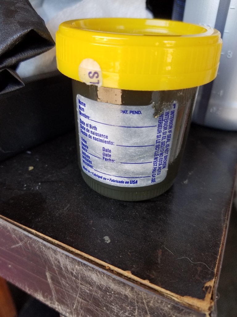

    EMT760-
    Aug 16, 2017
    #227020
    401
    Here's my fluid after 1200 miles from the rear diff. Black and cloudy.
  18. Sep 14, 2017 at 8:10 PM
    #2958
    Tacowin1013
    Tacowin1013 Well-Known Member
    Dec 20, 2016
    #205311
    2,628
    2017 OR DCSB 6MT MGM
    Is that...a urine specimen cup?!
    Riding Dirty likes this.
  19. Sep 14, 2017 at 8:17 PM
    #2959
    EMT760-
    Aug 16, 2017
    #227020
    401
    Yeah haha
