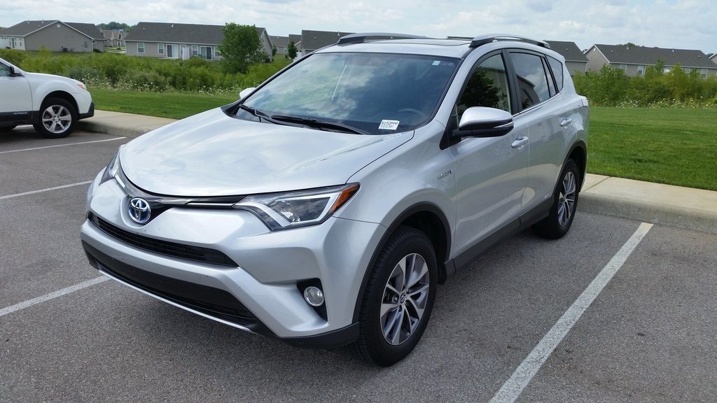

    Looks like I'll be in this bad boy for the next 24 hours or so :headbang:
    Hell yeah, it is a Hybrid!
    Field Engineer is looking at my truck tomorrow, and I will update you all with anything I hear!
