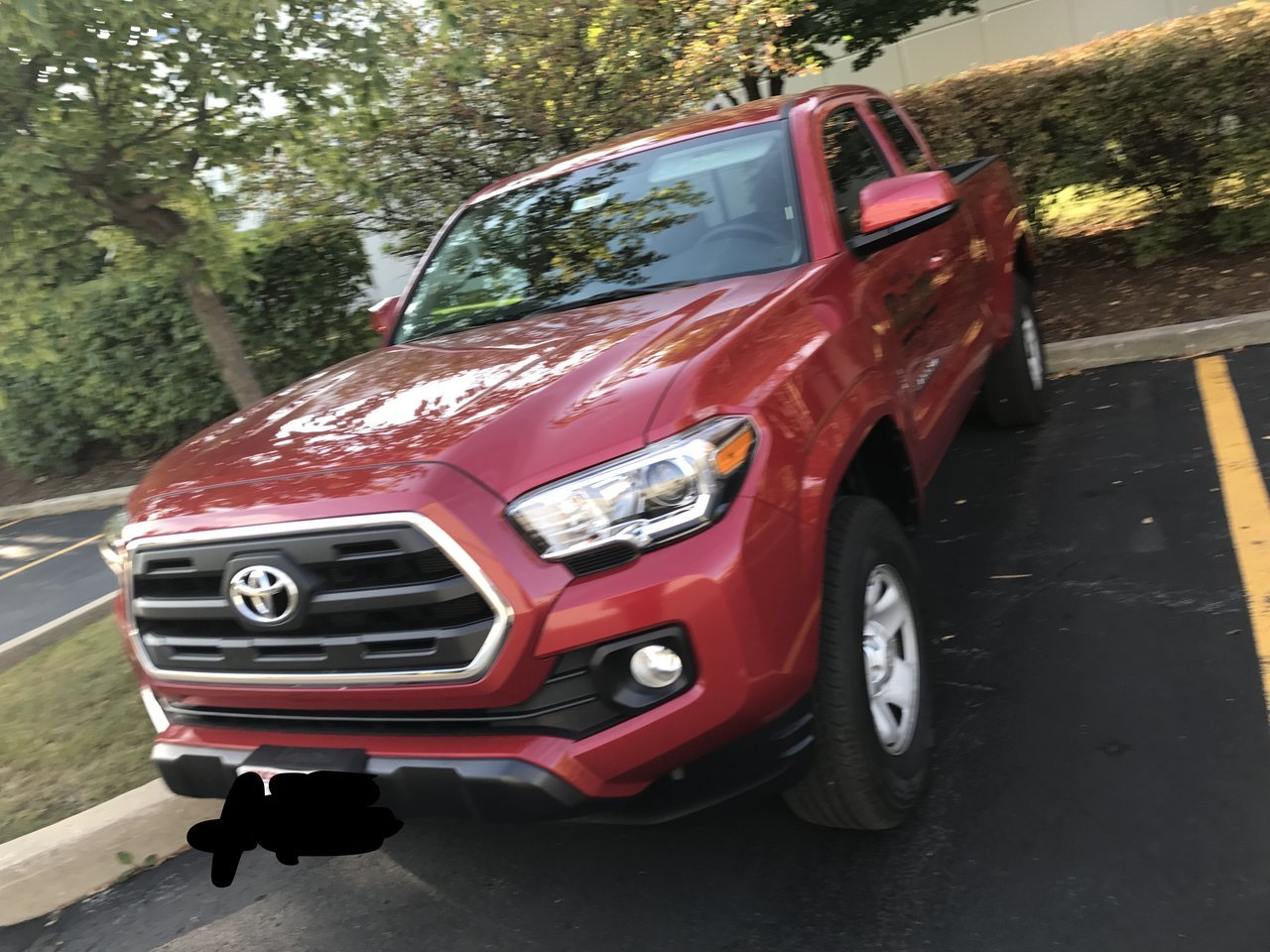

    I guess the 4cyl Sr5 is what I should of went with. My dealer has my truck hostage on a lift for 4 days in service. No work performed and everything on mine is still intact. They give me this sr5 . It makes zero noise at any speed . I tried repeatedly. 40-43-51-55 and zilch.
    The only thing I don't like about it is zero get up and go. Oh well . It beats paying for a rental when my truck is at the dealer under warranty. Driving the sr5 makes me miss my TRD Sport even more. Lol
    This sr5 has 3,681 miles
    I signed for the rental at 3,011
    IT MAKES ZERO NOISE!!!!

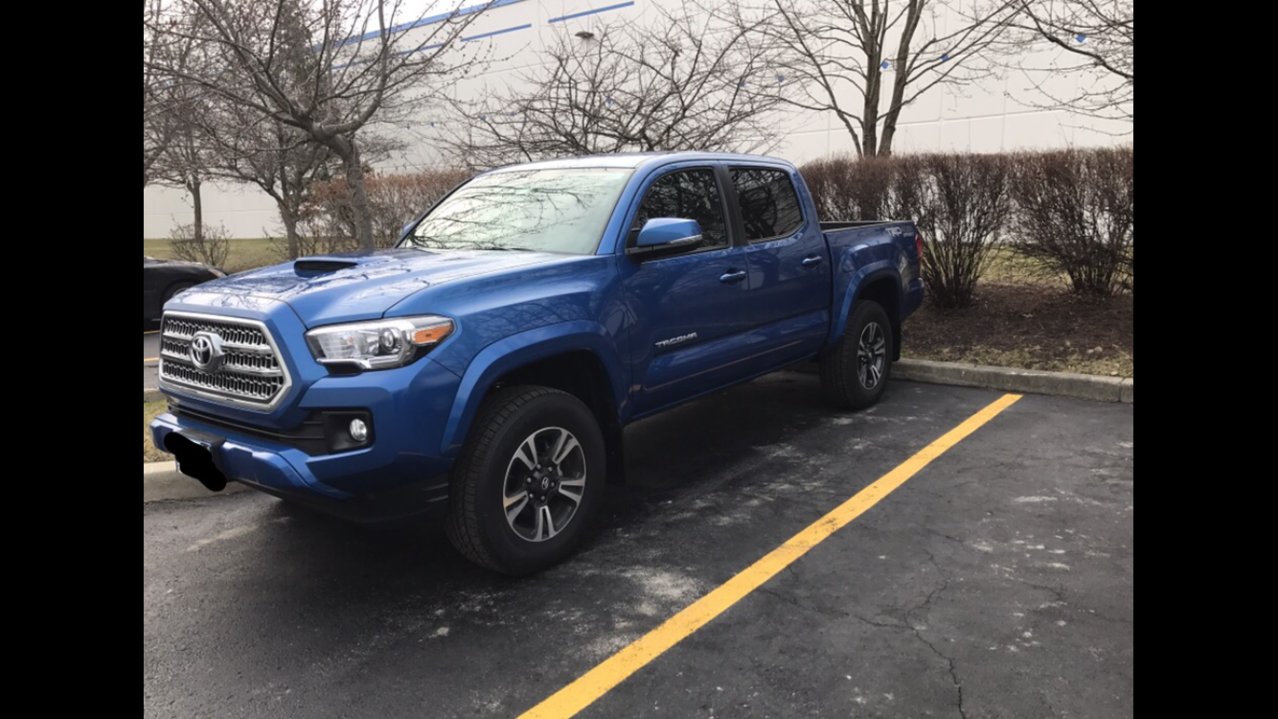

    IMG_6965.jpg All my coworkers ask ... where's that fancy Toyota you had

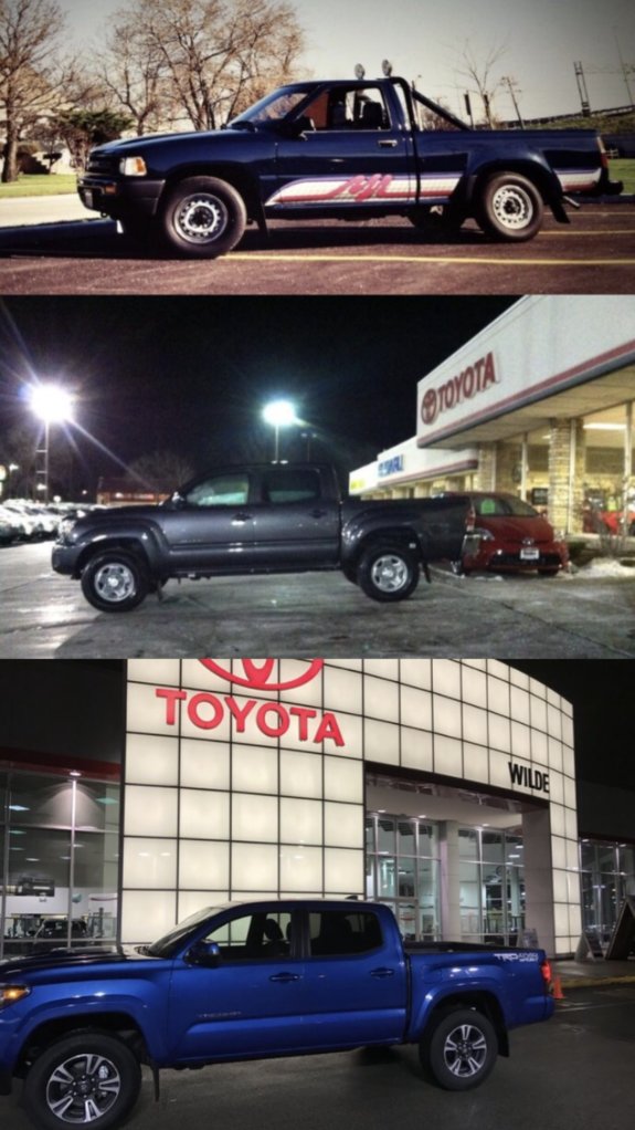

    Part of me regrets trading my 2015 prerunner in.. It was 2 wheel drive. Oh well my work vehicle is 2 wheel drive and they send me out all over Wisconsin,Minnesota,Iowa in blizzards! Lol
    I just got such a great deal on the 2017 TRD sport and equity in my 2015. I thought it would be stupid not to.
    I loved my 2015. It had the dash rattle. I went to the hardware store and got 4 ft of tube that you use for a fish tank airline . The tubing was smoke black. Just stuck in between windshield and the dash and bam!!!! No rattle. The 4.0 seemed meaner. Had the sweet growl at 90 mph down the interstate. Towed stuff like a champ. The fuel economy was about 20 on 2,000 mile trips.
    It's too late for me to look back now. I wanted the Trd sport in 2015 but my wife said $40 k for a little truck! Lol so I settled for the prerunner at $24,000
