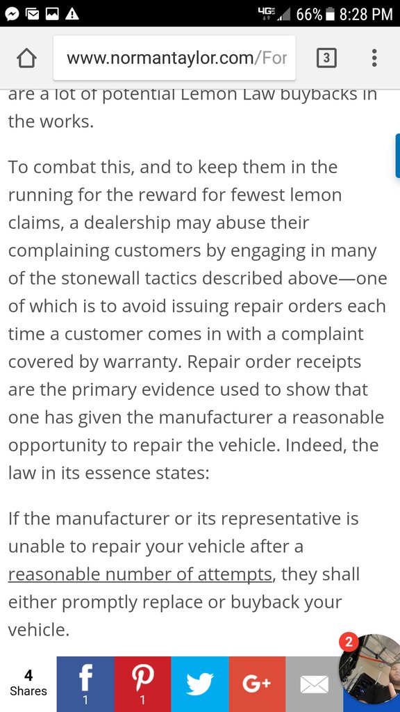

    See here. Don't mind my friend from facebook below.

    And again, if they refuse to issue a work order, literally take a selfie with them at the dealer and document when you were there. GM tried this on me and I took photos and sent emails following up over my “service visit”. If they refuse to issue a work order and refuse to help it could still be determined to be a failed attempt. I will say that I have not had a Toyota dealer try this with me yet and hope this is not the case. If it comes down to it that ECGS $800 solution looks tempting.

    I already got two lawyers interested in my case. The hard part is demonstrating my howl or whine from a cell phone video. I'll have to go in person.
