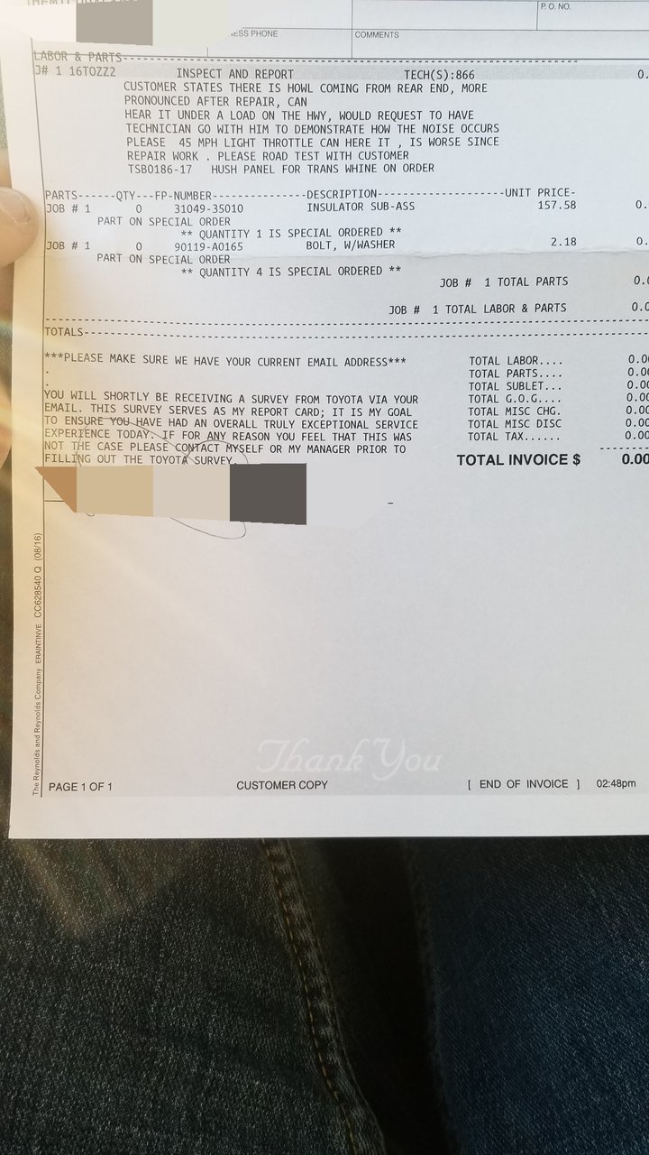

    Not that I need to, but I can confirm that as well. That fix is for a different sound but the way the TSB was written it makes the service people think it's the same sound.

    Totally agree I'm not aware of such noise associated with the 6spd itself. The rear end screams in this thing, my friend has the same truck in auto sounds the same. The pad insulates the noise...not fixing it.
