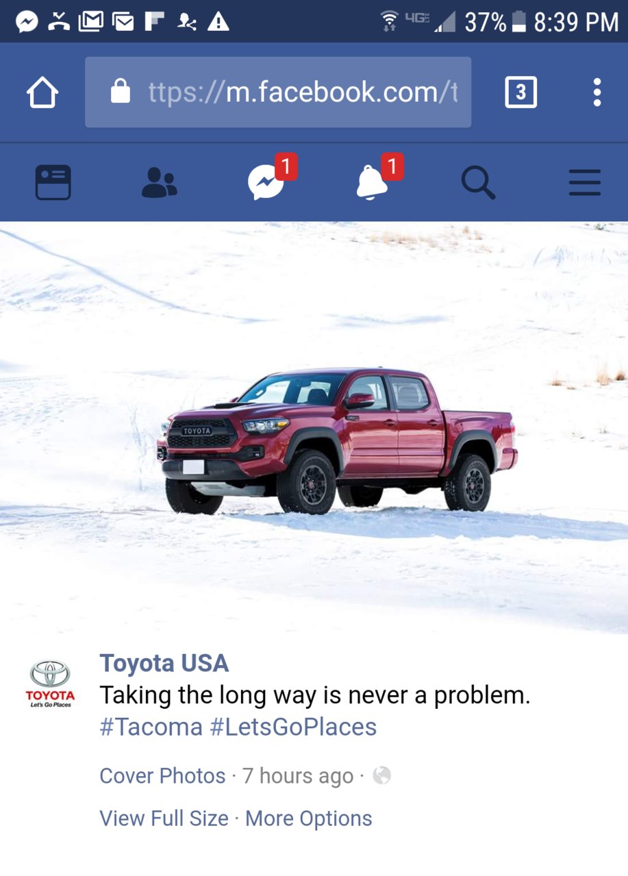

    EMT760- Well-Known Member
    Aug 16, 2017
    #227020
    401
    17 Tacoma TRD Offroad 4x4 DCLB

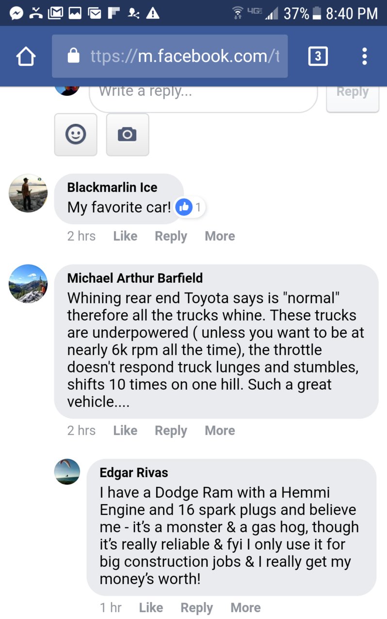

    smashed this, broke that, covered it up with tape and paint
    I've been tagging them on Instagram constantly and they're ignoring it haha
    EMT760-[QUOTED] likes this.
