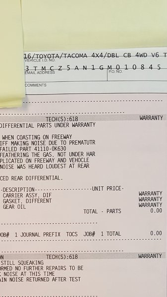

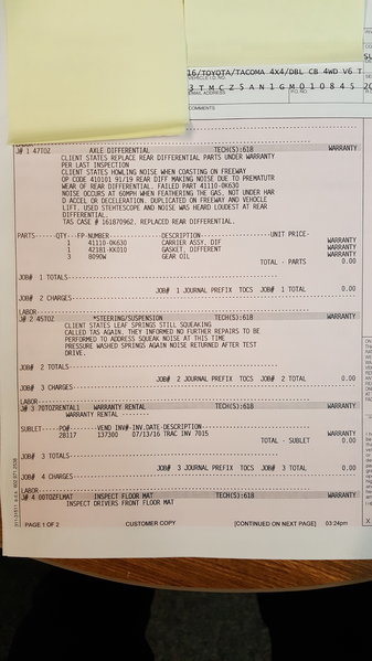

    Screenshot_20160717-104303.jpg 20160714_140247.jpg 20160714_140247.jpg 20160714_140247.jpg

    They replaced my rear diff trying to fix this problem. It wasn't fixed.
    I test drove a dozen trucks on the lot. The service manager had them lined up waiting for me to test drive them when I came it. He's the one that told me to feather the throttle to reproduce the noise.
    It happens on every.single.Tacoma. some were worse than other but it occurred on all of the ones I tested. The service manager, who is great, said he hadn't driven one that didn't have the issue.
