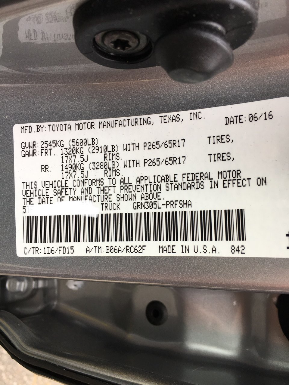

    Agree with this. My door jam references an 8” diff with a 3.91 gear ratio (B06A)...I have a 6MT TRDSport (8.75” diff and 4.30 ratio). Meaning everything about my diff code is wrong. Toyota has some f***ed up shit going on with their QC in that sense.
    I won’t be going in for service for a few more months but I hope they cover mine under the TSB as they should.

    Yeah. Took me all of 5 secs....bd22a and bd22an. There goes the tsb is a scam argument.....
