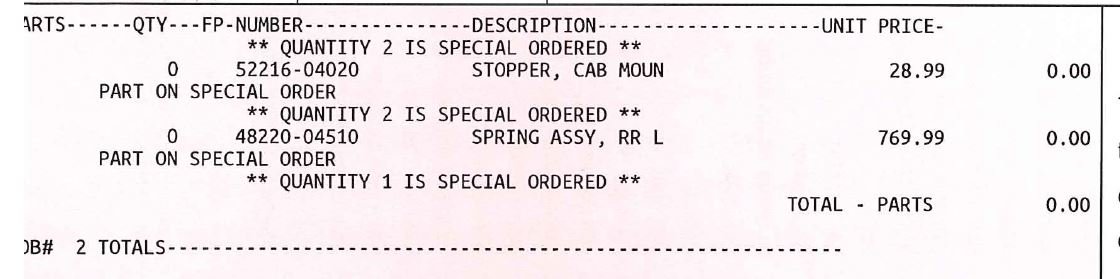

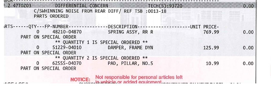

    I showed them the TSB last week when I went in for my 15k mile service, and they went ahead and placed an order for the parts without "re-diagnosing". Just got the call this morning that they are in, so I'm dropping it off Monday morning to have the work done - I'll update once I pick it up. I have to say, although annoying, it hasn't really been bothering me that much, I guess I have just learned to live with it. Glad to see they have finally acknowledged it though.
    Looks like it would not be a cheap fix if you were paying out of pocket.

    Yes and no, us long beds don't get the springs. Parts for me would only be $165.97. After reading through the TSB, it could be an easy DIY.
