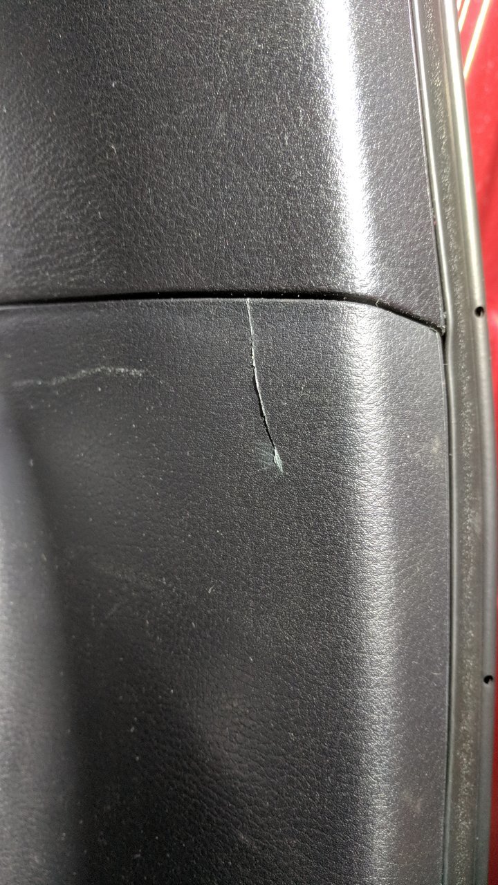

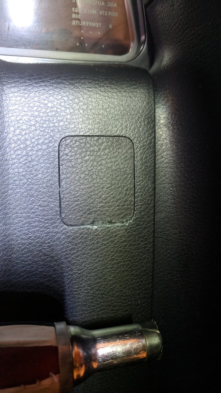

    Well, I took it for a ride this evening, i'd say it's about 90% better. I can still make it howl, but it's a much smaller speed range - 62-65 and way more quiet.
    I'm less than thrilled with the care that was taken with my truck, however. Looks like they got ham-fisted with the plastics. First pic is actually a crack, not just a scratch.

    Ouch... that stinks! Is the first picture the pillar next to the door? I’d take that back to the dealer as soon as you can. I’m glad your howl is better though!

    I would be taking that back for damage to the interior panels...

    It's an accesscab, so it's the pillar directly behind the suicide door.
    I texted pics to the service manager this evening. If he doesn't reply by tomorrow noon, i'll be giving him a call.

    Man, I hope they do the right thing and replace that piece! You would think the tech would have noticed that as he/she was finishing up..

    The Service Mgr texted me back, he said "when you get a chance stop in let us look at the rear seat damage and maybe i can replace under warranty"
    I'm planning on going by after work, and having a conversation with him.

    "maybe replace under warranty?" .Hell no, replace what you damaged free of charge! Unacceptable and frustrating man, I feel for ya
