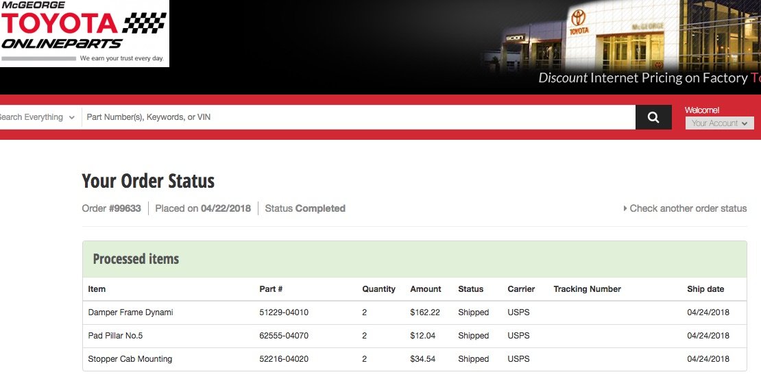

    Folks....I'm happy to announce that the whine is gone on my 2018 DCLB Sport after purchasing the tsb parts online (no leaf springs) and installing them myself. It's no exaggeration that it took me 30 mins which included scrounging up tools, crawling under the truck, and fumbling around. Total was about $225 shipped. The crazy thing is I ordered them late Sunday night and received them today!
    So....The Damper is new, the "stopper" doesn't look any different than the one I took out (pretty much a big washer), and the Pillar Pad is a 4"x8" piece of foam about that sits just about where the damper is under the cab. The pad can't possibly do anything to help?? Also, I just crammed it under the carpet where it goes....I did not dismantle all the stuff the TSB says too.
    Finally....I wouldn't have done this unless I had seen Casita2010's post about him purchasing the pieces from the dealer and the dealer putting them in for free! And then his whine was gone!! Thanks for posting.
    Here's the Toyota Dealership got them from: https://toyotaparts.mcgeorgetoyota.com/ Just put in the TSB part numbers you want and order away. Hope this helps some of you with trucks that aren't covered by the tsb and are willing to give it a go on your own.
    Parts info below:

    Nice!! Glad it worked!! My pad pillar was rubber strips. A Toyota tech on here said that’s what the pad pillar is. Now I’m confused on why different parts have the same part number haha I still need to get the damper ordered. Been hoping the dealer will do it for me ha

    Rotekk: It’s easy to look at the rear cab mount and see the new damper. Someone sent in a pic a few pages back. Mine didn’t require leaf springs. I replaced the large washer and put in the small foam pad but suspect these don’t affect the end result?....it’s the damper that is new

    Here's the post with pic. I was curious what I just ordered lol
