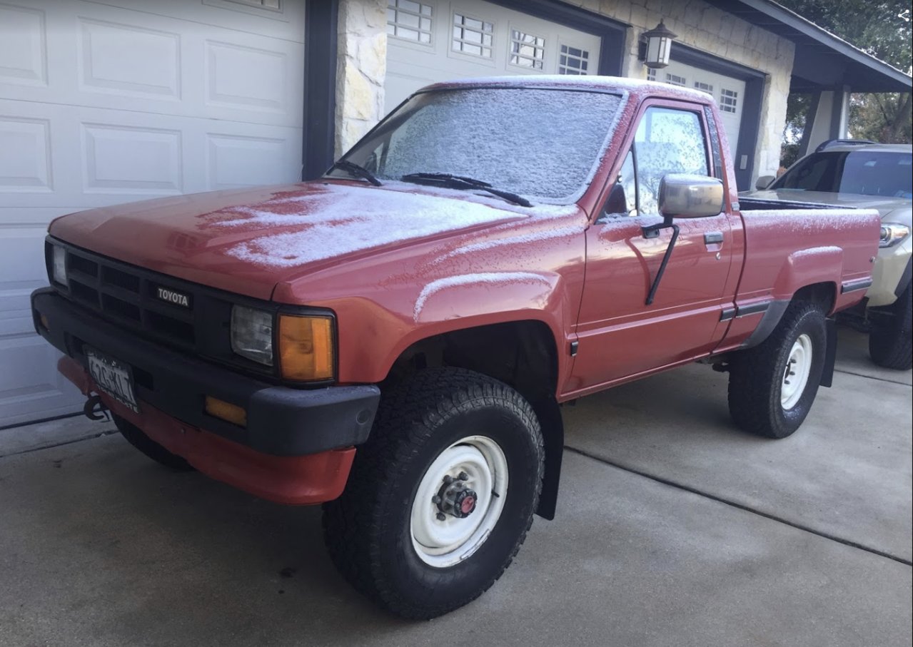

    I would describe it as loud enough that a car guy might notice, but not too bad. I've been driving 4x4 trucks for over 30 years so they're all Cadillacs to me compared to what I grew up on. Anyone crying about this being a loud truck needs to drive my other truck for a day. :)

    Just wanted to say I like your other Truck.
    hookembevo[QUOTED] likes this.
