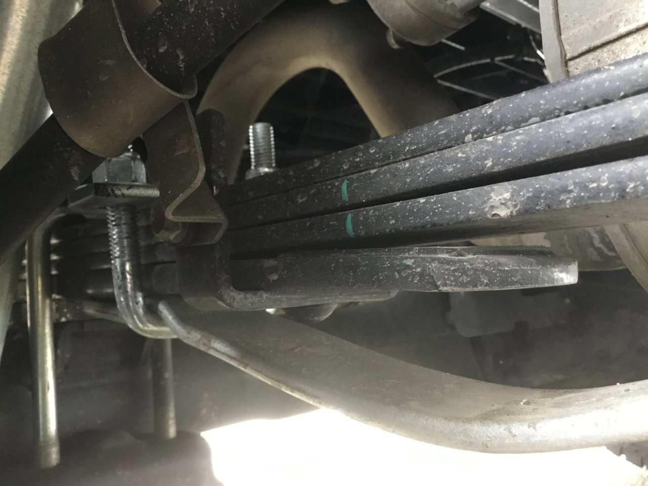

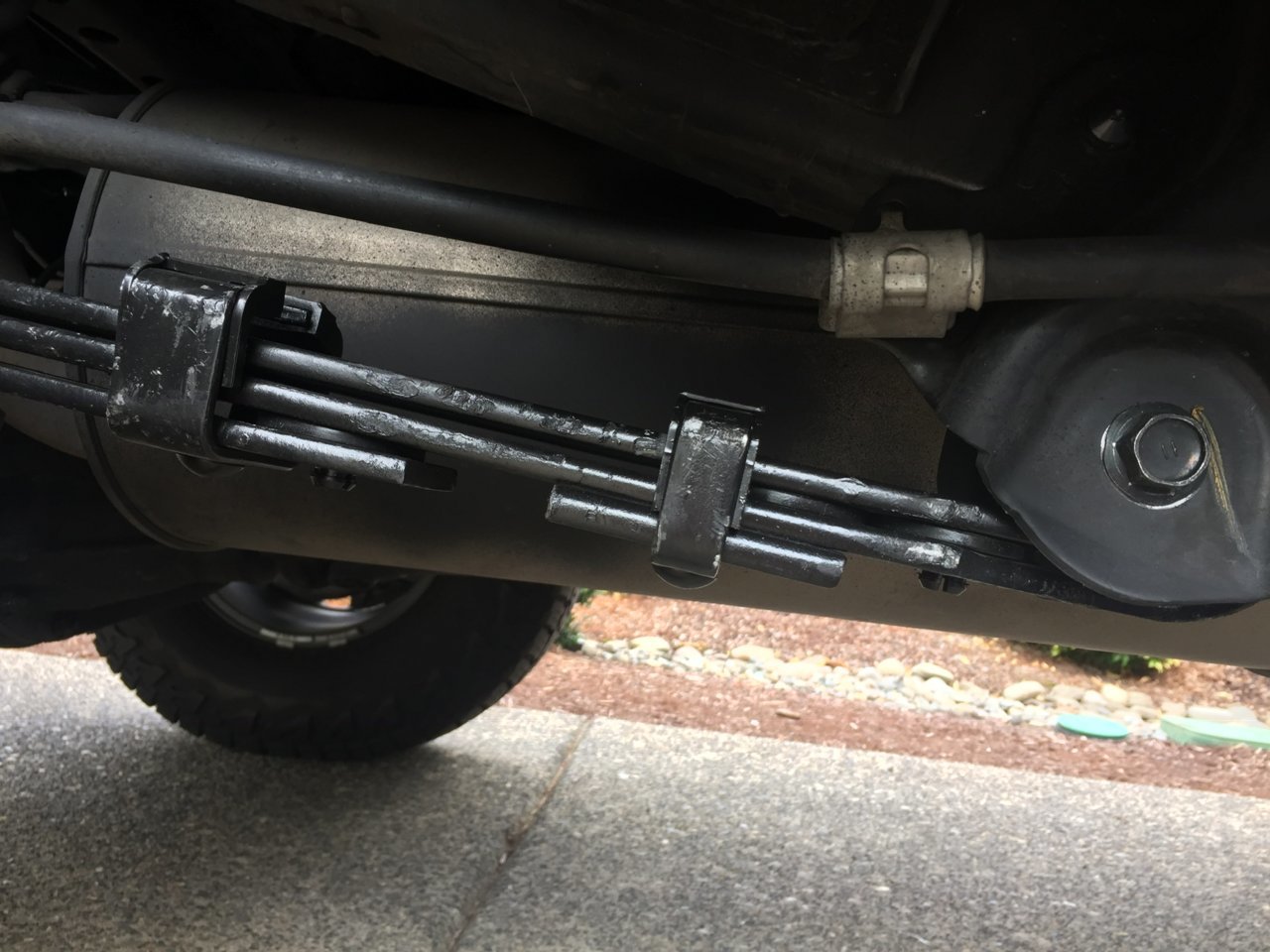

    On the first visit to my local Toyota dealership with 6,200 miles on the odometer I told them that my truck was howling at 50 to 60 mph and that the rear differential was also leaking.
    They replaced the rear leaf springs, installed dampers and replaced the rear differential gasket.
    The howling is gone....at least for now.
    An attempt to get rid of the howling noise/resonance with a clamp and cheap overload helpers on the leafs didn’t help:
    New rear leaf springs have an additional short section of leaf at bottom toward the front.
    95B685A3-3793-4FC9-8F05-1D1EEE23C474.jpg D597E2FB-7857-477E-B8B9-6BA2B712036D.jpg FA5A5249-16DF-4535-B382-EC006FCBC321.jpg

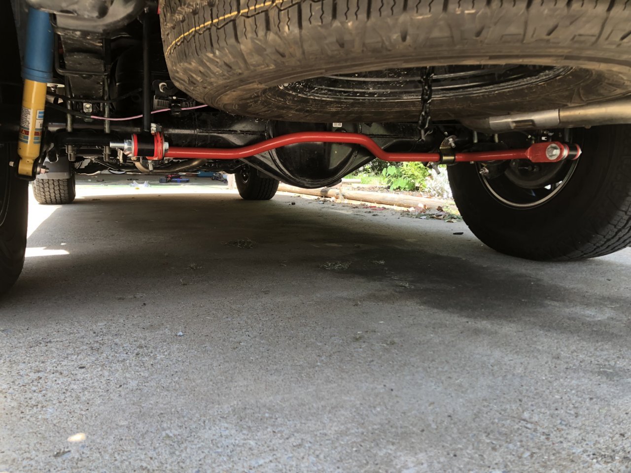

    I installed an Xrunner rear sway bar on my 2018 OR with 6Mt and the whining almost disappeared. I figure the sway bar acts as a dampener on the vibrations somehow.
    The X-runner sway bar is NOT bolt on. However you can get a Hellwig on that is bolt on.
