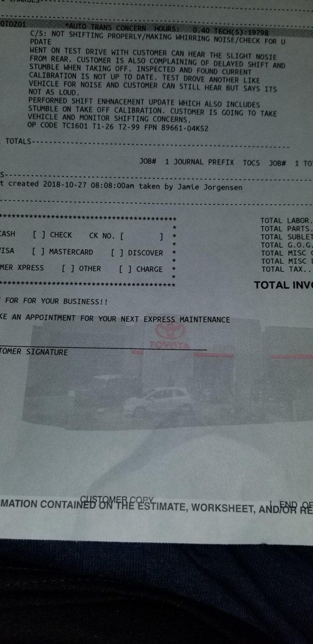

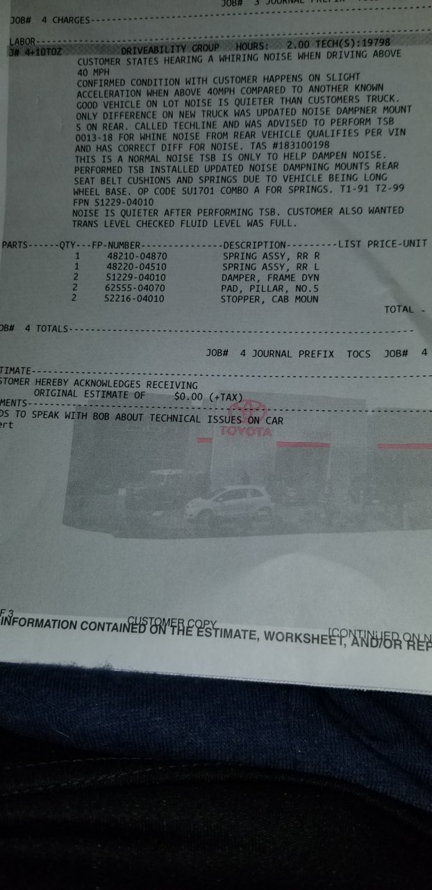

  20. Nov 23, 2018 at 6:07 PM
    #4920
    federal taco
    federal taco 2019 trd pro midnight black
    Nov 10, 2018
    #272232
    24
    jay
    Wa
    2019 Trd pro midnight black
    2019 TRD PRO 2017 TRD OFFROAD 2008 T4R
    15430248694613715293964662603314.jpg 1543024892259168049164474609110.jpg Did last week
