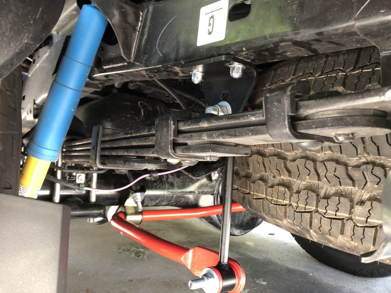

  11. Dec 8, 2018 at 11:43 PM
    #4971
    OpelGT
    OpelGT hOPELess Power
    May 6, 2018
    #252678
    558
    Texas
    2018 TRD OR Tacoma MT, Magnuson Supercharged
    I posted several months ago that the addition of a rear sway bar eliminated the howling on my Tacoma. I think the bar acts as a damper on the rear axle tubes, so less vibration is translated from the springs to the body. I haven’t noticed it since.
    For those of you that don’t need full articulation of the rear suspension it’s a great option.
    My truck spends most of its time on curvy roads or highway, so the rear sway bar has been an awesome upgrade. The handling improvement is night and day.
    My off-roading is in flat sandy areas so the sway bar has no negatives for me.
    I think the only bolt on option is the Hellwig bar. It requires drilling like 2 holes (seriously no big deal 5 seconds tops).
    I used an X runner bar, but it was a nightmare to install.
    TD90S, barcelona7568 and nDub like this.
  12. Dec 9, 2018 at 11:22 AM
    #4972
    barcelona7568
    barcelona7568 Well-Known Member
    Jun 3, 2016
    #188665
    618
    CO
    16 DCLB, Stock
    Good to hear, thanks for the report.

  15. Dec 9, 2018 at 12:49 PM
    #4975
    OpelGT
    May 6, 2018
    #252678
    558
    Texas
    I did somewhere previous in this thread. The X-runner bar is not designed for a 4 wheel drive pickup with a full size spare. The spring perches need to be filed down some, the exhaust needed to be slightly moved and the hangers filed down for clearance. It takes a very long time and lots of measuring to get a good 90° geometry while maintaining clearances and the spare tire.
    The hellwig bar will bolt right on. Just get it. I only did xrunner because I plan on doing the x runner cross bracing and other handling stuff later. Also nobody had used that bar on a 3rd gen yet that I know of.
    NoOne[QUOTED] likes this.
