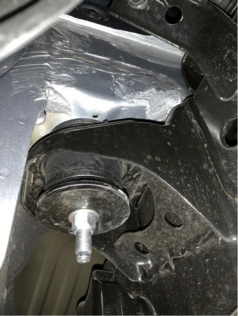

    These are the rear cab mounts on my '19. Are these the dynamic/acoustic ones?

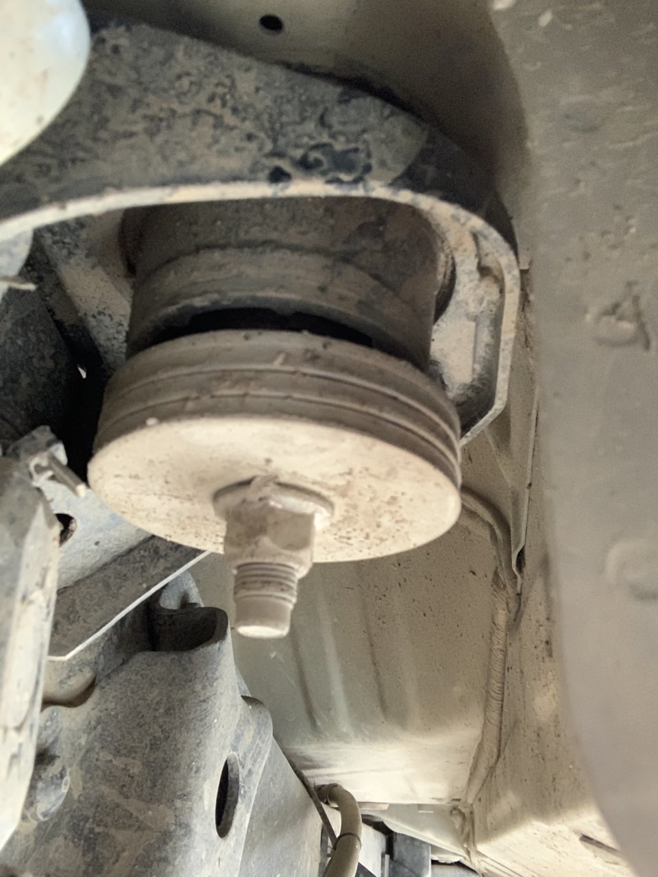

    this is what my 19 looks like, which allegedly had the fix but still makes tons of noise
  9. Nov 7, 2019 at 5:20 AM
    #5189
    ryan760
    ryan760 Well-Known Member
    May 26, 2019
    #294438
    1,510
    huh, yours looks different for sure. That's strange. Did you take it in for the TSB?

    Took it in multiple times, no one would touch it, ended up getting corporate involved, got an engineer to look at it, and was informed my (very loud) noise is normal - and that the TSB has been implemented at the factory line, mine was already done

    Well wtf then Toyota. Why are our cab mounts different? :rofl:

    Could be yours was built before they implemented the fix
    that or typical Toyota quality control
