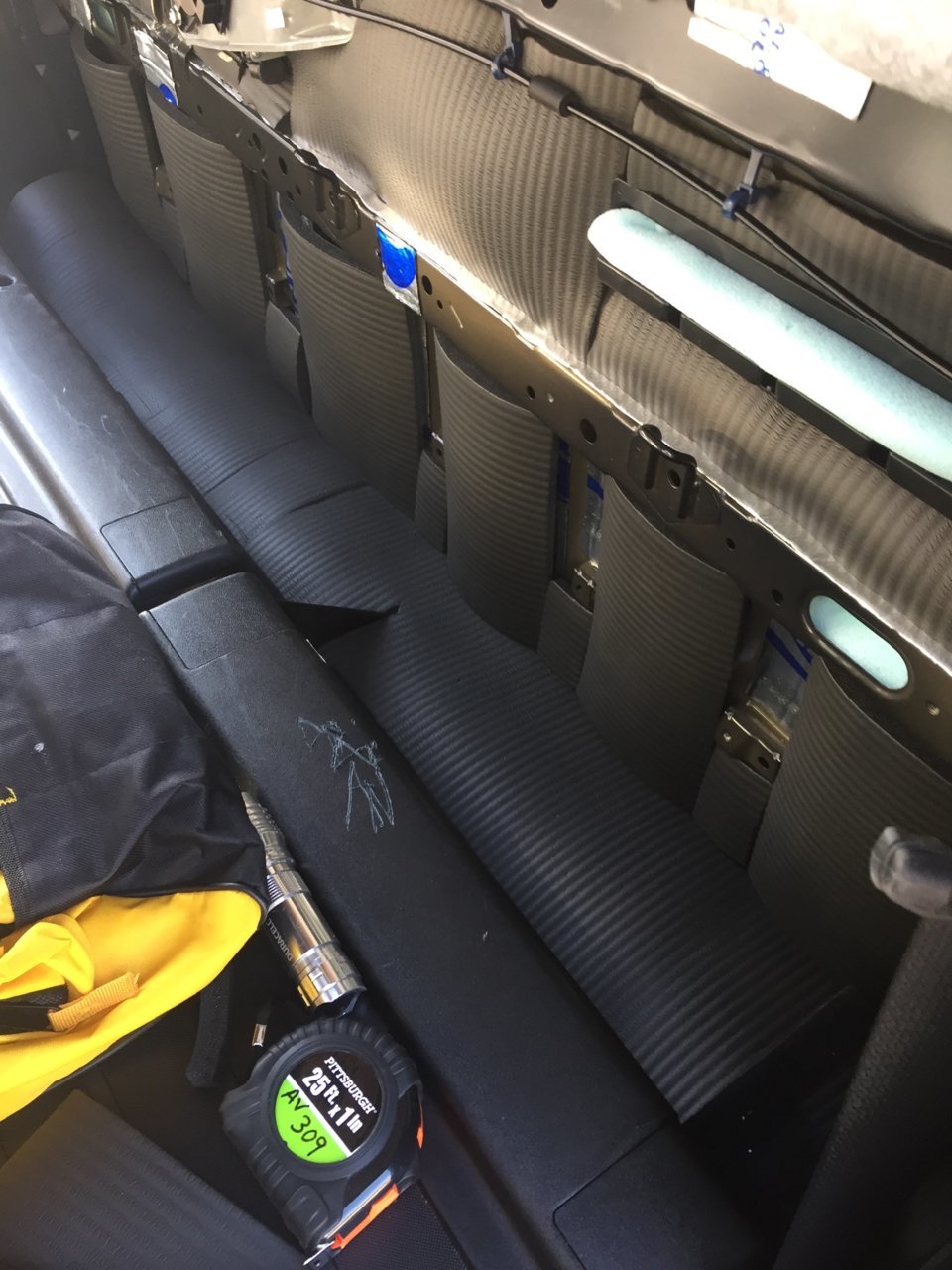

    Many home HVAC compressors have a two layer foam/vinyl jacket or cover for noise reduction.
    There’s a TW member that makes custom fitted upholstery pieces for the Tacoma interior.
    If we could just get him to make a triple layer-dynamat, foam, MLV- jacket to completely cover the rear dif.
    I’ve thought about wrapping the pumpkin in multiple layers of different materials and duct tape just to see if it would make a difference.
    I used soft/thick exercise mat over Boom Mat applied to rear wall. That helped to quiet it down a little.
    Also placed pipe insulation outside between cab and bed.
    Toyota replaced my rear springs and cab isolators at 3,000 miles from new. That helped a bit also.
