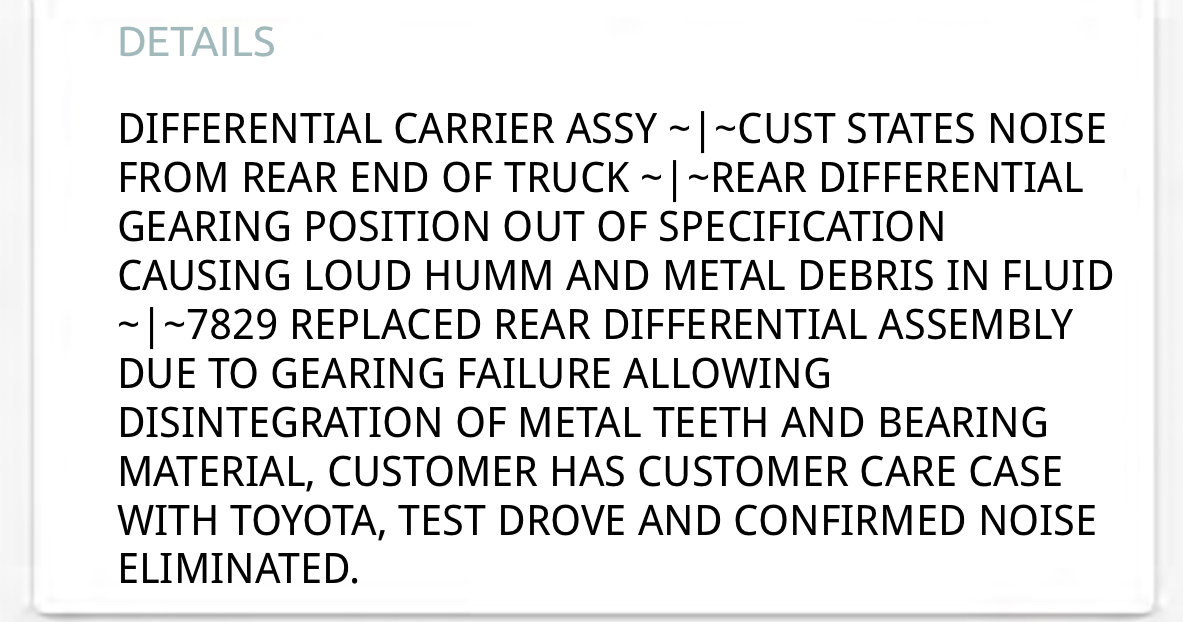

    Just checked my owners app, the service notes just updated for my 2020 diff replacement.

    This was exactly what I was told but my report was more vague. Basically I was told the same thing but the report was very watered down. I hope this works out for you. Best of luck.

    Ugh, that's not good.
    Please keep us updated if the noise returns :cheers:

    The details from my second differential said something along the lines of “excessive play in ring & pinion causing whine between 50 and 60 mph” ..... bla bla bla, they have all whined. I think they have to put something to justify the work, even if its BS.
