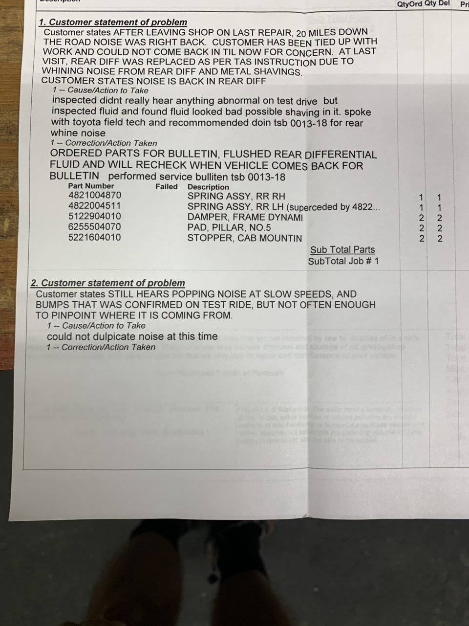

    Had my rear diff replaced at 3,800 miles as y’all know that stayed quiet for about 30 miles. Went in last week to discuss with the service mgr and the regional mgr. we decided to preform the TSB that replaces the leaf springs, body mounts and other things. Took the truck in yesterday and picked it up earlier today. The whining between 50-60mph is 90% better. Wasn’t expecting this to help as much as it does. So I’m satisfied with the fix.

    Differential replaced once, but whine is just as loud as before. My dealership won’t do anything unless I bring in something to verify acknowledgment by Toyota that further action can be done to reduce the noise. You by chance didn’t get anything that verifies the issue on 2019 ORs did you? Maybe an update TSB number?
    I would prefer explore this option before tearing the backseats out and putting Nioco on the cab wall with a likely marginal effect, if any.
    before they replaced the differential they tried to say my bed cover was causing the whine noise... so this tells me they will find any excuse to ignore it.

    5F97A8B2-3394-4817-BBBB-BC637E45B2B2.jpg Hope this helps
