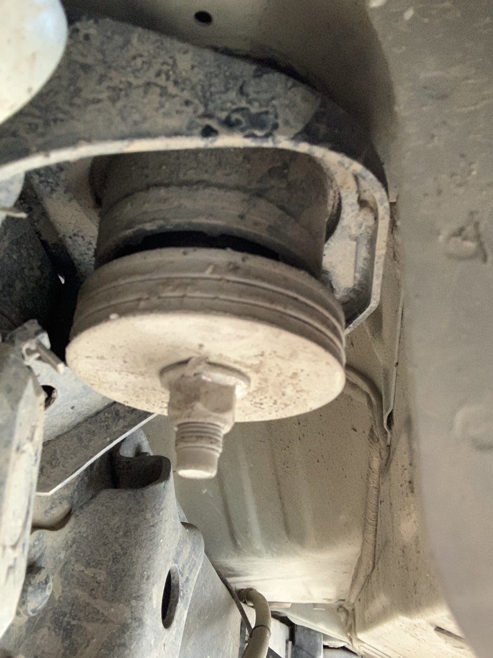

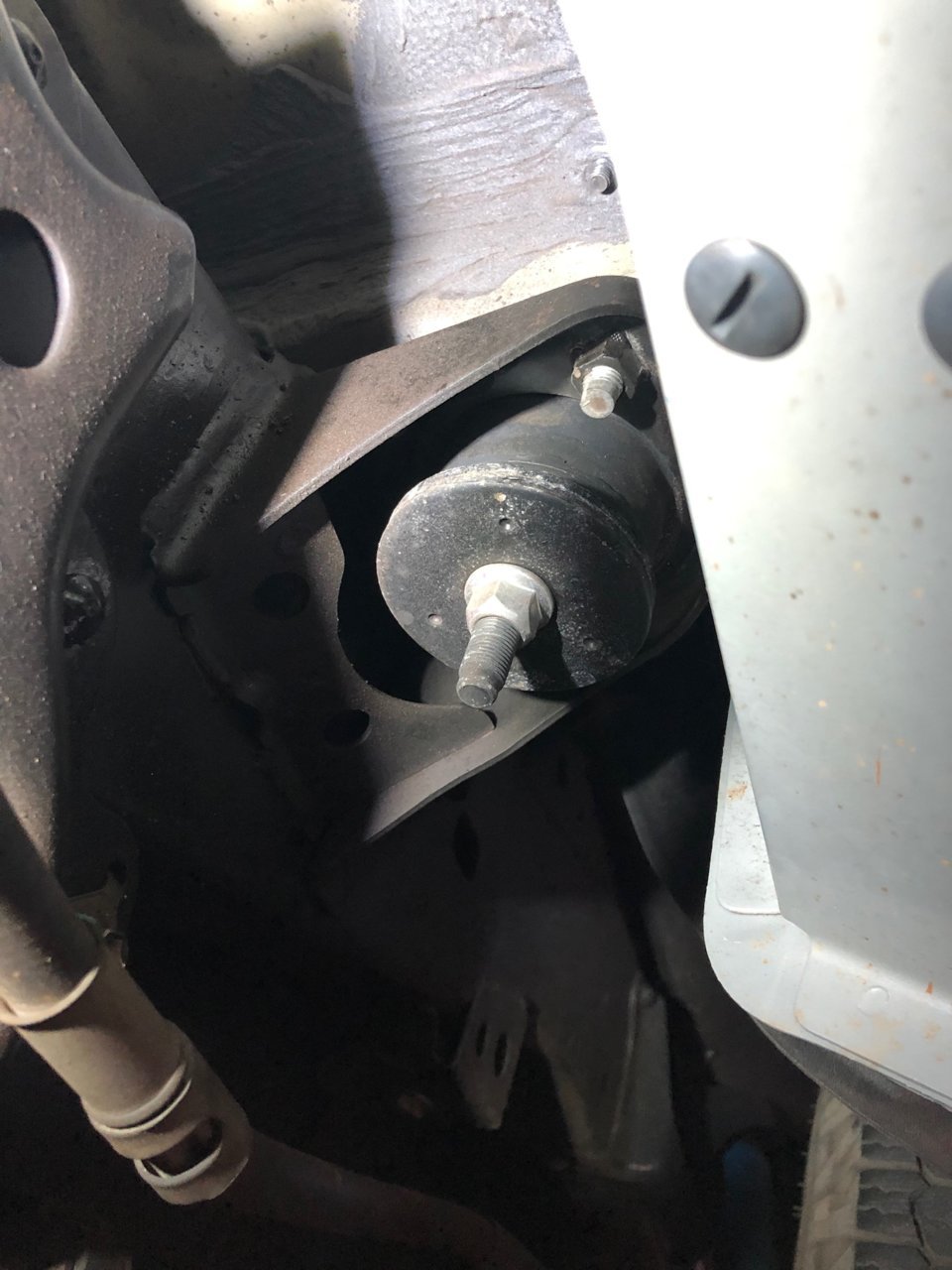

    Pic of your cab mount?

    Back cab mount on driver side
    CygnusX191 likes this.

    Yeah mine has like 4 gold washers on it. Would send a pic but she’s terminally ill in the body shop

    That's what mine looks like too.

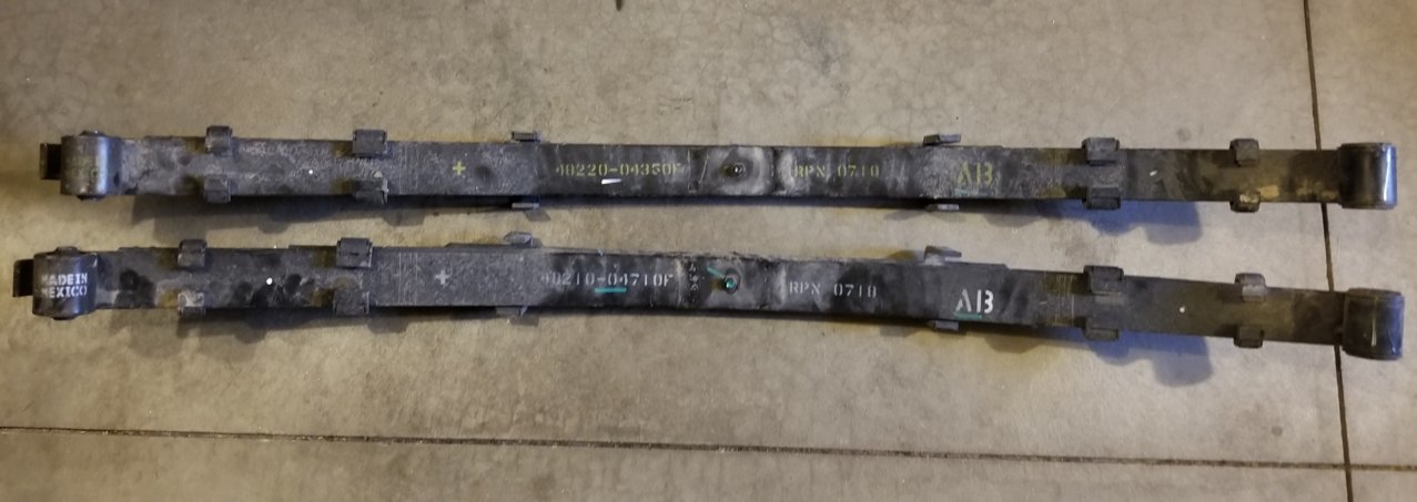

    Depending on the age of your truck, I believe the part number is spray painted on one of the leafs. Cant remember if it is the leaf facing the bed or the ground. Like this example: [​IMG]
  18. Feb 20, 2020 at 10:03 AM
    #5698
    ryan760
    ryan760 Well-Known Member
    May 26, 2019
    #294438
    1,510
    So yeah, the springs in your pic look like the old springs according to the TSB
    MT, all models except Pro:
    48210-04710 (old) 48210-04600 (new) Spring Assy, Rear RH
    48220-04350 (old) 48220-04240 (new) Spring Assy, Rear LH
    MT, TRD Pro:
    48210-04810 (old) 48210-04850 (new) Spring Assy, Rear RH
    48220-04450 (old) 48220-04490 (new) Spring Assy, Rear LH
    AT, TRD Off-road, TRD Pro:
    48210-04840 (old) 48210-04870 (new) Spring Assy, Rear RH
    48220-04480 (old) 48220-04510 (new) Spring Assy, Rear LH

    These are the drivers side springs on mine. Look to be the newer TSB ones. So I don't have the TSB cab mount dampers, but do have the new springs. o_O
