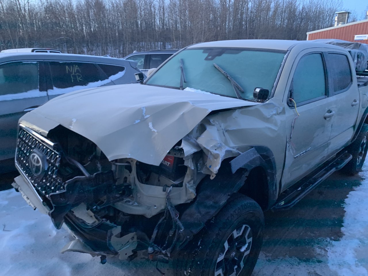

    Idk, i actually drove mine off a cliff and they’re still fixing it — damn high resale!!
